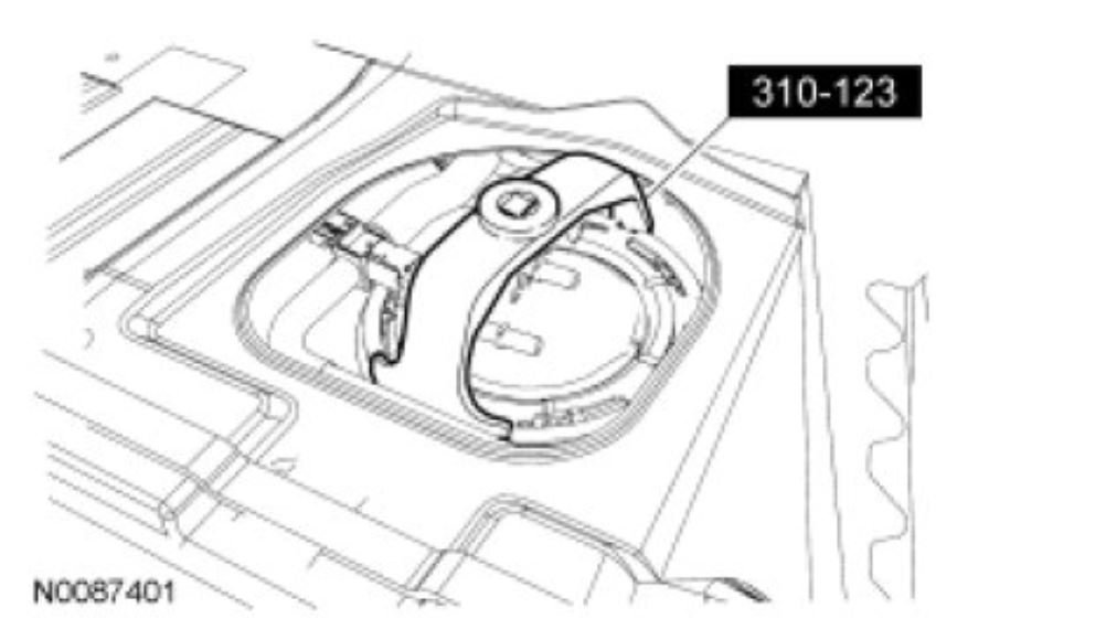

For the past three months I have had trouble starting my vehicle and it seems to crank forever before actually starting. If I turn the key to "on" position for a few seconds then try to start it, it will start right up. But if I do not do this it will crank for about five seconds before it will start. I have had the spark plugs replaced, and the battery and alternator are fine. There was a recall for a fuel module part and I got it replaced. I have had it both at the Ford dealership and an independent mechanic, and neither have been able to fix it. It is also a little sluggish in accelerating and does not seem to have the power it used to. Any suggestions?
Nov 5, 2018 at 9:51 AM
Good afternoon.
It sounds like the fuel pump is losing pressure overnight from a failed check valve. That is supposed to retain pressure for startup.
I would check the fuel pressure in the morning when it has sat overnight.
and
https://www.2carpros.com/articles/engine-cranks-excessively-before-starting
Check out the diagrams (Below). Please let us know what you find. We are interested to see what it is.

Dealer tech here. What has happened in several dealers is that techs were using wire cutters to crimp the new clamp when replacing the fuel delivery module plastic housing. We have had to purchase the proper crimpers to ensure a proper crimp so that pressure does not release from the fuel line from an improper crimp. We have had to re-do dozens of them with this mistake and the symptom matches yours to a t.
Nov 5, 2018 at 5:23 PM
WILLOWWREN
  • 8 POSTS
Yes, there was a supplement to the fuel delivery module recall stating that long cranks and hard starts after replacing the fuel delivery module could be due to improper installation of the clamp. I took my Escape in once I became aware of the supplemental recall and they supposedly fixed it. It did not take care of the problem though.
Nov 6, 2018 at 1:23 AM
That was good information.
Back to the fuel pressure test when cold. Are you able to do this check?
Nov 6, 2018 at 3:12 AM
WILLOWWREN
  • 8 POSTS
I have not yet. I do not have a fuel pressure gauge so I guess will need to get one.
Nov 8, 2018 at 5:23 AM
You can rent one from a parts store. Comes with instructions on how to attach it.
Nov 8, 2018 at 5:53 AM

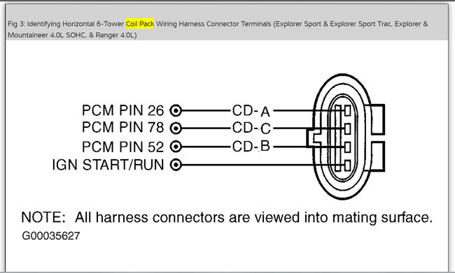

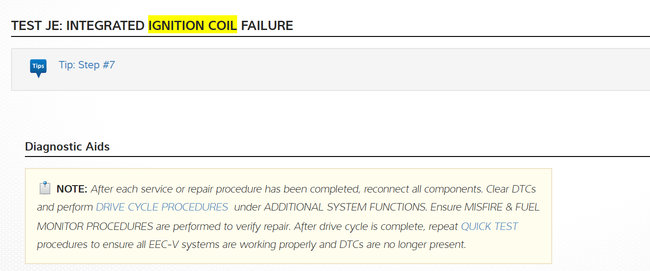

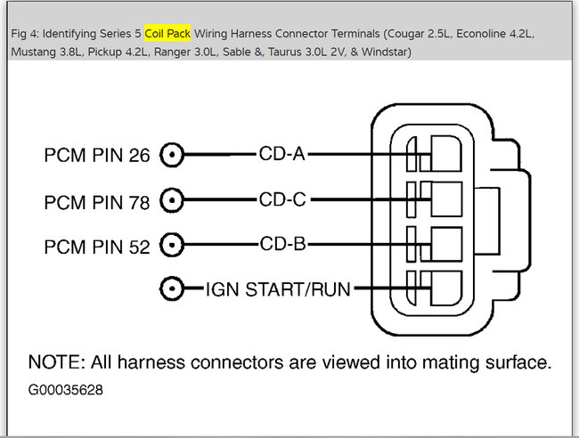

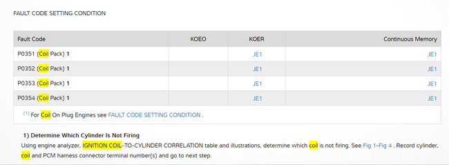

Started with a little miss at start up and idle. Intended to just replace all coils, plugs, fuel filter. Didn't have enough for coils so only changed plugs. Checked plug gap. Ran worse when I finished. I noticed recently that there are only four wires running through the harness to the front three coils maybe 10" before reaching them. there are two wires spliced to one of the four at harness. Is it possible someone replaced wiring harness with a harness from a four cylinder engine and if so, what would be noticeable problems? The coil connectors are two terminal.
Dec 11, 2020 at 12:03 PM (Merged)
GDILGER26
  • 7 POSTS
I failed to mention I found some bare wires and made sure nothing could touch and short out. I have replaced two coils that appeared to be bad. One which must've gotten hot because the spring that contacts the plug was recessed too far in insulator boot to even reach the plug and the other had a tear in the boot which could possibly cause it to arch out. Also removed fuel rail replaced o rings on the injectors that were worn or damaged. If I somehow caused bare wires to touch when I removed the coils to replace the plugs, would that blow a fuse or relay or would it damage the PCM?

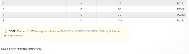

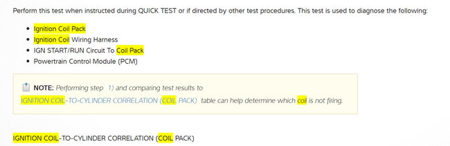

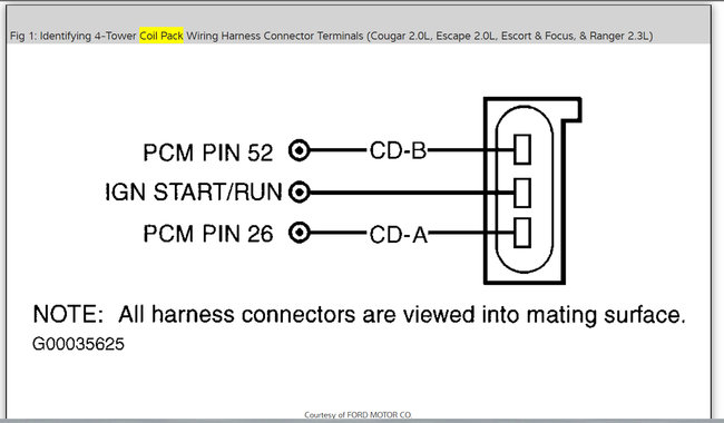

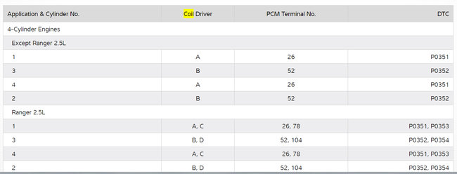

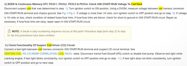

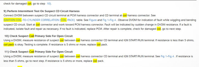

SCGRANTURISMO
  • 4,897 POSTS
The PCM circuit is definitely fused, so if there was a short to ground in the circuit, the fuse would blow, not the PCM. This could for sure be an ignition issue going on. Quick question, first though, is your MIL/"Check Engine" on? Please get back to us with what you find out and we can go from there.
Thanks,
Alex
2CarPros

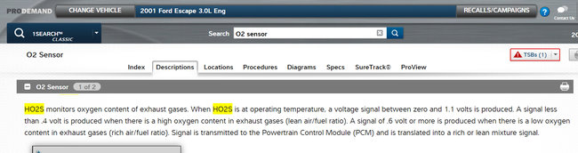

GDILGER26
  • 7 POSTS

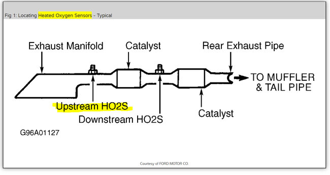

Yes, the check engine light has been on. I had it hooked up to a scanner at O'Reilly's and it showed that a front bank O2 sensor was bad on one side and a rear bank on the other and the cam sensor. I have changed the cam sensor, but not the O2 sensors. They could be bad, but there's another deeper root cause that's still an issue. A while back one morning it started with a small miss. I figured it needed a tune up so I was going to change the plugs and coils. I didn't have the $200.00 some for the set of coils so I just went ahead and changed just the plugs and that's when it all started I rechecked the gaps, taped up some bare spots I found in the wiring at the coil connectors, I forgot to mention when I changed the plugs I noticed the spring in one of the coils was recessed too far in the boot to even reach the plug. I was sure that was bad and the issue and a week or so later when I could afford one, I replaced it. Still missed a little but drive able. After a week or two maybe, it gradually got worse and started to backfire under the hood here and there, lagging on acceleration, hard to start. About two weeks ago it blew the plug out of the #4 cylinder and broke the coil. I'd like to think this wasn't due to an error of mine when I changed them cause I've been working on cars for years now and this has never happened. I had to use one of them kits that you tap it out and install an insert for the threads that the plug will go in. I'm pretty sure that part of the issue is fixed. Then, last week I wondered if I was looking in the wrong area so I removed the fuel rail and inspected the injectors, replaced the o-rings that were damaged, I have a fuel filter but weather has not been cooperating.
SCGRANTURISMO
  • 4,897 POSTS
Hello again,
The upstream O2 sensors are critical to the driveability of your vehicle. Your vehicles Powertrain Control Module(PCM) a.k.a. "computer" uses the upstream O2 sensor's input to determine the air;fuel:ratio, trying to keep it at or around 14.7:1, that it absolutely critical for a proper running engine. The downstream O2 sensor is used to make sure that your vehicles's catalytic converter is working properly. I have included some information for you in the diagrams below, but I would replace the upstream O2 sensor and get back to us with the results.
Thanks,
Alex
2CarPros
GDILGER26
  • 7 POSTS
Yes, I do agree that the symptoms before I even tried any kind of repair or tune up cold have been a faulty O2 sensor. I wish I'd had it scanned before I did anything. After I had already tried the plugs and coils, then I had it scanned and wish I'd done that first. I think there's more issues now than just the o2 sensors. I noticed when I was tracing for bare wires in the harness, there are only four wires running to the front, but three coils that are two terminal connectors. Then at about the first coil towards the harness there are two wires spliced into one of the four and one runs to the center (#4) and the other to the right (6). Is that correct? I wondered if someone may have replaced the harness using one from a four cylinder engine then did that to make it work, if nothing else, just to sell it.

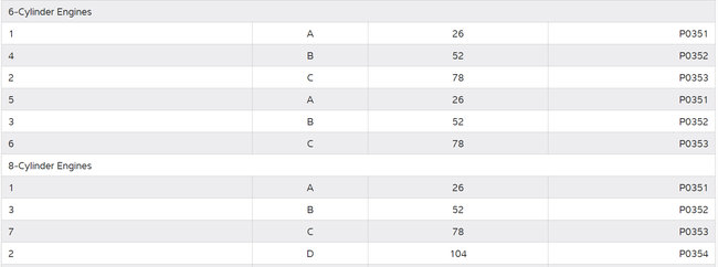

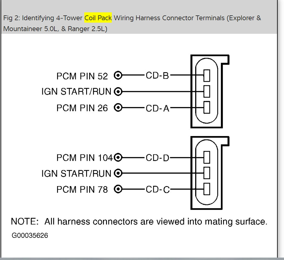

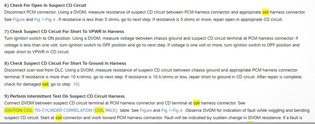

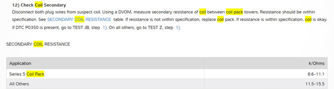

SCGRANTURISMO
  • 4,897 POSTS
Hello again,
Here is the information that you requested in the diagrams below. Please go through it and get back to us with what you find out.
Thanks,
Alex
2CarPros
GDILGER26
  • 7 POSTS
Thanks. I think before I start with these I need to eliminate other, cheaper possibilities. I did not change the plenum or intake gaskets when I did the plugs. I don't believe there to be a vacuum leak, but if the scan tool shows lean and O2 sensor, but no misfire I guess I should double check all possibilities. I did check for a vacuum leak once, but was leaning more towards it being a firing issue since it started basically after the plugs were changed. Thank you. The images you attached will come in handy.
SCGRANTURISMO
  • 4,897 POSTS
Hello again,
A good way to test for a intake leak is to do it with a propane torch. Please use caution when doing this. I feel confident explaining this to you as this is how North American Honda taught me how to do it in their factory technician training course. Using an unlit propane torch on the lowest possible setting, move it around all the intake mating surfaces with the vehicle running at idle. This includes any part of the intake air tract past the Mass Airflow Sensor (MAF), Throttle body, intake manifold, vacuum lines, and Evaporative Emission System (EVAP). If a leak is present, it will pick up the propane and the engine rpm's will increase.
Please try doing this test and get back to us with what you find out.
Thanks,
Alex
2CarPros
