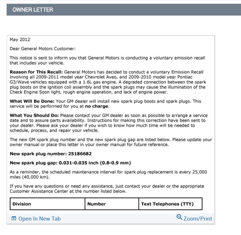

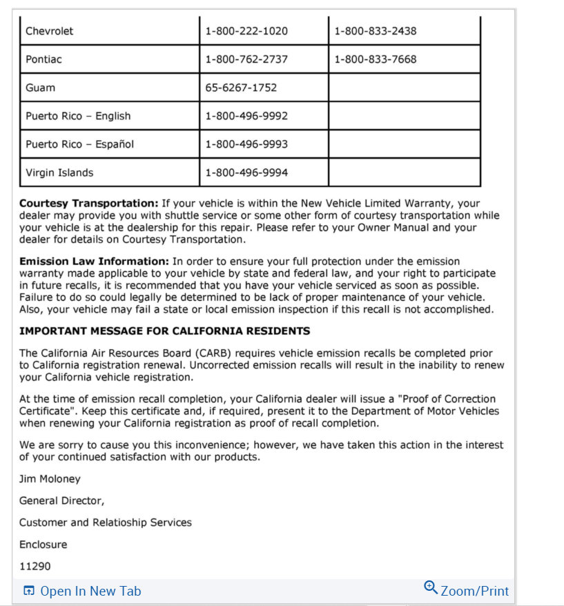

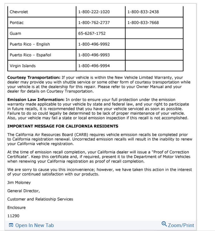

I do see a Recall on the Ignition coil boots, they are having a problem where there is an extra spring being added in as well as new spark plug part number and spark plug gap spec. I'll leave that below, This is the letter to owners, for this recall.

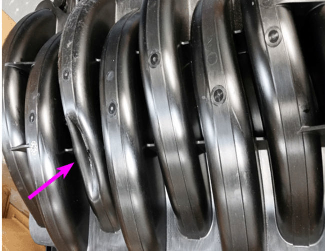

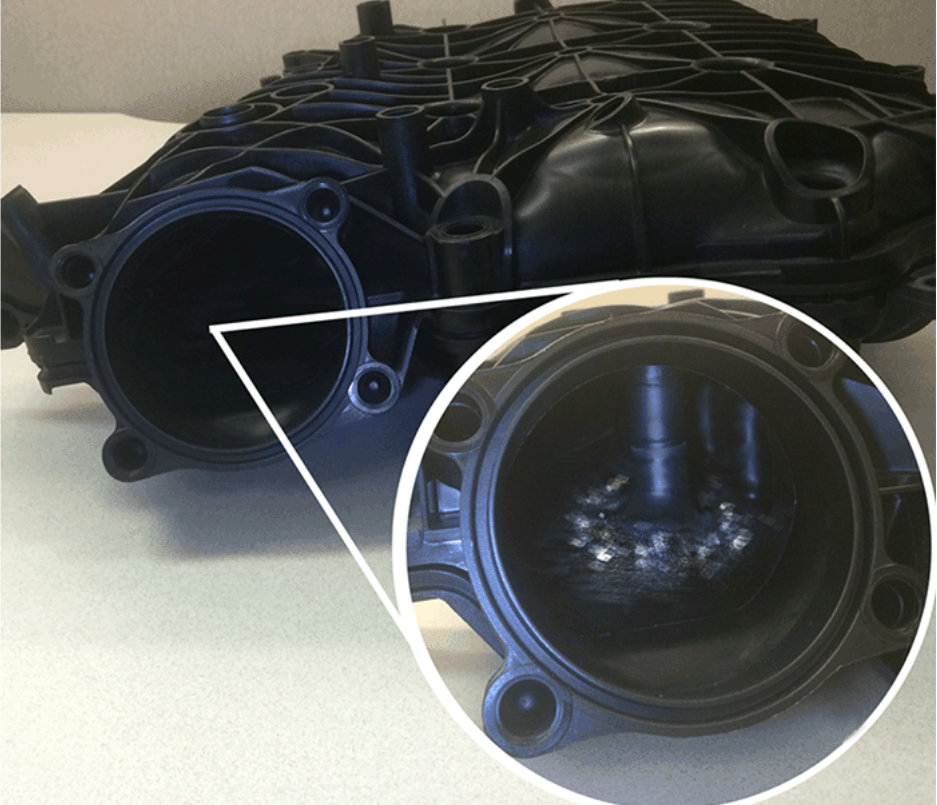

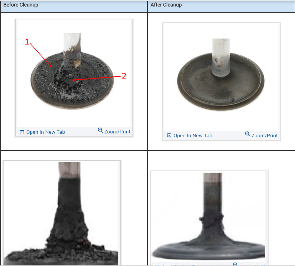

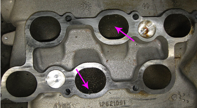

There is a TSB on valves sticking due to fuel quality and misfiring cylinders, and your car has been through a lot. The valve issue can cause rough idle, extended cranking times, or more misfires and can set misfire codes.

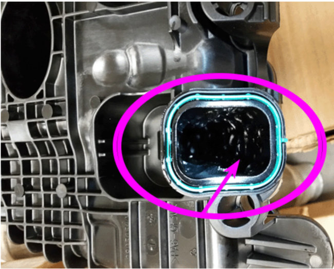

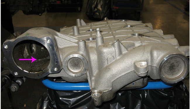

When you replaced the Intake manifold, that would have been the time to inspect the top of the valves for carbon build up.
There is a Bulletin on that as well. They included some pictures too ill post. Just things to look for, I'm not sure if you still have the old Intake, but take look for excessive carbon build up inside, if it's there, then it can be on the valves as well.
They have some pretty high-tech valve cleaning systems out now that you could have done at a dealership if you were concerned about it.

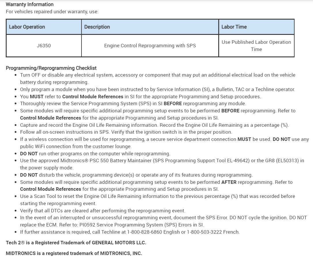

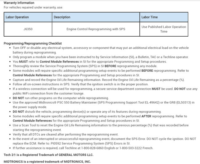

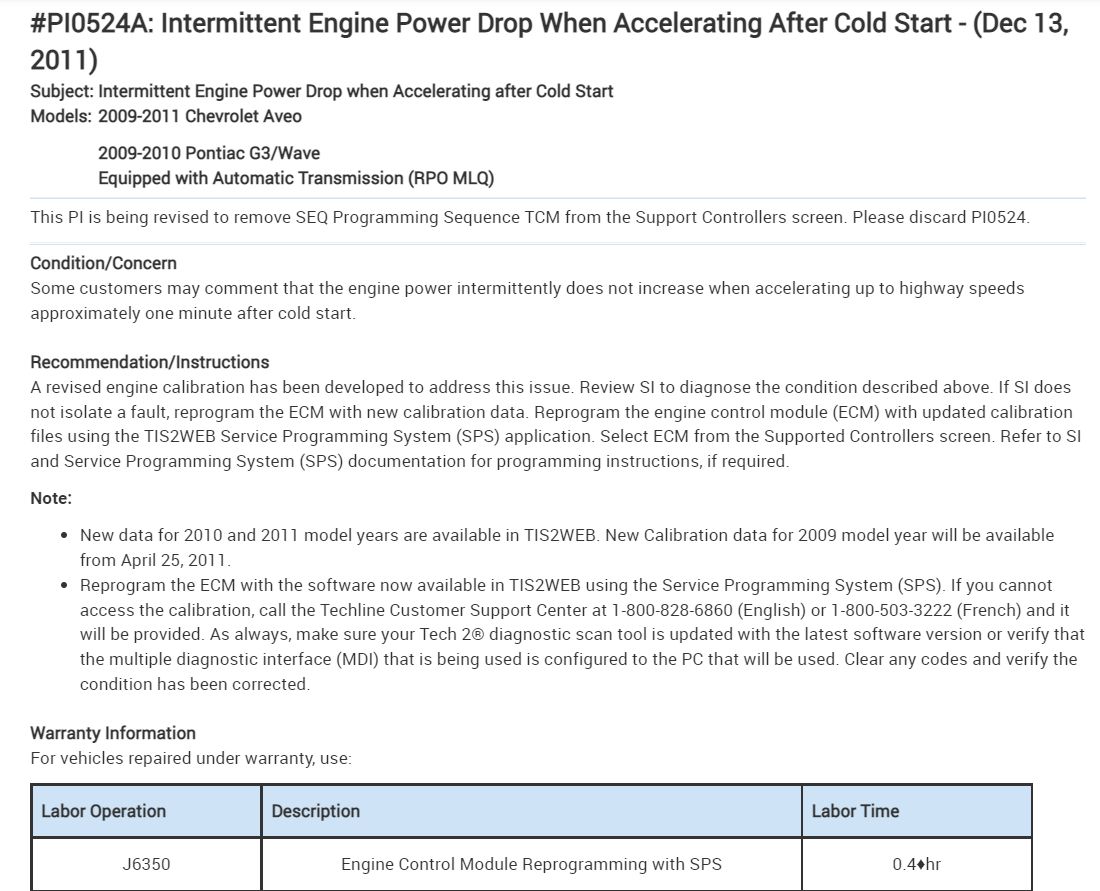

On a side note, I'm note sure if you have On Star in your vehicle, but they are doing over the air ECM updates now. If you don't have On Star then don't worry about it.
But I would check out this Ignition Coil issue and Spark plugs. That will cause misfires.
Unfortunately, it will be difficult to say exactly what is happening with the surge in hot weather, it could be the fuel in your area, it could be a sensor glitching like I mentioned,

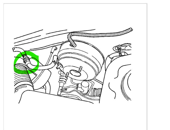

You can try replacing the Brake Booster check valve, I don't think it will do much, but they are cheap, so it's worth a try. I've had a brake booster that only leaked on the inside at the brake pedal when the pedal was pressed down. But it was on an older vehicle.
On something like that, it might be drive it until a code sets or something very noticeable happens. There are a couple of other ECM updates, the last 3 pages below, the 2nd one has to do with a condition that shows up above 100f degrees outside temperature, I know this is a lot of information, there has just been a lot of technical Bulletins since our last contact, I don't remember if you had a scan tool that can show live data, but if you do, keep an eye on live data PIDs such as Long Term and Short Term Fuel Trims, especially when you feel a hesitation or surge. But I think it would be something more along the lines of a sensor having a heat related issue. So, the updates might help with that.

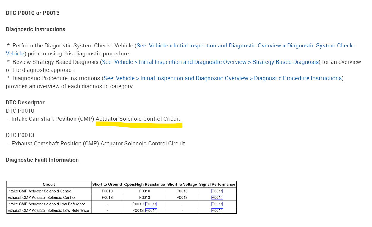

Well, it's odd that you're getting both codes at the same time, because one is for the exhaust cam shaft actuator and the other is for the Intake cam shaft actuator.
The code setting criteria is the ECM driver commanded state not equaling the actual state of the actuator for more than 5 seconds. So, for both cams setting the same code is strange. You don't have much mileage, well you didn't when we started our journey here, 76,000 is not much. Which connector did you change? Was it the exhaust one that was brittle and failing apart? Does the harness run near the exhaust manifold on this vehicle?

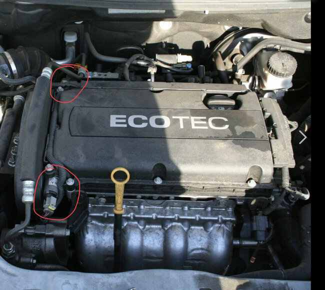

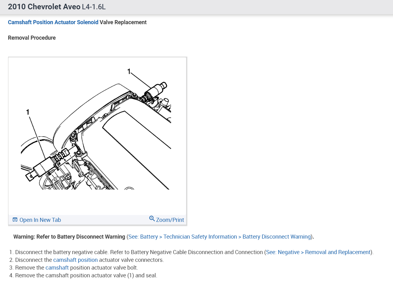

It’s near the intake manifold the sensor. Right near the valve cover. So, I had to remove the valve cover to remove the sensor.
Monday, October 10th, 2022 AT 3:29 PM
CHEVYOWNER10
  • 93 POSTS
Here is where it’s at. It’s on the end of the valve cover as you see in the photo.

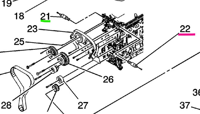

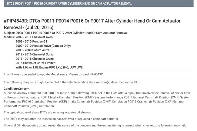

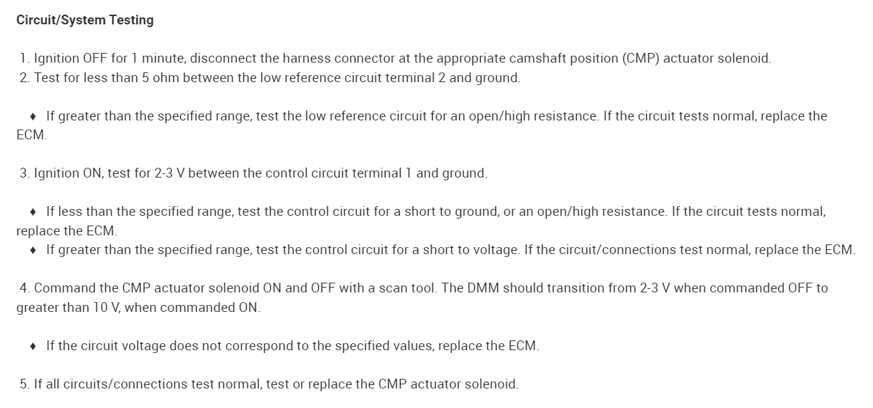

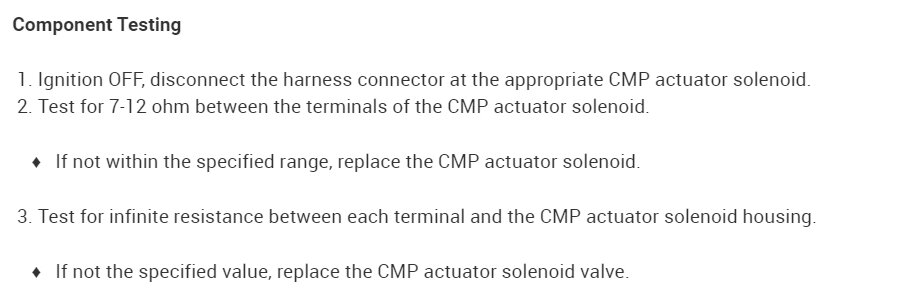

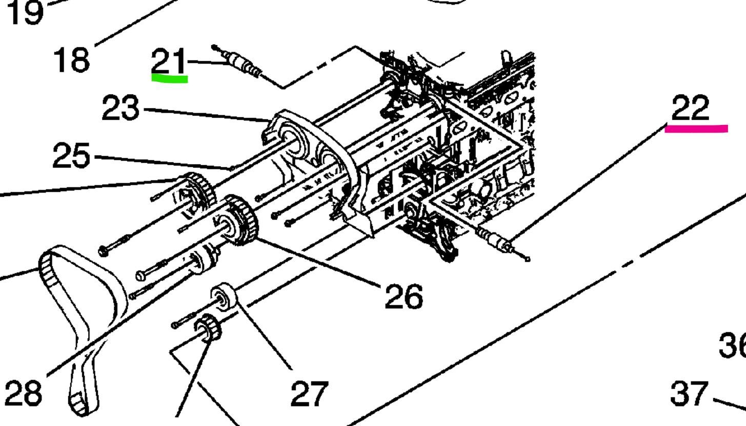

Okay, here are the resistance specs for testing the actuators. But you don't get any codes back until you rev it over 2,000? That's about the RPMs that the ECM would actuate the cams, it's not something that would happen at a lower or idle rpm. I'm also posting the circuit test you can do to see if this is a harness problem, it sounds like it is. If you've got wiring that's falling apart like that. When you change the connectors, are you using crimp connectors that are heat shrink connectors? To keep any moisture out. I'm surprised at the amount of issues you're having with this car.
How difficult is it to get that top timing cover off I see there in the diagram?

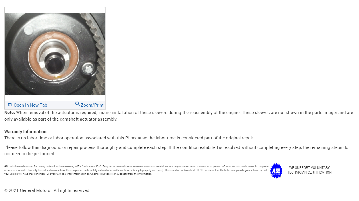

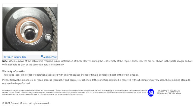

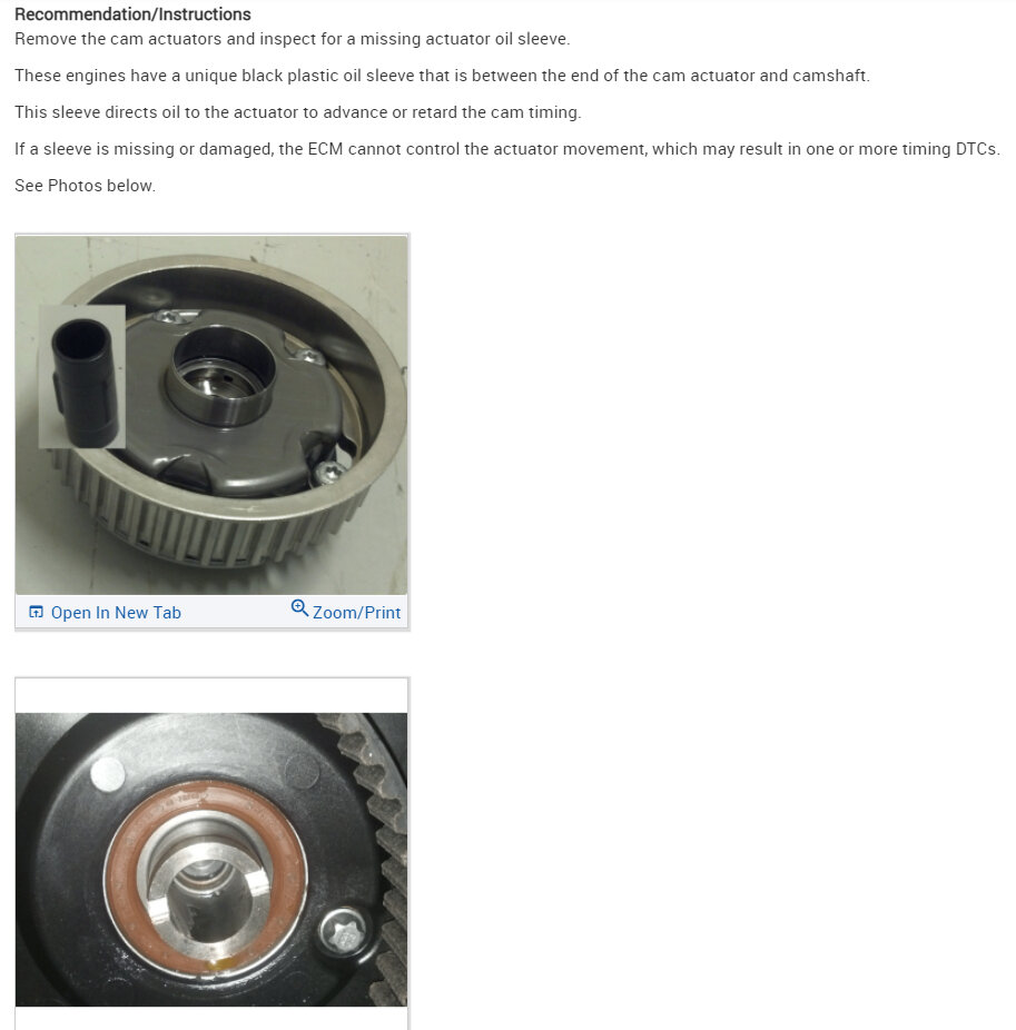

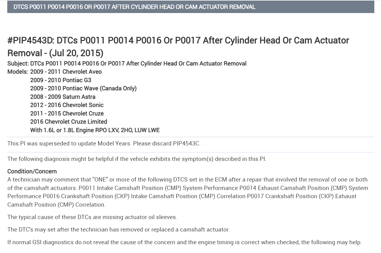

There is actually a TSB for this issue. The last 3 diagrams below.
Why they would put a plastic sleeve on a camshaft is beyond me.

Yes, I know you removed the valve cover; I was just wondering how difficult it would be to remove that upper timing cover just to check the belt tension. The p0013 is the exhaust cam actuator. So, in your picture the exhaust actuator would be the lower one. Do you know if the intake and exhaust actuators were different part numbers? It's not giving me part numbers here on all data, but I can look a different place to check.

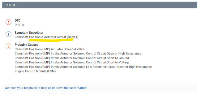

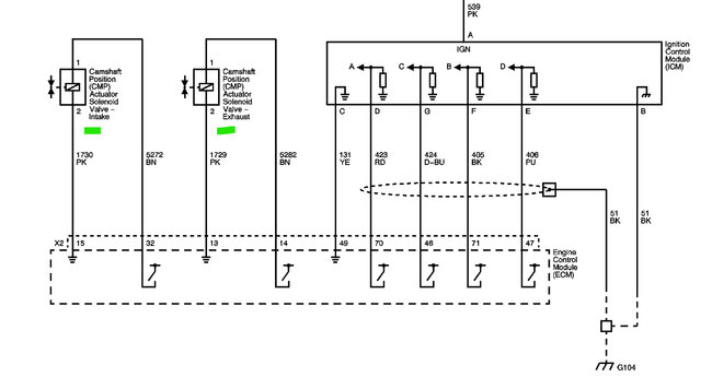

Is the exhaust actuators harness plug just as bad as the other was?

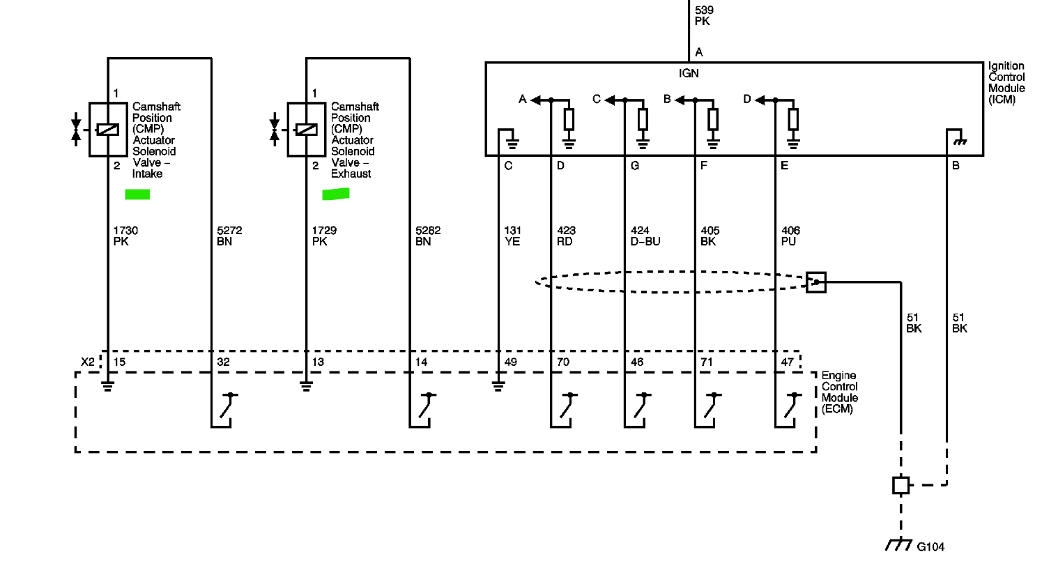

The wiring for both is the same exact coloring and I don't see a different part number for the intake or exhaust so far.
But they don't seem to share a ground wire or anything like that. The pink wire is the ground going into the ECM and the brown wire is a pulse width modulated power feed.

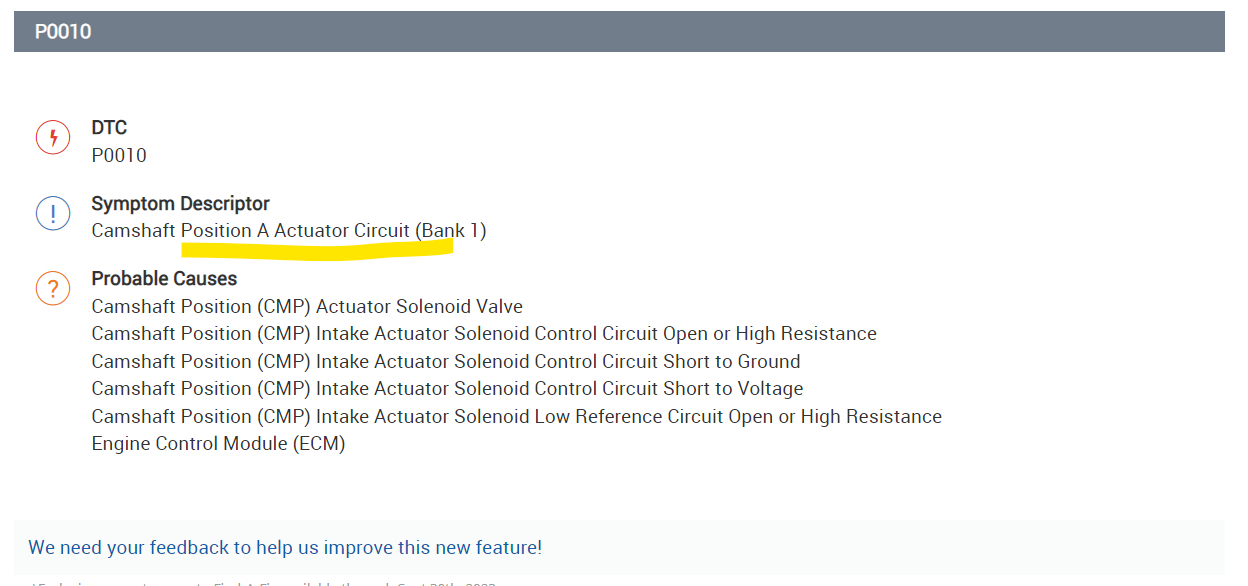

The coding of these is strange, the p0010 is the intake actuator, but they have two different codes for it as well.

The wiring diagrams show 2 cam actuators, one intake and one exhaust. So do the multiple codes for those circuits. That diagram on the link showed the cam actuator on the rear of the engine. This one shows the 2 up near the timing cover. 22 is the exhaust and 21 is the intake. But if the wiring was brittle I would check the pin fitment of the connector, just to make sure it's making good connection. And I'm not sure but some ECMs will disable certain systems if there is a code for one of the components in that system. You're getting codes for both intake and exhaust at this point, so you might want to do the circuit checks and check the resistance of the actuators.
