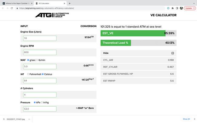

Your car has a 1.9l engine so 4g/s is a bit above what I would expect but not enough.

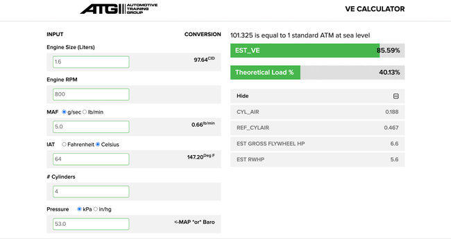

Try this, (webpage below), It is a VE test, volumetric efficiency test using data numbers.
You put in the numbers you're seeing on your scan tool, and it will tell you how well the car is breathing.
https://atgtraining.com/atg-volumetric-efficiency-calculator/

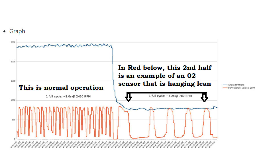

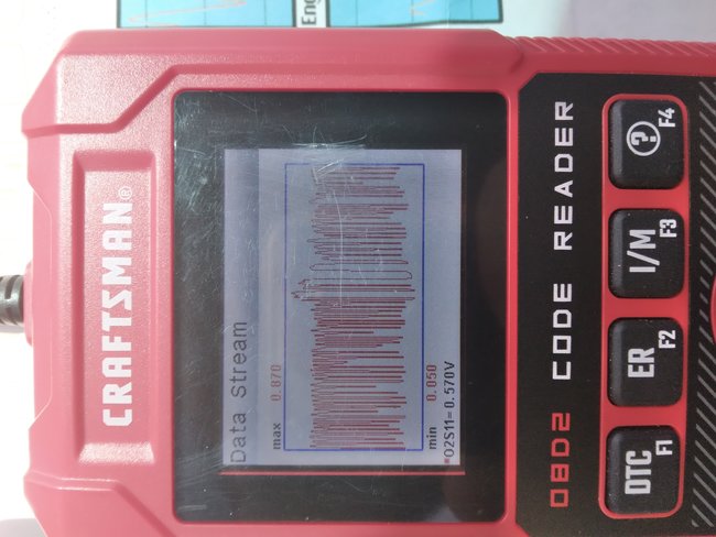

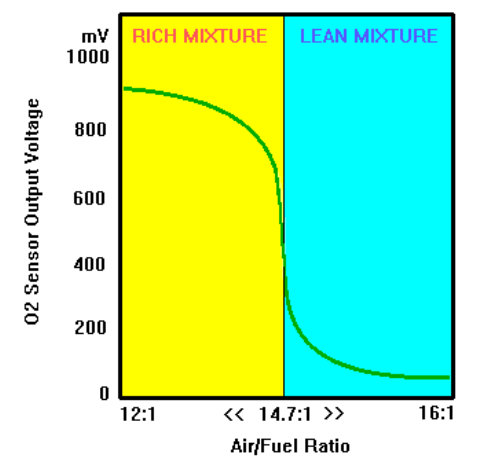

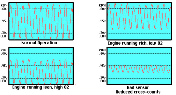

0xygen sensor voltage readings: at idle, acel and decel
O2s bank 1 sensor 1- swinging from 0.95v to 840v
02s bank 1 sensor 2 - does not reach below 600v, it can go as high as 850 but stays around 700.
Here is the graph i attach also of the o2 sensor bank 1- sensor 1
You see how the current changes in the middle? That is when the rpm needle surges at idle.

So far you have done the VE test and it came out really good. So, the converter is not an issue. The front 02 looks great. That little flutter in the middle is the ECM correcting its fuel strategy. We just need to find out why you're getting an over rich condition intermittently. You might have a fuel injector that's sticking when it's hot. I'll put a link below for a Fuel Injector pulse kit. So, you can do a Fuel Injector balance test when the vehicle is hot. Thats when your issue is happening.

On your 02 graph, you can see it goes rich for a split second, then goes lean for a second. That looks like a fuel injector sticking open on decel and the ECM compensating for it. I would try the injector balance test while it's really hot, so right after a long drive. It doesn't look like it surges for very long. Your fuel pressure spec is 53-60psi. While the pressure gauge is on the rail make sure the pressure doesn't drop off suddenly either.

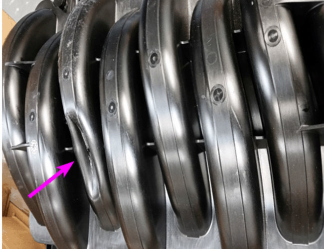

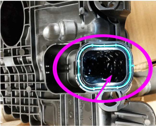

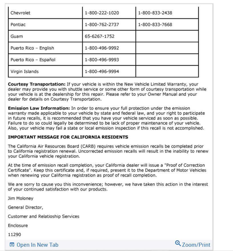

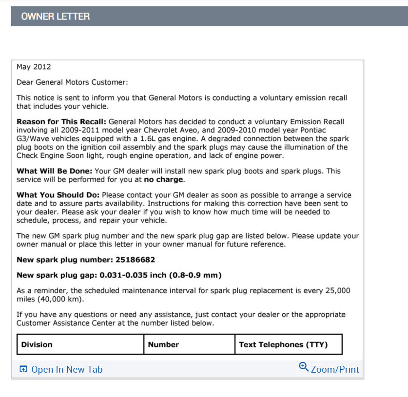

I do see a Recall on the Ignition coil boots, they are having a problem where there is an extra spring being added in as well as new spark plug part number and spark plug gap spec. I'll leave that below, This is the letter to owners, for this recall.
I don't suppose you are getting any codes at all.

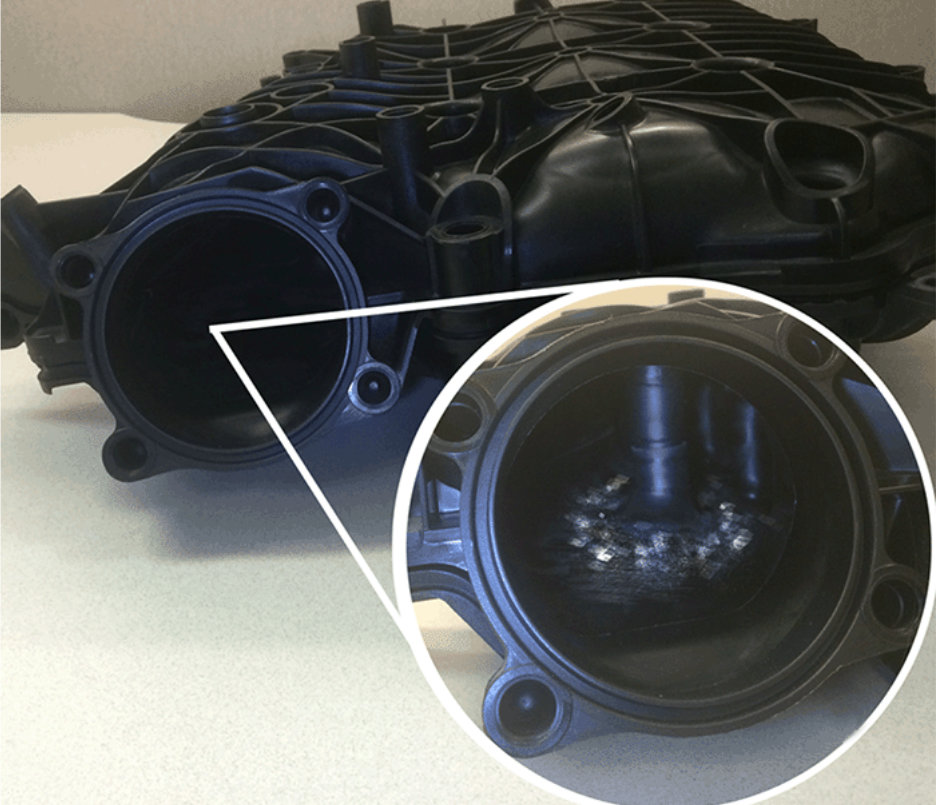

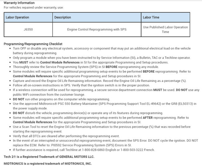

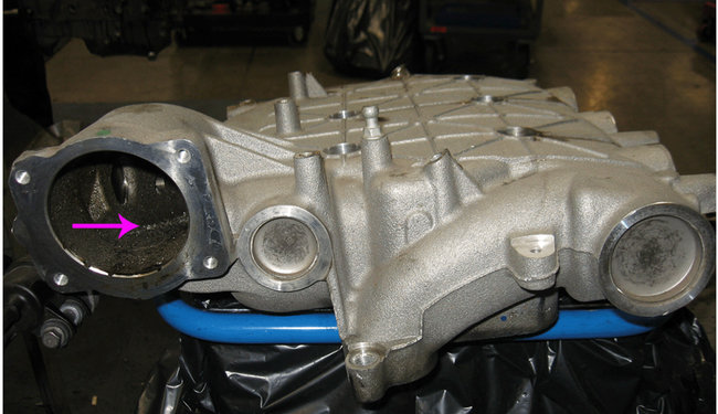

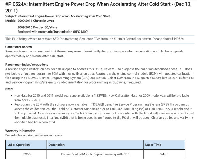

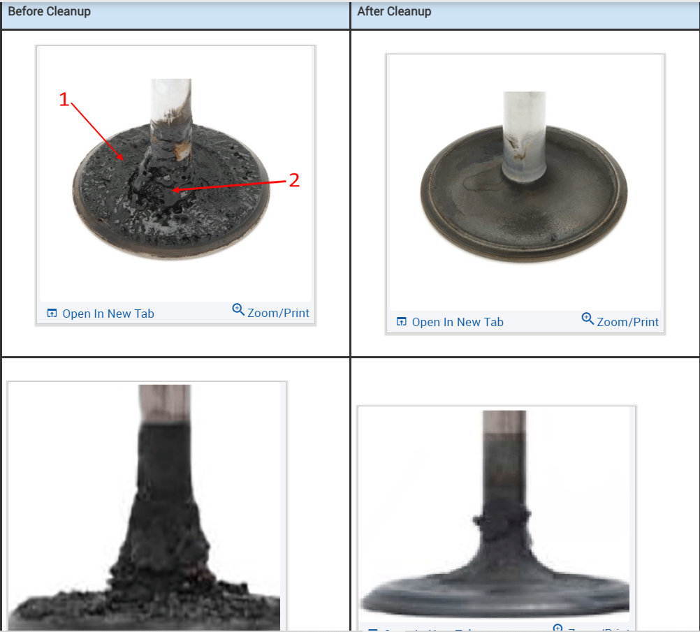

There is a TSB on valves sticking due to fuel quality and misfiring cylinders, and your car has been through a lot. The valve issue can cause rough idle, extended cranking times, or more misfires and can set misfire codes.

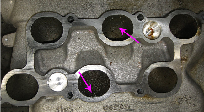

When you replaced the Intake manifold, that would have been the time to inspect the top of the valves for carbon build up.

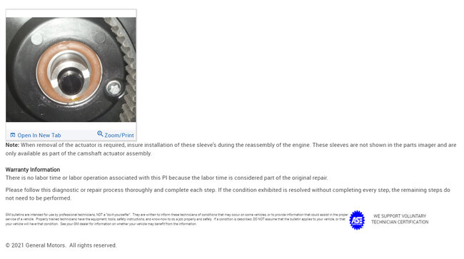

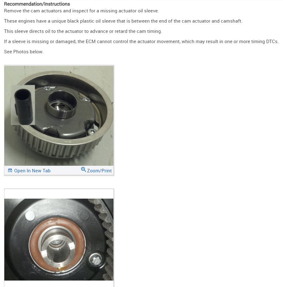

There is a Bulletin on that as well. They included some pictures too ill post. Just things to look for, I'm not sure if you still have the old Intake, but take look for excessive carbon build up inside, if it's there, then it can be on the valves as well.
They have some pretty high-tech valve cleaning systems out now that you could have done at a dealership if you were concerned about it.
On a side note, I'm note sure if you have On Star in your vehicle, but they are doing over the air ECM updates now. If you don't have On Star then don't worry about it.
But I would check out this Ignition Coil issue and Spark plugs. That will cause misfires.

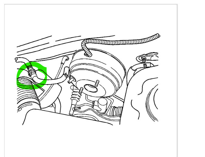

You can try replacing the Brake Booster check valve, I don't think it will do much, but they are cheap, so it's worth a try. I've had a brake booster that only leaked on the inside at the brake pedal when the pedal was pressed down. But it was on an older vehicle.
On something like that, it might be drive it until a code sets or something very noticeable happens. There are a couple of other ECM updates, the last 3 pages below, the 2nd one has to do with a condition that shows up above 100f degrees outside temperature., I know this is a lot of information, there has just been a lot of technical Bulletins since our last contact, I don't remember if you had a scan tool that can show live data, but if you do, keep an eye on live data PIDs such as Long Term and Short Term Fuel Trims, especially when you feel a hesitation or surge. But I think it would be something more along the lines of a sensor having a heat related issue. So, the updates might help with that.

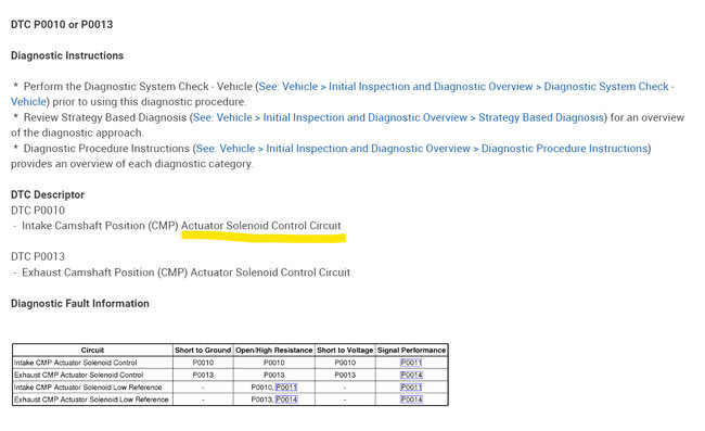

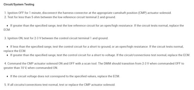

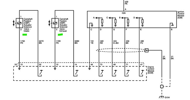

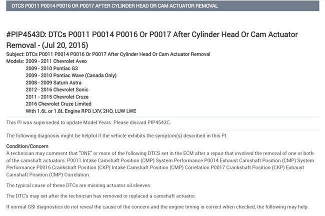

Hi AL, what a crazy month September has been I was not able to drive this car AGAIN, so it sat the entire month. I have been waiting on more parts and could not drive it all last month. Let me tell you what it's doing NOW. I might think it's a sensor causing rough idle rpm surging and rough acceleration, but it's been a slow process figuring it out with this rpm surge mystery because it doesn't do it all the time. Thank you for trying to figure it out with me because it has been very frustrating not being able to drive my car.
Shortly after replacing the intake manifold, everything was ok until about a week after I commented to you here. I would say the beginning of September, the day before Labor Day the ECM sets out another code P0013. It must have been a slow process before the ECM decided to set the code because during the time, I comment to you about not being able to accelerate the gas pedal while driving shortly after replacing the intake manifold and having the rpm jump slightly at idle still, maybe this sensor is all related, I hope.....
I like to keep a record of what happens on my vehicles, so I know when the problem begins to exist. I replaced the entire intake manifold with new gaskets nd brand new fuel injectors with new rail sometime in August before it was inspected because it needs to get inspected that month. So again, to repeat myself, I checked spark plugs and coil packs and cleaned the MAF sensor and throttle body while replacing the intake. None of that really improved acceleration.
To answer your question about intake manifold carbon build-up, no I did not notice any major carbon build-up on the old manifold. I had to remove the valve cover to replace the intake and I didn’t notice a lot of carbon buildup on the valves. It was just dry oil residue on the cams. That being said, I think this car must have been a short-trip-driven car because it had low mileage when I purchased it in 2015. It was a clean car, but it had its problems. I don’t change my oil every 3,000 miles, only once a year. The older lady I bought it from used conventional because I can tell it wasn’t good quality oil. I have been using high-mileage synthetic motor oil for over 75,000 now and I have been using synthetic since I owned the car.

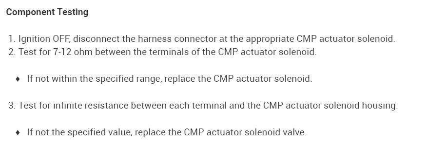

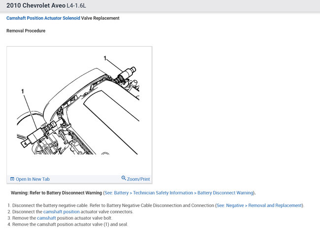

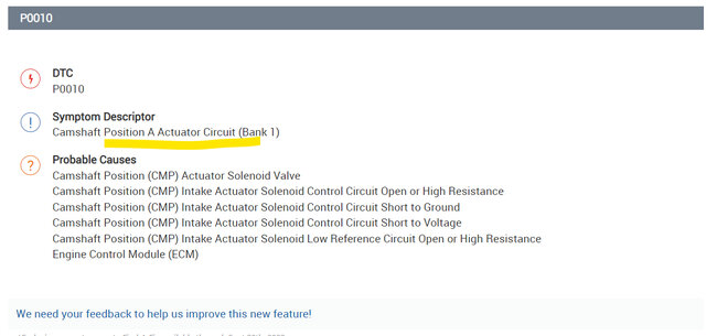

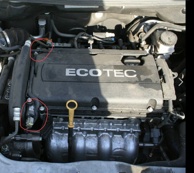

Now to explain what it’s doing now. At the beginning of September, the day before Labor Day, I was out running errands and the check engine light came on. I tried to clear the code P0013, but it would just come back right on. The code is set for the variable valve timing solenoid. I replaced the sensor but as soon as I replaced the sensor the wiring for that sensor broke off. It took a month to find a new connector for this sensor. I was able to install the new connector today. But the check engine light didn’t go out like I thought it would due to the break in the wiring.
Here’s what happened today: I replaced that connector, cleared the code P0013, and as soon as I step on the gas at idle to rev to above 2000 RPMs the check engine light comes back on. Check codes again, P0013 comes back and now I see P0010. They are for both the VVT solenoid causing it to stay open. I check resistance in the sensor itself and it’s not giving me the range I should have. I contact the dealer to see if they can send me a replacement.
I did install the sensor correctly this time, thankfully, and the new connector is installed right because I got a wiring diagram to check where the color wires need to go back in the connector. I am hoping it’s just a bad sensor out of the box. I really don’t want to go down this same road again like with the purge solenoid when the code wouldn’t reset, and I thought it was intermittently but in wrong. After all this time and here we go again, another mystery code that will not reset.

Well, it's odd that you're getting both codes at the same time, because one is for the exhaust cam shaft actuator and the other is for the Intake cam shaft actuator.
The code setting criteria is the ECM driver commanded state not equaling the actual state of the actuator for more than 5 seconds. So, for both cams setting the same code is strange. You don't have much mileage, well you didn't when we started our journey here, 76,000 is not much. Which connector did you change? was it the exhaust one that was brittle and failing apart? Does the harness run near the exhaust manifold on this vehicle?

It’s near the intake manifold the sensor. Right near the valve cover. So, I had to remove the valve cover to remove the sensor.
Oct 10, 2022 at 8:29 AM
CHEVYOWNER10
  • 93 POSTS
Here is where it’s at. It’s on the end of the valve cover as you see in the photo.

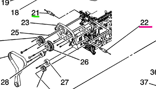

Okay, here are the resistance specs for testing the actuators. But you don't get any codes back until you rev it over 2,000? That's about the RPMs that the ECM would actuate the cams, it's not something that would happen at a lower or idle rpm. I'm also posting the circuit test you can do to see if this is a harness problem, it sounds like it is. If you've got wiring that's falling apart like that. When you change the connectors, are you using crimp connectors that are heat shrink connectors? To keep any moisture out. I'm surprised at the amount of issues you're having with this car.
How difficult is it to get that top timing cover off I see there in the diagram?
There is actually a TSB for this issue. The last 3 diagrams below.
Why they would put a plastic sleeve on a camshaft is beyond me.

It wasn't the timing cover; it was the valve cover I removed. And come to think of it, I think there are two camshaft actuators on this car, are there not? I think I might have replaced the one on top near the intake. I am looking at the engine digraph and I see another one on the front right above the left-hand side of the exhaust manifold. I replaced the one near the intake manifold. Do you think maybe that's what I did wrong? Replaced the one near the intake instead of the exhaust?

I replaced the one on top.

Is the exhaust actuators harness plug just as bad as the other was?
The wiring for both is the same exact coloring and I don't see a different part number for the intake or exhaust so far.
But they don't seem to share a ground wire or anything like that. The pink wire is the ground going into the ECM and the brown wire is a pulse width modulated power feed.
The coding of these is strange, the p0010 is the intake actuator, but they have two different codes for it as well.

The wiring diagrams show 2 cam actuators, one intake and one exhaust. So do the multiple codes for those circuits. That diagram on the link showed the cam actuator on the rear of the engine. This one shows the 2 up near the timing cover. 22 is the exhaust and 21 is the intake. But if the wiring was brittle I would check the pin fitment of the connector, just to make sure it's making good connection. And I'm not sure but some ECMs will disable certain systems if there is a code for one of the components in that system. You're getting codes for both intake and exhaust at this point, so you might want to do the circuit checks and check the resistance of the actuators.

Here’s what I will do: I replaced the wrong actuator near the intake. It was supposed to be location to the exhaust because that’s what set the code for. So, I need to buy another actuator for the exhaust side. The part numbers are both the same for both actuators.
But both connectors for the two actuators had very brittle wiring. They are both the same connectors, which is great. I replaced one connector, but I am going to have to replace the other connector next because it fell off. Waiting on the connector and the other actuator to come. When it does, I will let you know what it does, if the light goes out or not. I check the wiring fully and it doesn’t look like there are any breaks in it when you inspect inside the harness. It was just at the connector where it was brittle and falling apart, probably heat damage it. So, crimping a new connector on it and replacing the exhaust side should fix the issue.
