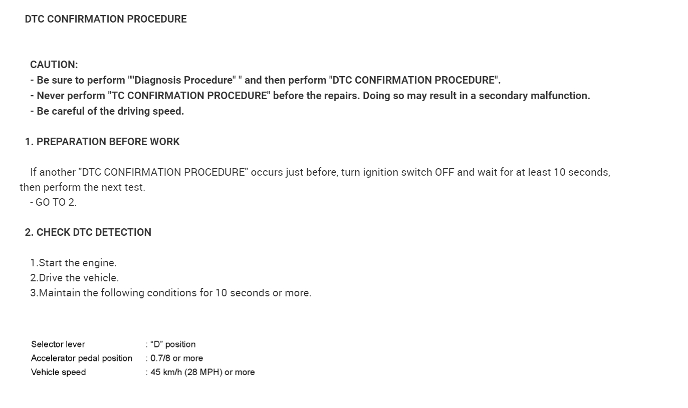

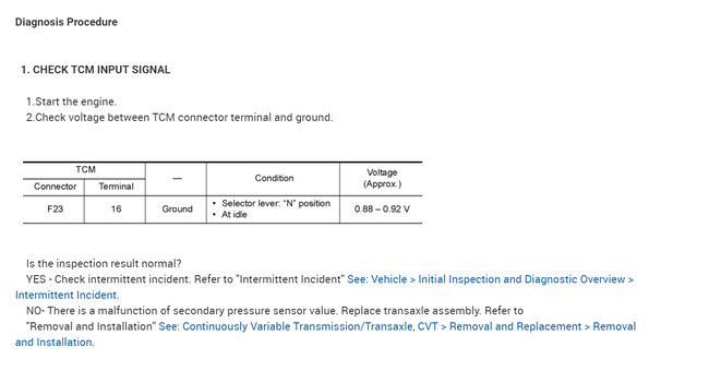

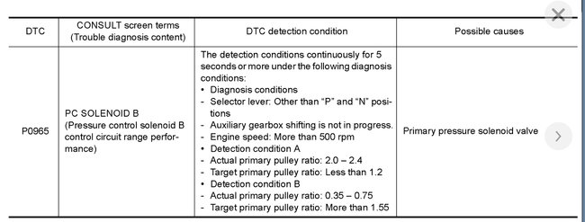

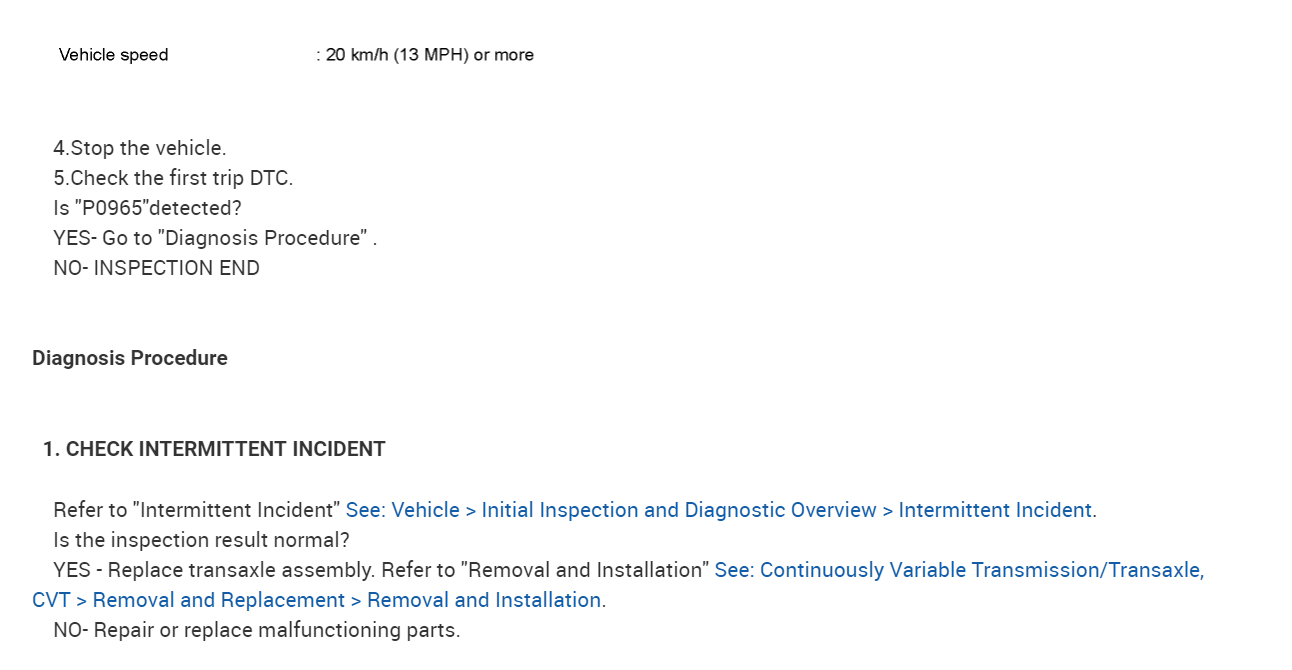

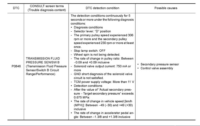

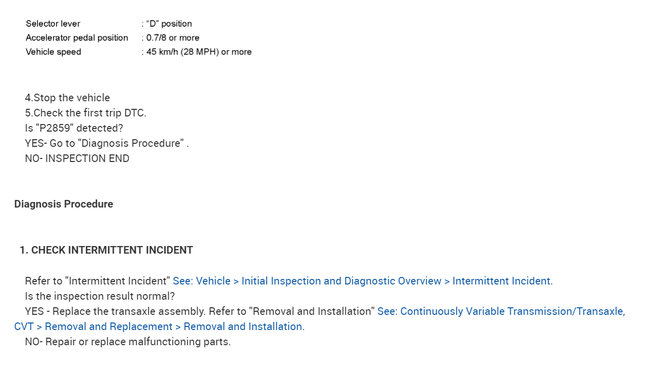

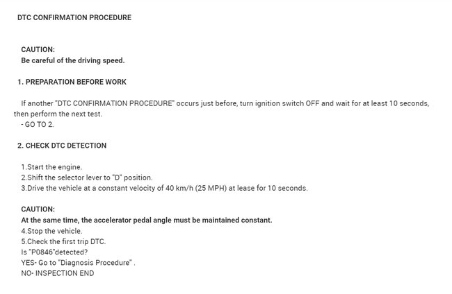

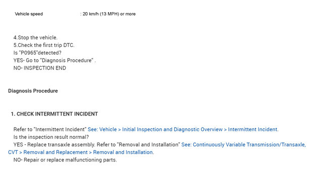

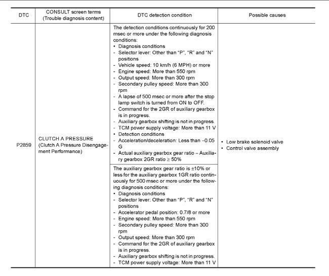

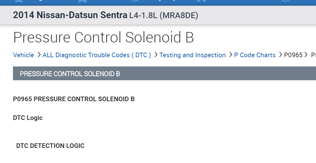

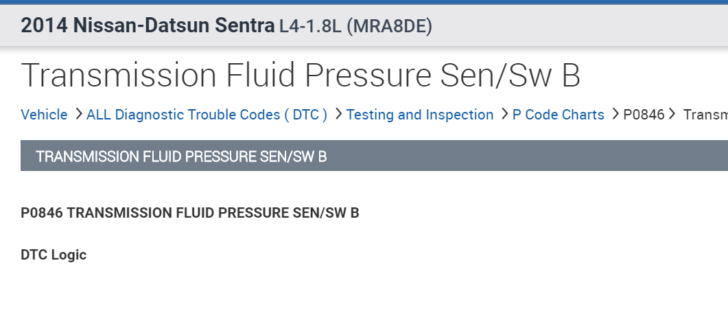

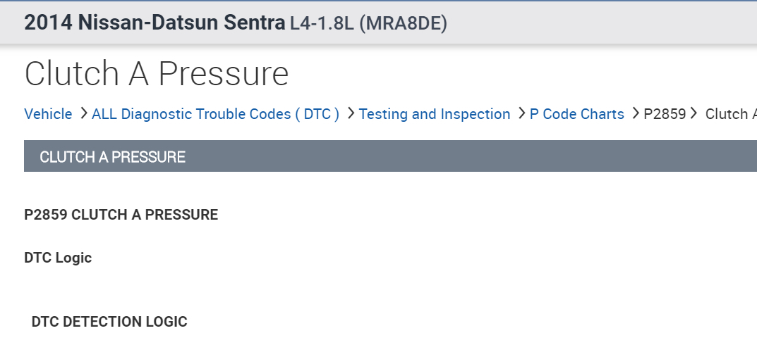

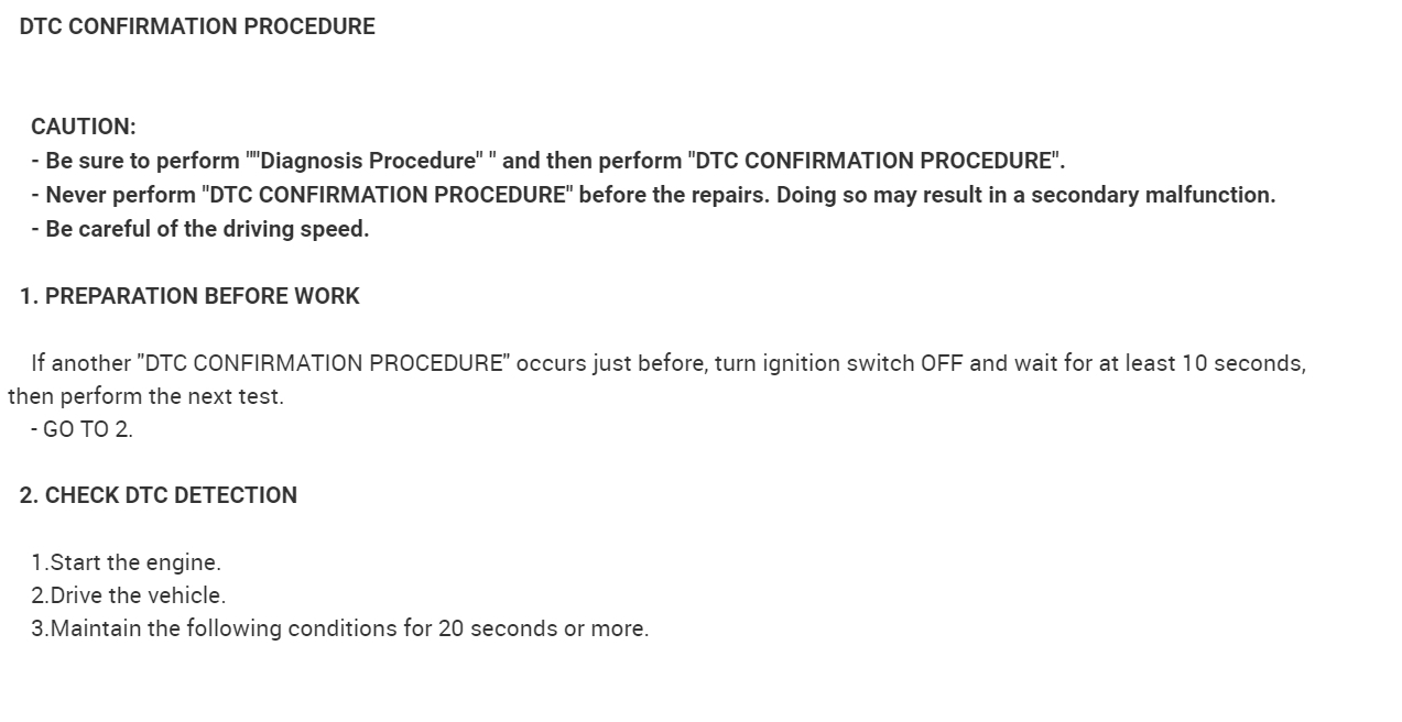

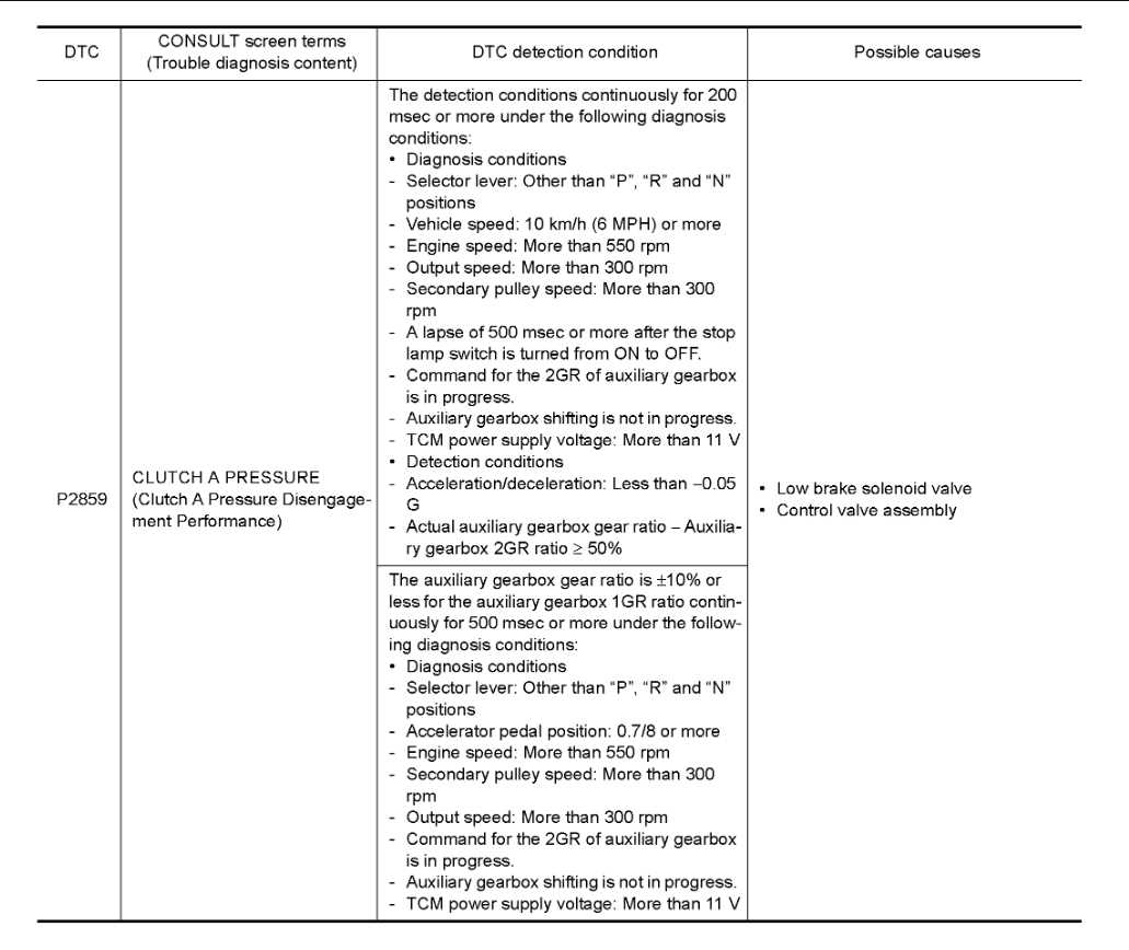

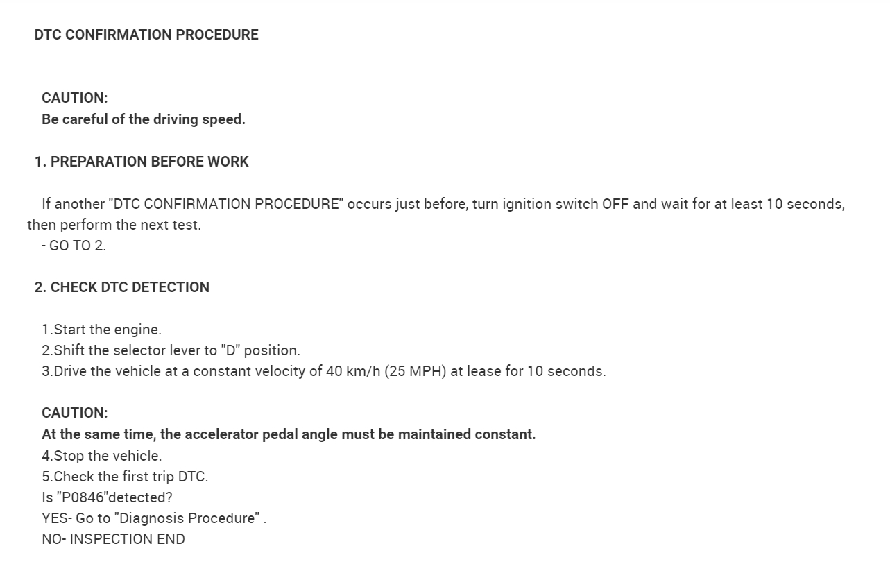

IM SAYS-O2S,CAT,EGR,AND EVA
OTHER CODES ARE-P0846
P0965
P2859
Mar 24, 2019 at 6:40 AM
SCGRANTURISMO
  • 4,897 POSTS
Hello again,
In the diagrams down below I have included factory description, conformation, and diagnostic information on all of the Direct Trouble Codes (DTC)s that you sent me. Please go through them and get back to us with what you find out.
