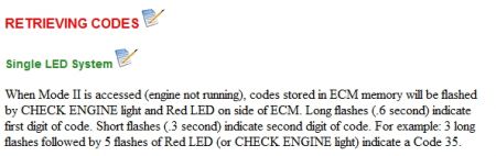

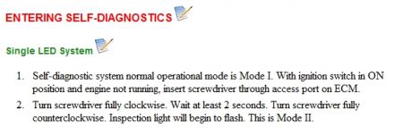

https://images.2carpros.com/forum/automotive_pictures/261618_Noname_2126.jpg
https://images.2carpros.com/forum/automotive_pictures/261618_Noname2_688.jpg

first you said the connector was in the fuse box and I found that. How do you access the codes through the connector and if you cannot, where is the computer with the LED lights?
Bill
May 7, 2010 at 3:02 AM
BLUELIGHTNIN6
  • 16,542 POSTS

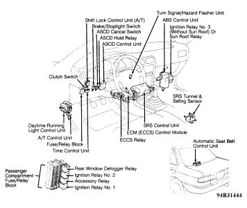

you need a Nissan Consult Tester (J-38465) to use with the DLC. just plug it in the DLC. without scanner, you can use the LED system. the ECM is located under the center of dash
https://images.2carpros.com/forum/automotive_pictures/261618_Graphic_492.jpg

MOOSECHOLOK
Thanks. Now, will I see the LED if I take apart the console? Bill
May 7, 2010 at 9:47 AM
BLUELIGHTNIN6
  • 16,542 POSTS
yes the LED light is on the ECM itself, so once the console is removed you will have access to the ECM and the light
