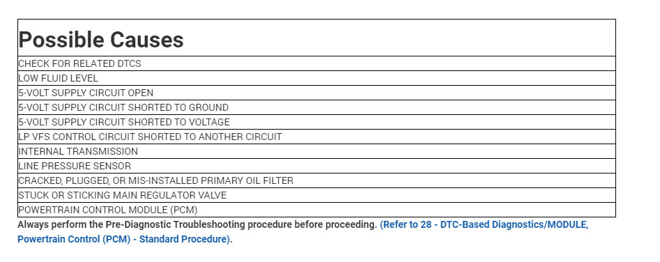

i have p0868 i think it may go to limp mode?
Aug 29, 2023 at 6:48 AM
  • 110,244 POSTS

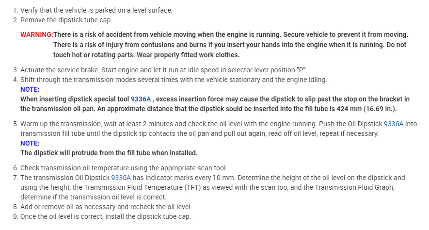

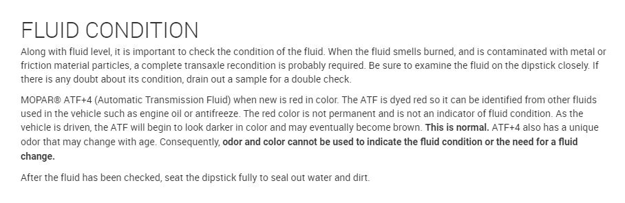

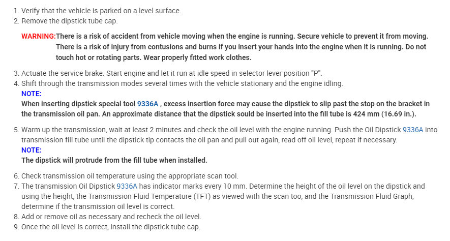

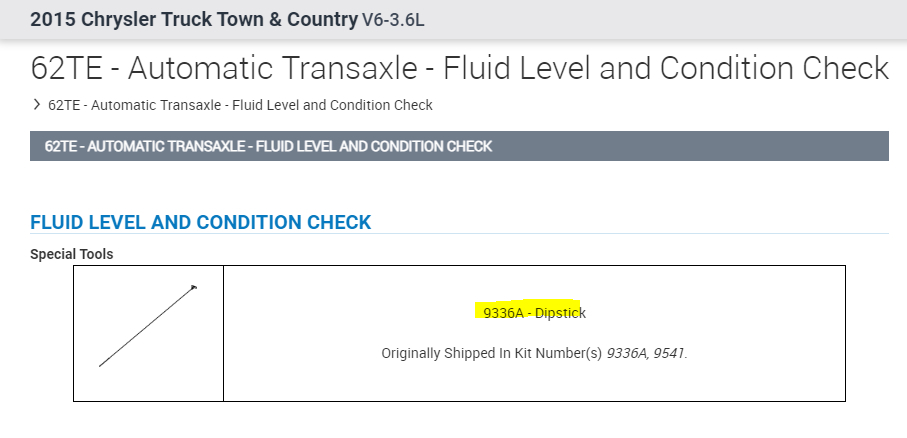

The code is related to low transmission line pressure. Have you checked the fluid level and condition? I ask because that could cause it. By any chance did you have the transmission fluid recently changed? A misaligned filter can cause it as well.
Let me know. There are several things that could cause this, but with the number of miles, I suspect it is something not too serious.

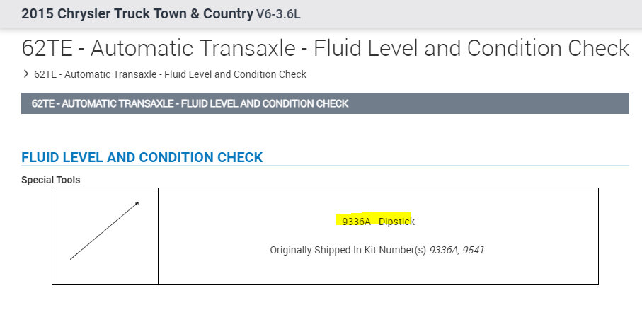

To check the transmission fluid level and condition requires a "special" dipstick. I attached the directions below.
Let me know what you find

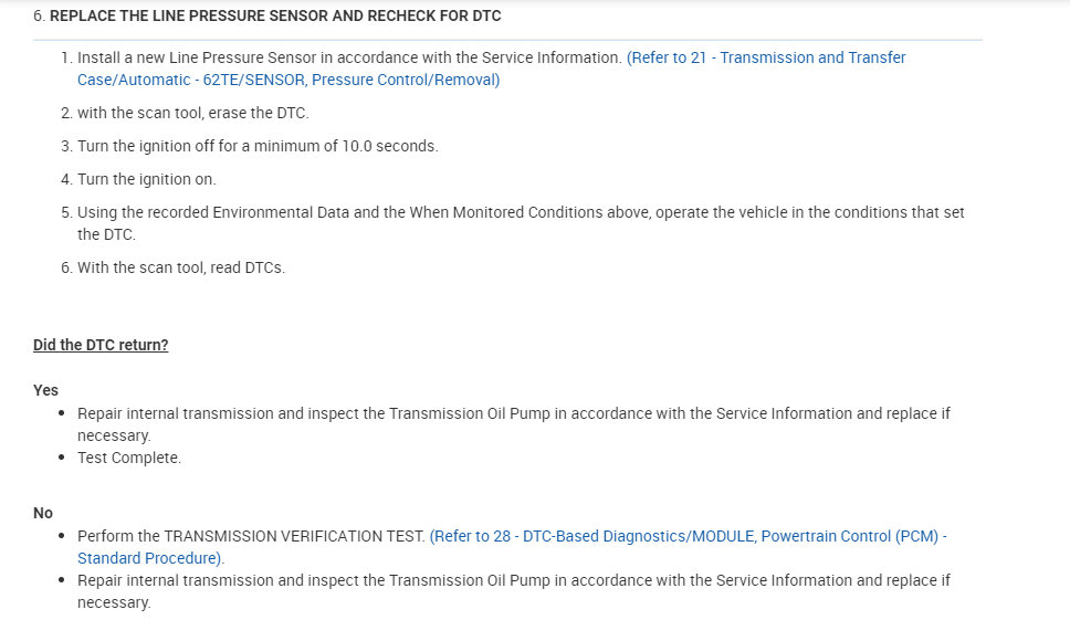

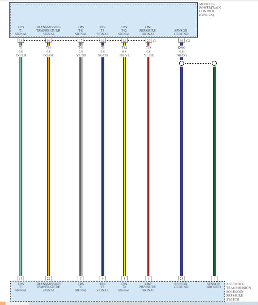

Thank you, I also replaced the transmission pressure sensor. I still get the same code.
Aug 29, 2023 at 11:24 PM
  • 110,244 POSTS

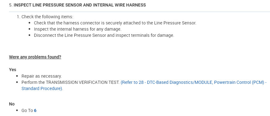

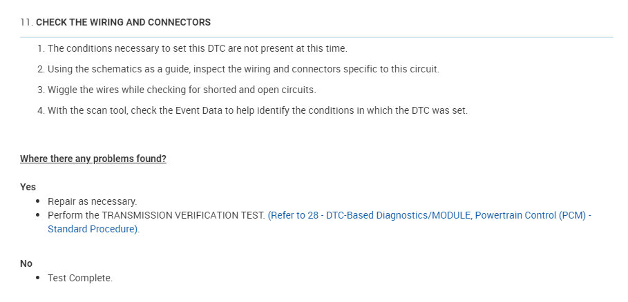

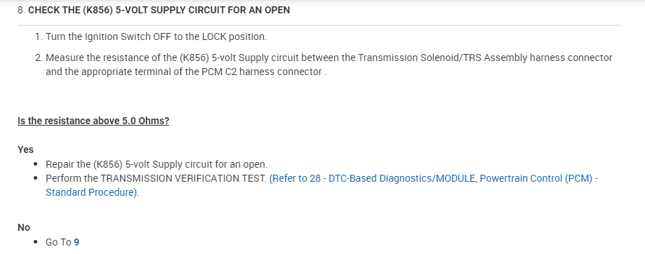

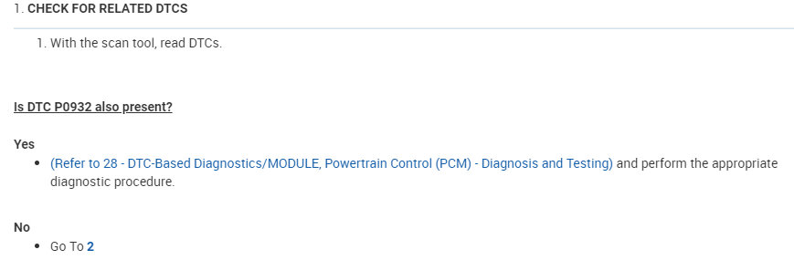

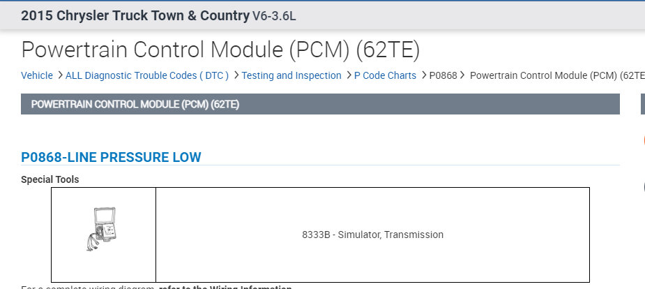

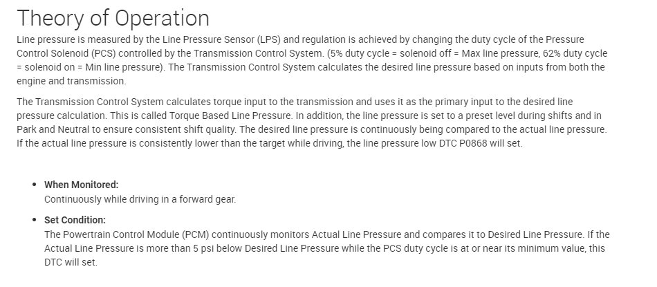

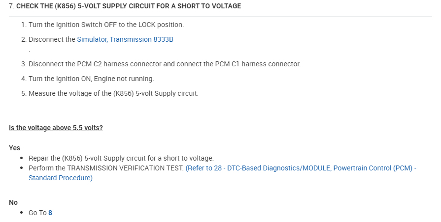

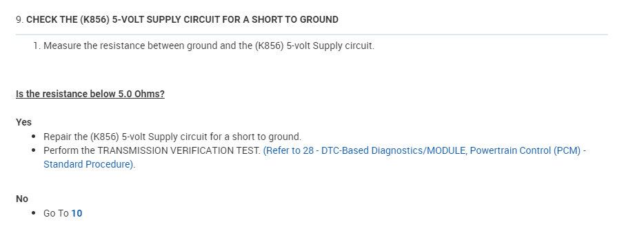

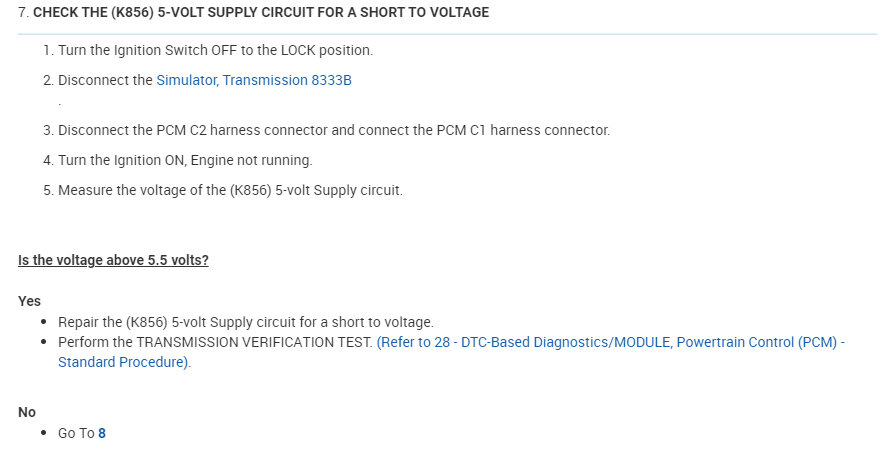

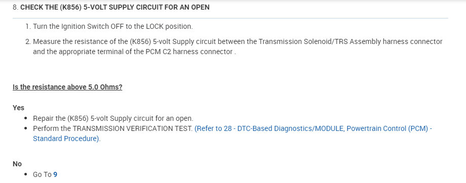

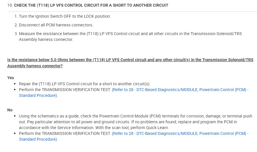

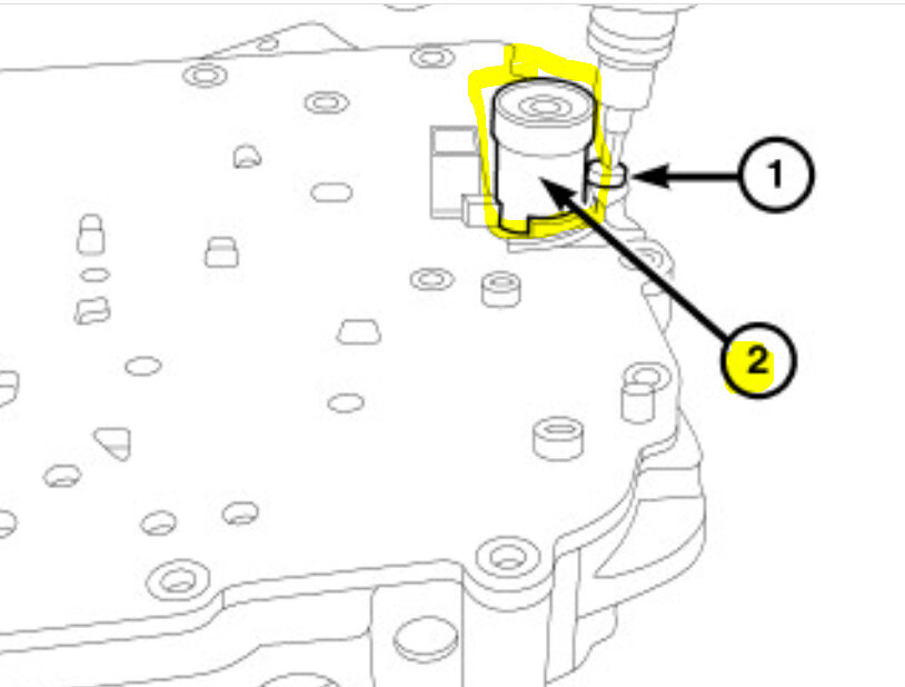

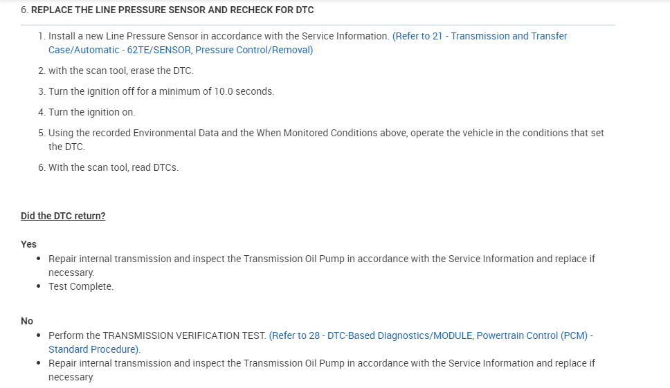

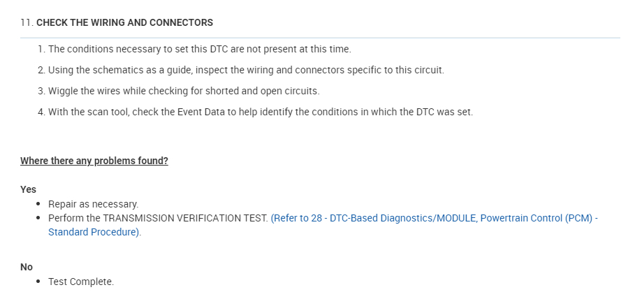

Okay. Keep in mind there is a pressure-control solenoid as well. Is that what was replaced or only the switch? I attached a pic below. Was anything else done?

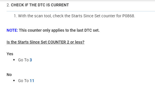

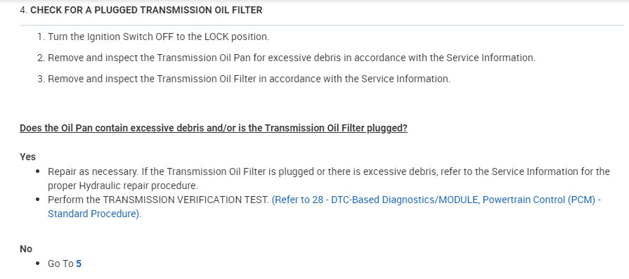

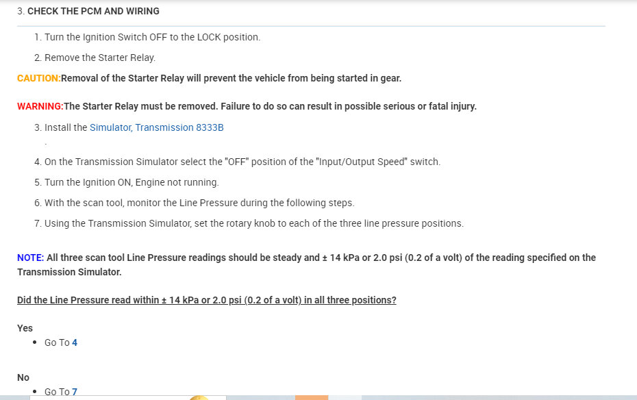

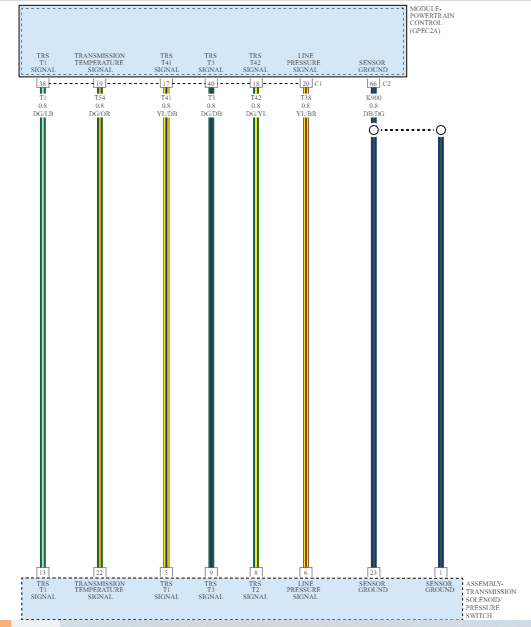

If you look below starting with pic 2, I attached the description, possible causes, and the diagnostics specific to the code itself. Take a look through them and let me know if you are comfortable performing them.
