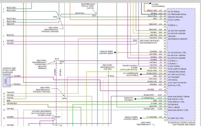

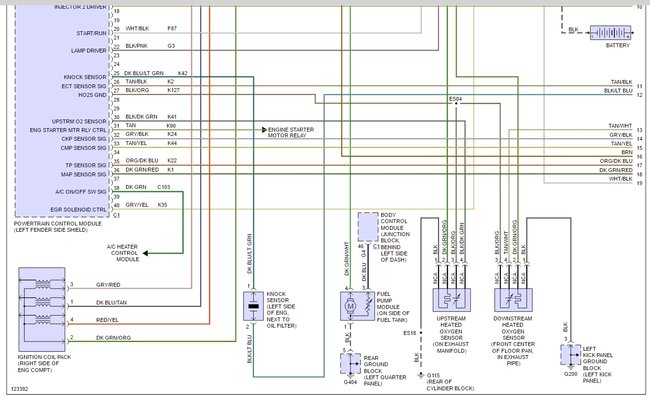

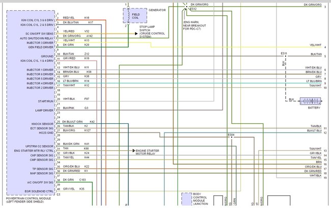

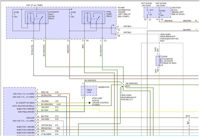

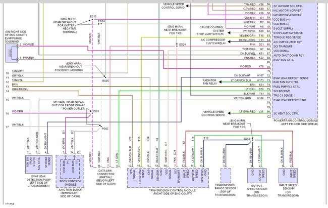

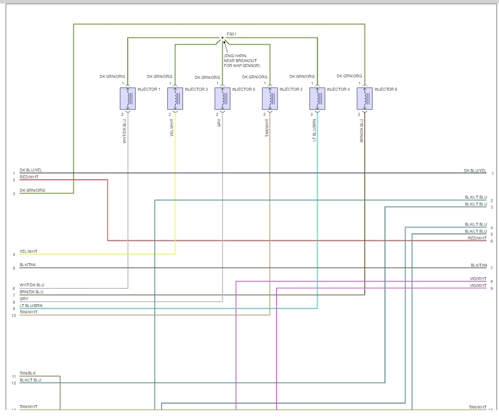

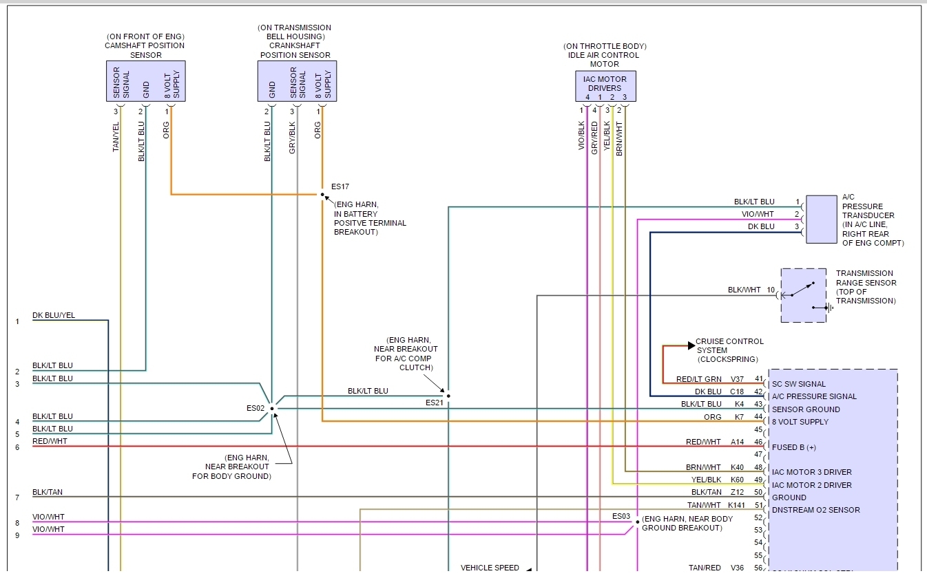

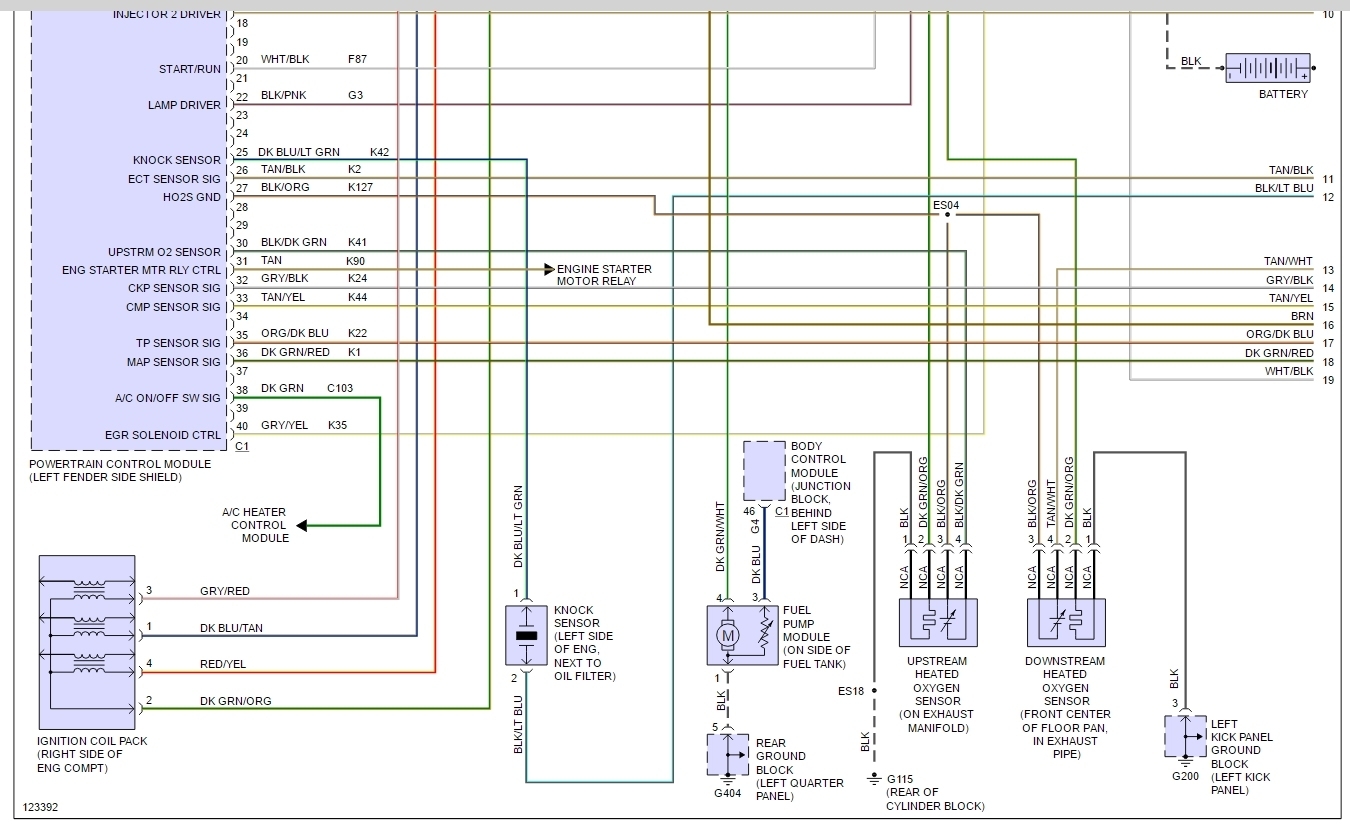

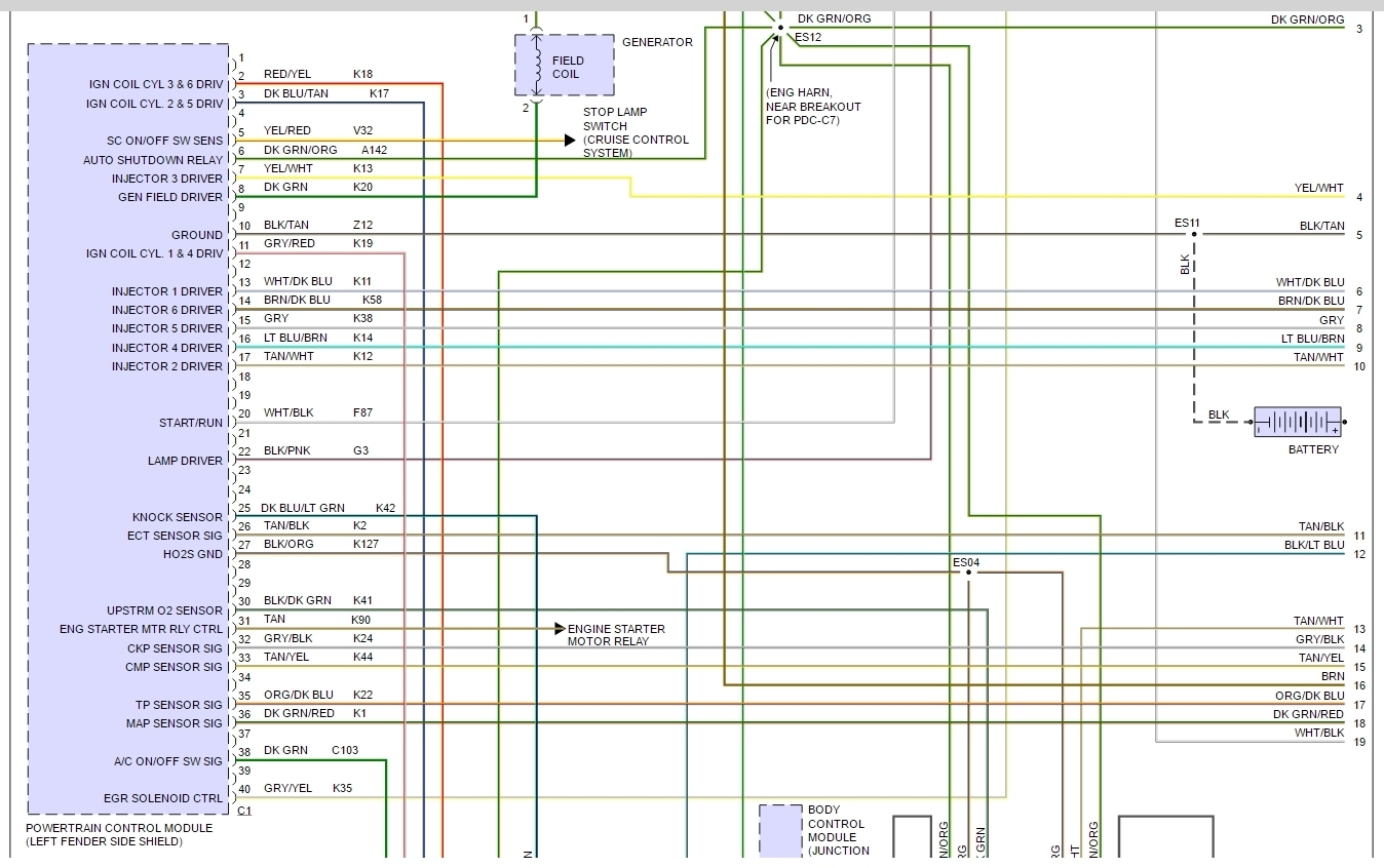

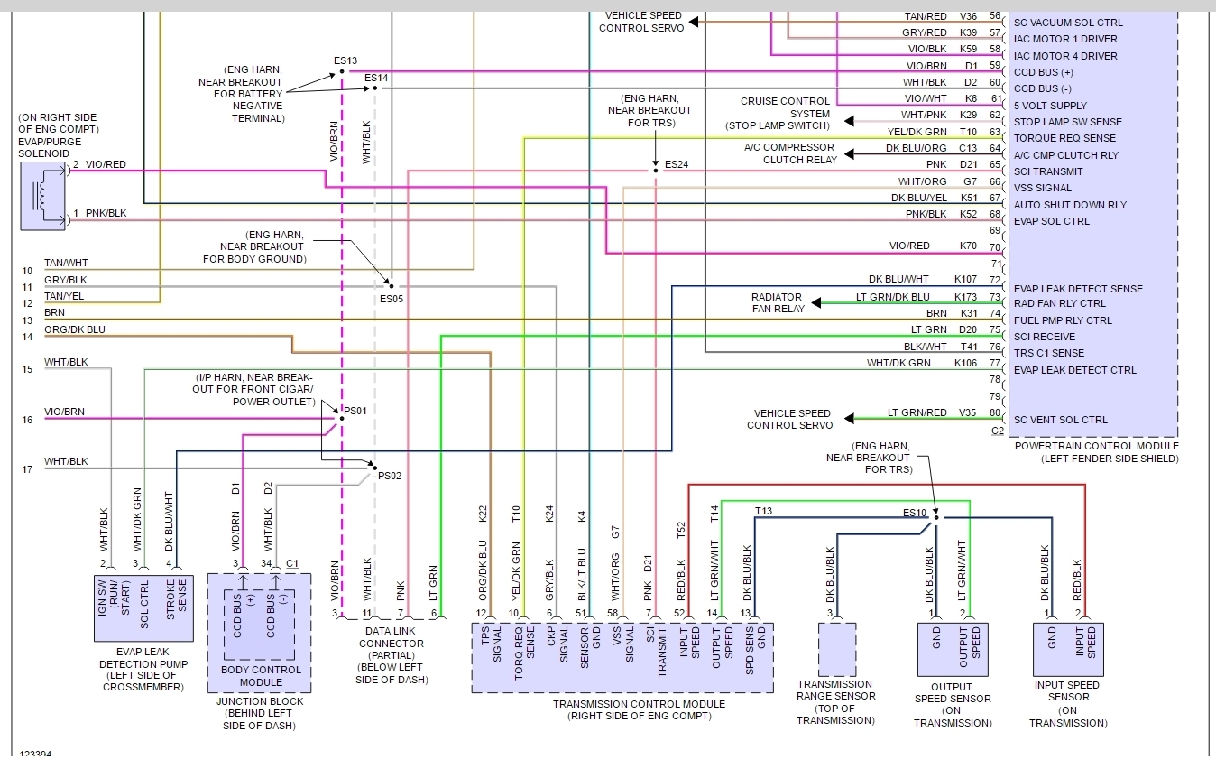

If I may butt in here it sounds like you have a bad PCM which is common on these cars. But to be sure do a pin to pin check here is a guide.
Also I found these wiring diagrams for you.
Please let us know what you find so it will help others.

I'm missing something and need to think about this a minute. You did a test that I don't do, but it has provided a clue. The constant 12 volts on the dark green / orange wire proves the Engine Computer is indeed turning the ASD relay on during cranking, but that is normally in response to those two signals showing up from the two sensors. Those sensor signals are also what times and triggers the firing of the ignition coils and injectors. To get a steady light on the other sides of the ignition coils says those coils aren't being grounded in preparation for developing spark voltage. I wonder if it's possible your test light is just glowing so brightly that you can't see the pulsing. Check for spark on one of the spark plug wires to see if it really is missing.
If spark is missing but the ASD relay is being turned on suggests only one sensor signal is needed for the computer to turn the relay on, not both signals like in earlier years. If there is no fault code related to a missing signal, you'll need a scanner to view live data and see how those two sensors are listed. Each one will have a "No" or "Present" listed during cranking.
