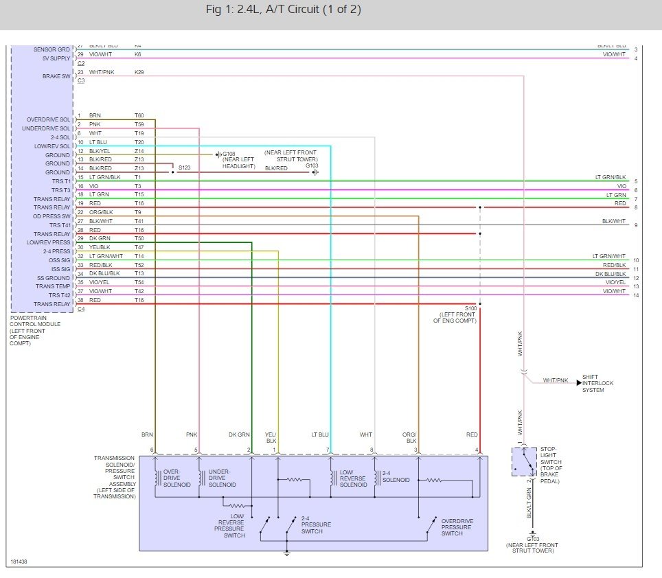

Even after replacing the TCM, most sensors, gone through all relevant wiring, found and cleaned the the main grounds checked all fuses and relays, reset codes. Said three hail Mary's, she just will not shift! Little help? I feel that it is something basic I have overlooked. Engine runs fine, starts well. Maybe a stray sensor I just cannot find the issue.
May 21, 2017 at 5:17 AM
  • 55,402 POSTS

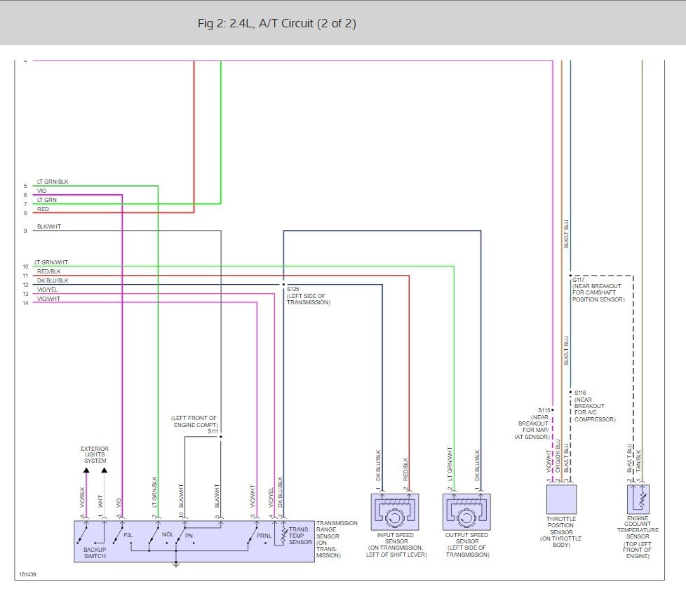

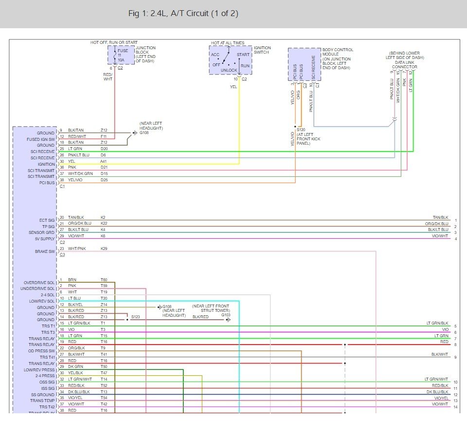

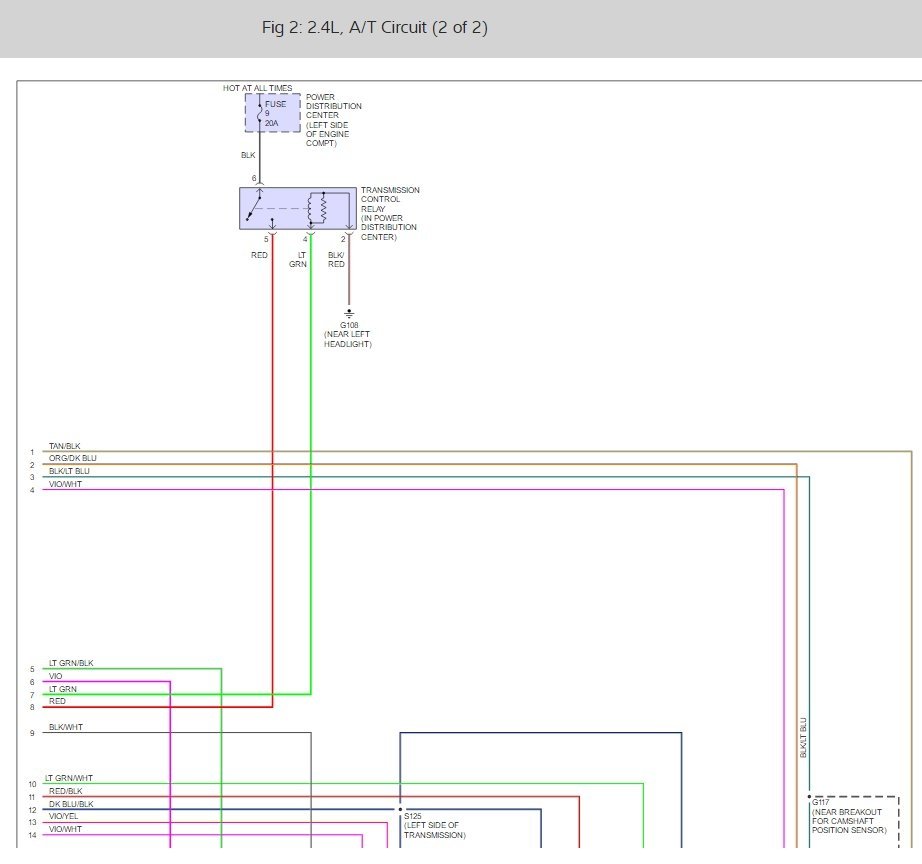

It sound like the transmission relay is not working for some reason. Here is a wiring diagram (BELOW) and a guide to ehlp you do some testing.
and
Please run some tests and get back to us so we can continue helping you.
May 24, 2017 at 6:08 AM
SLIMONTIME
  • 19 POSTS

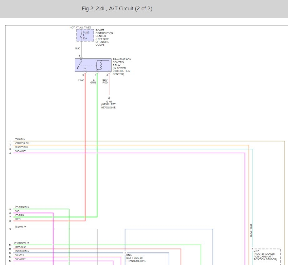

Well I did the tran relay testing. I have 12v down to the solenoid. there are no shorts that I can tell. Wiring is quite good. I cant test the pcm but am still cautious for changing it out. It just wont "talk" to that one relay. The solenoid hence is always in "limp". Could just this one thing fry the pcm? Opinions please.
May 25, 2017 at 6:08 AM
  • 55,402 POSTS
Yes the computer can be bad not triggering the relay. Can you run the codes to see if anything comes up?
Please run this test and get back to us so we can continue helping you.
May 25, 2017 at 2:03 PM
SLIMONTIME
  • 19 POSTS
po888 causing p700. I have diligently performed all wire and harness checks allok. pcm will not talk to relay, relays good. I think its the pcm shotout. Unless you have a fresh idea.... There's nothing left.
May 25, 2017 at 4:44 PM
  • 55,402 POSTS
Yep it sounds like it.
Please let us know what happens, I am interested too see what it is.
May 26, 2017 at 6:53 AM
SLIMONTIME
  • 19 POSTS
Yup, I switched out the PCM with a same yr. model and engine from boneyard. I wish I had pinned it there a month andf $400 ago LOL. Bye.
May 29, 2017 at 3:01 AM
  • 55,402 POSTS
Glad you could get it fixed, that kind of problem can be tough. Please use 2CarPros anytime we are here to help
