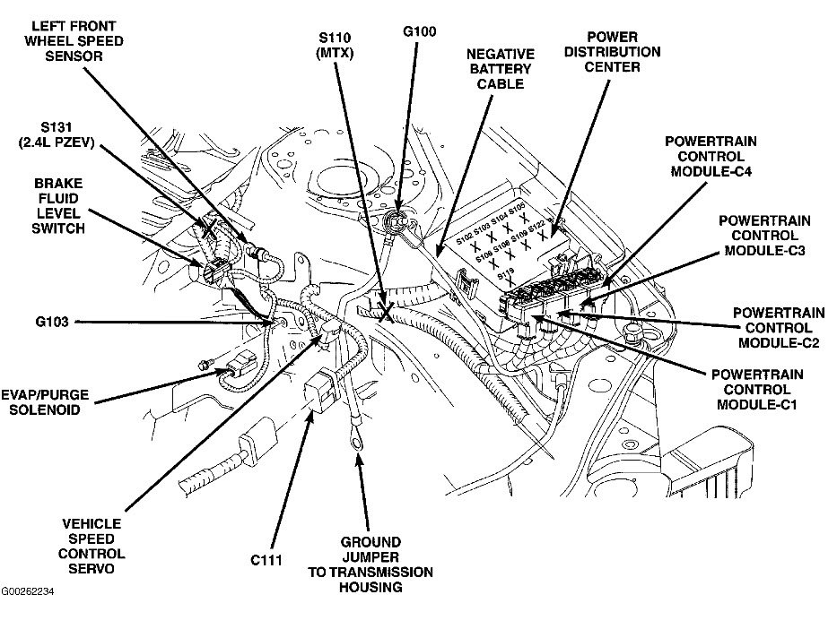

Need to know where to find the PCM. I have looked high and low for it under the hood but have not been able to find it. also, I need to know where fuel pump relay is located at as well as the pcm. I assume that I may need a new one because when I turn the key on the brake light comes on and does not turn off, but there is not a broken line anywhere and it is full of fluid

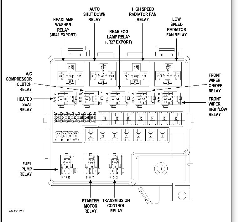

PCM is right next to PDC under hood and fuel pump relay is in pdc. See pictures.

Yup, it is attached right under the "smart" fuse box. Brake light coming on does not have anything to do with the fuel pump relay though. More likely a bad switch or shorted wire if the brakes are working properly.

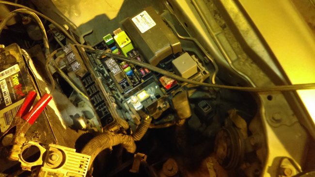

Mine does not have a PCM near the PDC, but it has a ECU in the PDC, but still cannot find fuel pump relay and cannot get power to the fuel pump unless I run a hot wire from battery to it. But, that will not do me any good if I cannot get the injectors to pulse and operate properly.

Like I said cannot find the PCM. I have taken fuse box out but cannot find it.
I have the 2.4 s.o.h.c. if that makes a difference.

Okay, your picture is the relay box of a 2004. Using that the MFI relay that controls injector power is the middle one on the left in your picture (A-18). Fuse 24 (15 amp) is the fuel pump power feed.
Pump relays one and two are in the junction block (inside car) on the right side of the block. There will be two empty spaces on top right then C-305 is fuel pump relay one then an accessory relay and C-307 is fuel pump relay two.
Staying with 2004 the PCM will be behind the glove box attached to the heater plenum.
