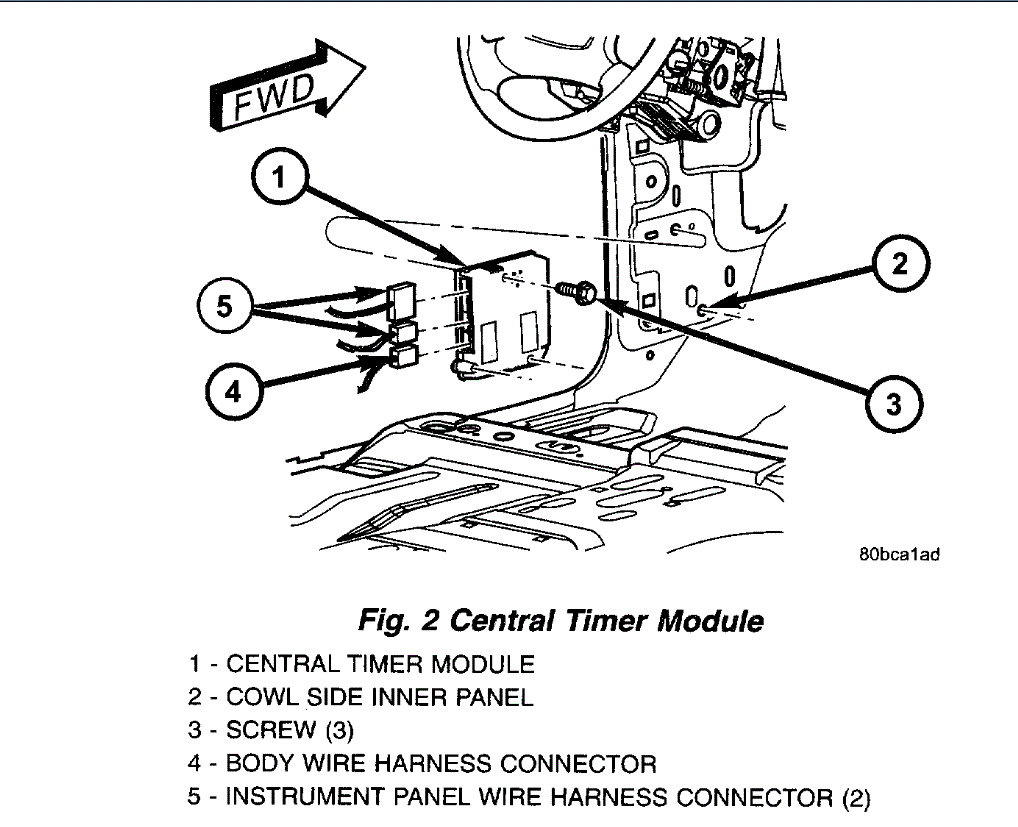

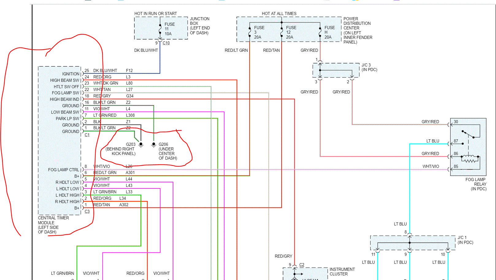

When the engine is started my headlights , running lights , digital odometer , and sometimes dome light flash off and than back on every 15 seconds.Also the warning chime does not chime. It is a very low buzz that can barely be heard. The other day my wind shield wipers twitched a little bit without touching the switch. The dome light , when i turn it on manually will flash crazy constant. All the switches work properly. The lights will only flash when i have them turned on, by the way. Please help.

That's an interesting one. I read through the wiring schematic and the only thing I found that could be related is either a bad ground under the dash or the central timer module.
The module is under the dash on the driver's side. The grounds (three wires) are also under the dash. I attached a pic for you to see what I am referring to. First, make sure the connection at the module is tight and in good condition. If it is, confirm the grounds are good as well.
Also, picture 2 shows the location of the module. And yes, the door chime is tied into this module as well.
Let me know what you find.

Sorry to say that did not work. All the grounds you suggested are good. All connections seem to be good at the module as well. Any other ideas? I really do appreciate your help.
