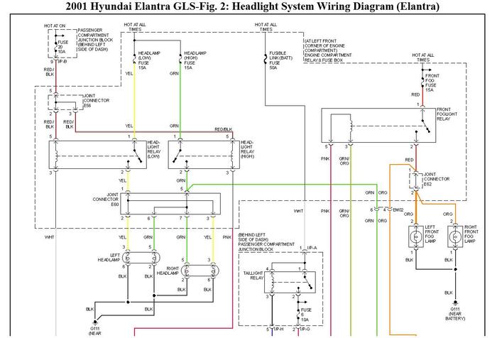

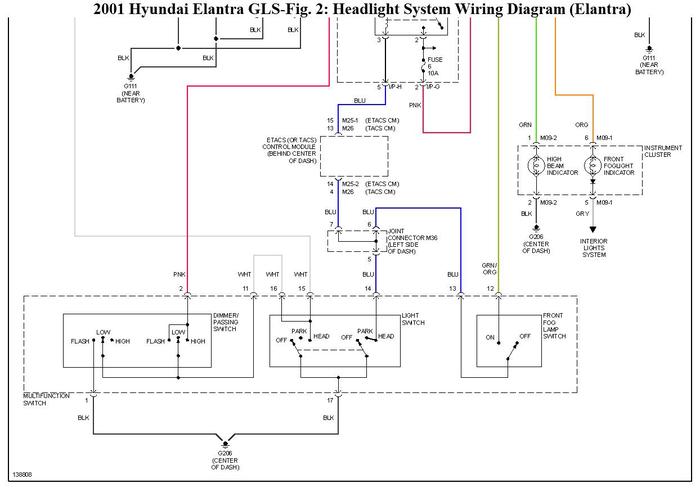

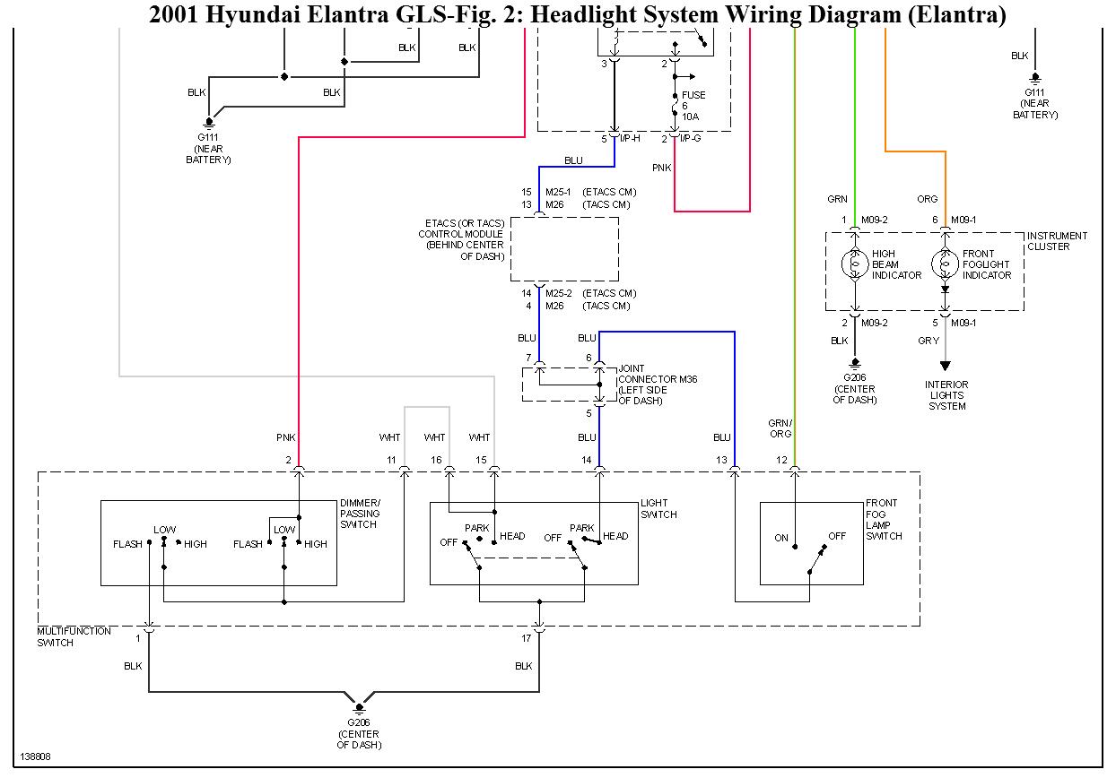

KHLOW2008
  • 41,814 POSTS
Power to the bulbs are via the headlight relays as shown in schematic. The relays are activated by the light switch and you need to check the various fuses, ensure the relays are being activated when the light switch is turned on.
Use this guide to check for power with the wiring diagrams below for the headlights.
