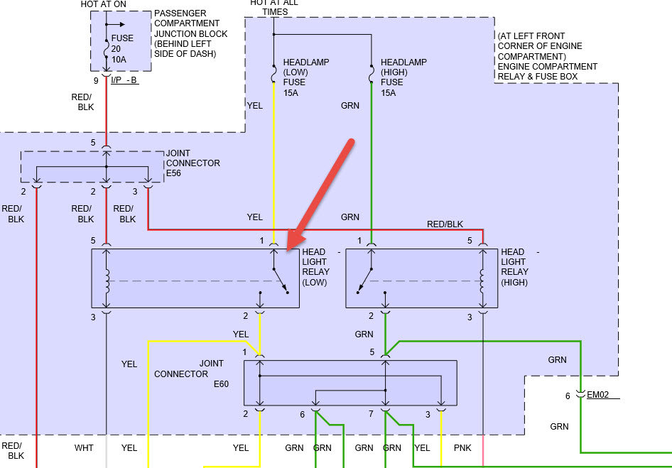

Headlights won't turn on, high beams work find. I checked all fuses.They worked fine untill yesterday. What should I check next? Maybe light switch?

Head lights won't turn on. high beams work fine checked all fuses and they are ok. what to do next? Maybe faulty light switch on steering wheel?

check the relay under hood then check the switch on steering column.
Image (Click to enlarge)
