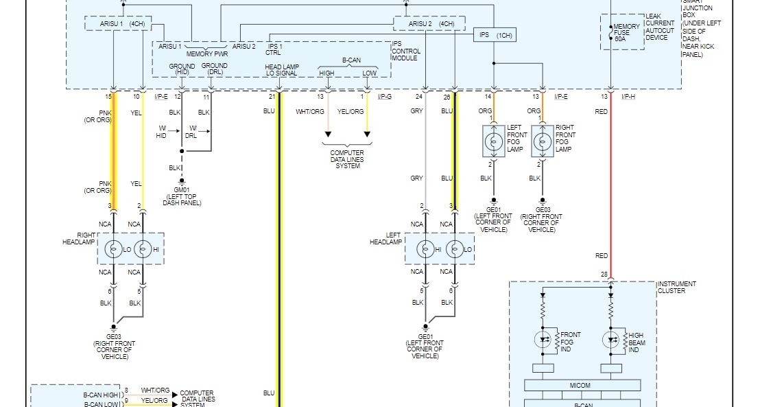

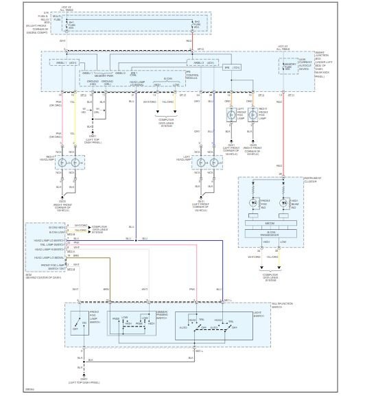

One week my headlight was burned out then following week both brake lights out and now both headlights and brake lights are out. I have checked both fuses and the bulbs only one headlight bulb is burned out. Fuses okay.
Sep 3, 2019 at 2:52 AM
Good afternoon.
The first thing I would do is check the charging system. If the alternator is putting out too much voltage, it will burn out headlights and other bulbs.
As far as the lights, have you checked for voltage to the headlights?
I attached a wiring diagram for you to view. Check the highlighted wires for power with the headlights on.
You may have a failed smart junction box.

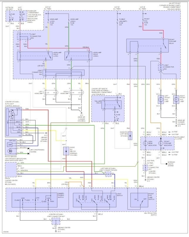

Low beams won't work. I have checked bulbs, fuses and relays to no avail. Have not checked current at bulb plug but I can hear the relay click when I turn the headlight switch on on the steering column.
Oct 10, 2020 at 12:21 PM (Merged)
HMAC300
  • 48,601 POSTS
check yellow wire at headlamp if no power have it scanned for codes there are three different types of headlights so it may be a module or switch problem.

TONY REGALADO
Already swapped relays between low and high-beams and both relays are good. Low-beam relay is clicking when I turn on the switch at the wheel. Just checked power at lamps and there is no power getting to the low-beams. Any ideas? Please help.
  • 110,240 POSTS
If you are hearing a clicking from the relay when turning the wheel, it sounds like there is a short in the steering column. You may have to remove the trim to check for damaged wires.
TONY REGALADO
Sorry, maybe I wasn't clear. I hear the relay clicking when I turn on the switch (not wheel). I have checked all the fuses and relays. Everything seems fine, but I'm not getting power to the low beams. Both lights when out at exactly the same time. Any suggestions?
KHLOW2008
  • 41,814 POSTS
Seems like there is a break in the wire between the headlight relay and headlight bulb. there is a connector in between, have that checked to ensure the terminals are not bad.
TONY REGALADO
Thanks, KHLOW. I will check that. There is an open/break from the relay to the bulb, so hopefully that's the issue.

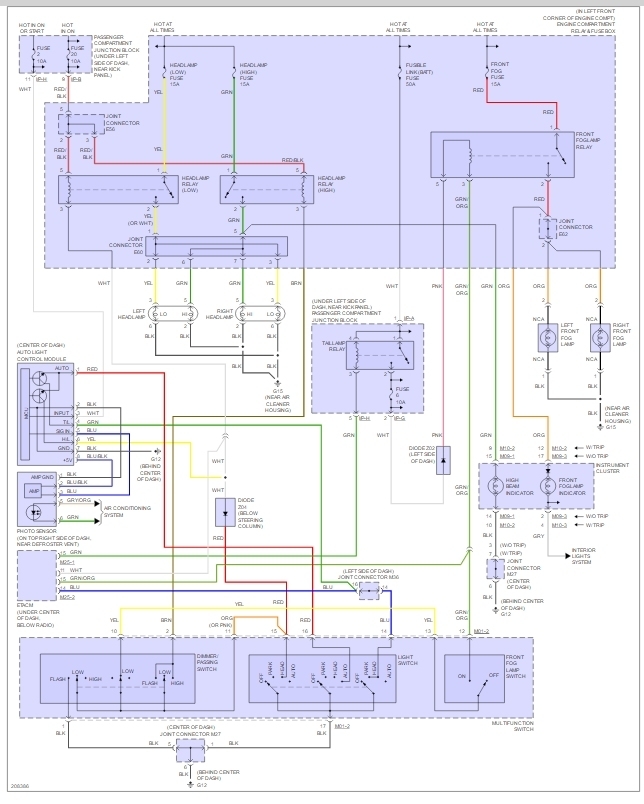

EMARSHBUCK
Four cylinder front wheel drive automatic 55,000 miles.
My low beams suddenly stopped working. My high beams work fine.
I have checked the fuses, and the bulbs.
Any ideas as to what to look at next?
Thank you,
Ed Marshall

KHLOW2008
  • 41,814 POSTS
Hi Ed,
Thank you for the donation.
Is your vehicle equipped with daytime running lights (DRL)?
Is it with Autolamps?
Check the headlamp relay in engine compartment relay and fuse box). Low and high beams uses different relays for their circuit, try swapping them to test.
Oct 10, 2020 at 12:22 PM (Merged)
EMARSHBUCK
The car does not have running lights. It does not have autolamps.
I swapped the fuses for the low and high beam with no success.
What is the headlamp "relay?"
Thank you,
Ed Marshall

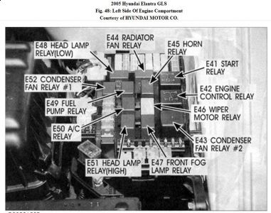

KHLOW2008
  • 41,814 POSTS
Here is a diagram of the relay box. Swap E48 and E51 and if the low beams comes on and High beam goes off, the relay is bad. If both works now, check the terminals of the low beam for looseness and signs of overheating. If none found, replace the low beam relay, it is failing and intermittently bad.

EMARSHBUCK
I swapped the low/high beam relays.
I still only have high beams.
Thoughts? Ideas?
Could there be something wrong with the on/off switch on the handle?
Thank you,
Ed Marshall
KHLOW2008
  • 41,814 POSTS
The relays swaps confirms they are in working condition.
Yes, the fault could be with the light switch.
At the light switch, ground the Red wire with a test lamp and check if the low beams comes on. If yes, the light switch is faulty. If light does not come on during this test, get an assistance to licsten for the low beam relay clicking while intermittently grounding the Red wire.
If relay clicks, the fault lies with wiring between the relay and headlamps. When you unplug the low beam relay, there must be two terminals that are hot at all times.
EMARSHBUCK
So the light switch at the end of the handle on the steering wheel post. The same handle that is used for left/right signals.
How do I get to it? Do I need to take apart the steering wheel post housing?
This sounds like maybe I need to take it to a dealership or local repair shop.
Do you think a guy w/average mechanical skills can tackle this? I use to do all my work on my VW Beetle :>) and I have a pretty decent complement of tools.
Thanks again,

KHLOW2008
  • 41,814 POSTS
A normal DIY guy should be able to handle it but if vehicle is equipped with air bags, care must be taken to avoid damage to the spring reel under the steering wheel.
You would have to remove the steering wheel and column cover to get at the light switch if it is for removal. For testing, removal of the steering column cover should do. There are a few attaching screws and after removing them, you should be able to pry the covers apart to get them out.
From there you should be able to perform the test.

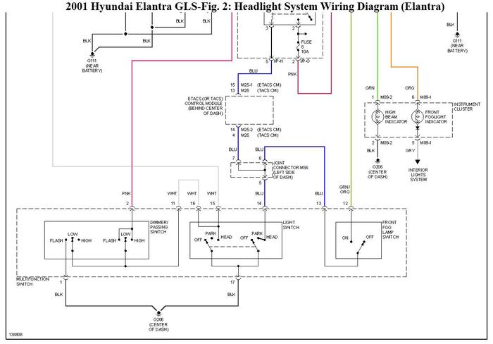

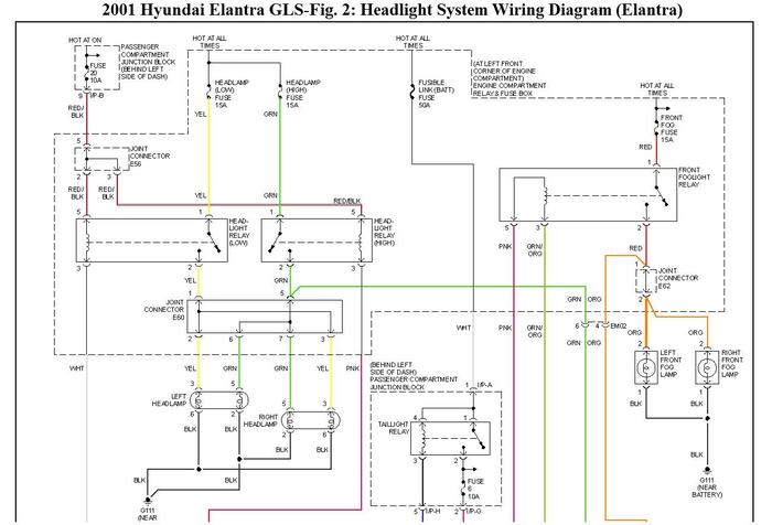

hello my high beam and low beam lights wont work. i had the fusses checked and the bulds checked and everything was good. we did find that there was no power going to the headlight. what could be the problem?
KHLOW2008
  • 41,814 POSTS
Power to the bulbs are via the headlight relays as shown in schematic. The relays are activated by the light switch and you need to check the various fuses, ensure the relays are being activated when the light switch is turned on.
Use this guide to check for power with the wiring diagrams below for the headlights.
TWOOFUS
  • 0 POST
My headlight switch needed to be replaced. fixed it
