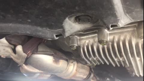

There is a leak from underneath the front of my car. At first I thought it was antifreeze/coolant; however, when I checked the coolant holder, it is full. Last night as I warmed it up for work, it started knocking, not clicking or ticking but a knock like on a door every second. Something is leaking under the front end that looks and smells to me like antifreeze. Help! Do you have any idea(s) what this might be? Thank you.

It sounds like you have a rod knock but to be sure can you please take a quick video of the problem with your phone and upload it here to the site so I can tell for sure?

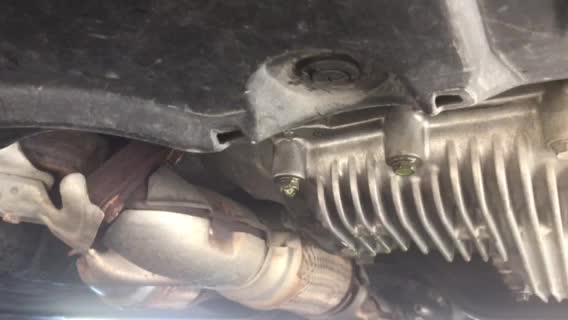

The car only had that knocking sound one night while warming up. Then it stopped. It has not done it before nor since. There is a leak, though, that looks like antifreeze. I hope that is it! What is a mystery to me is that the radiator is full as well as the antifreeze/coolant overflow container. It is with a mechanic that I know and trust now. I will upload a video for you to see.

Thanks for the video it really helps. The engine noise does not sounds too bad it would change the oil to the next heaviest weight such as 10/40, but the coolant leak should be dealt with before you have an overheating issue.

If you can upload more videos of the area both above and below I can help you see what is going on.

Thanks, Ken. I just got the car back from the mechanic. It had three leaks coolant. The hoses were good, so he replaced all the clamps because two were loose. I am interested in your reason for suggesting I use a heavier weight oil. What does that mean, and what is the reason you think I need to change oils? Thank you. P.S. Yes, I have found that instead of trying to describe noises or issues videos or pictures work wonders in helping a mechanic troubleshoot possible problems. Invariably, the noise or issue someone tries to explain is difficult at best. Are we not thankful for Smart phones? lol
