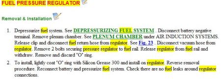

95 Discovery, no start condition, new spark plugs, wires, cap and rotor.
Cranks with sporadic combustion, typical for low fuel pressure. Fuel pump
pressure measured before filter ca.100 PSI. Fuel filter replaced. Fuel pressure
at the rail, low. I purchased fuel pressure regulator but I can not locate it.
I need info on its location and re and re procedure. Thanks Michael

HI there,
Fuel pressure regulator info.
Mark (mhpautos)
