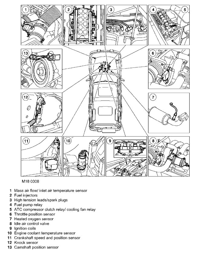

the engine will start to tick after it has warmed up in a very short time..3-5 mins, it doesnt do it while driving, that started a few days after I purchased vehichle. I had some oil leak repairs done after I started hearing the noise...it also had a hesiitation when accelerated in the beginning too. After I picked the vehichle up from the mechanic..a few days, I was idling and it just shut off, then it kept doing this within a 1 hour time frame, 3 times, then right before my destination it did it while driving. each time I would turn the truck off and wait a few minutes before trying to start it back up, it didnt take long for it to start up again, 3-4 tries,i it kept taking longer to restart each time. I have had it parked since 4-5 days and have started it each day, it has started each time. Im unsure what the problem is, I appreciate any help or advice you could give me, thank you for your time. Rodney, will donate when I receive response, thanks again. Does it sound like a lifter problem?
Dec 19, 2009 at 12:41 PM
DAVE H
  • 13,383 POSTS

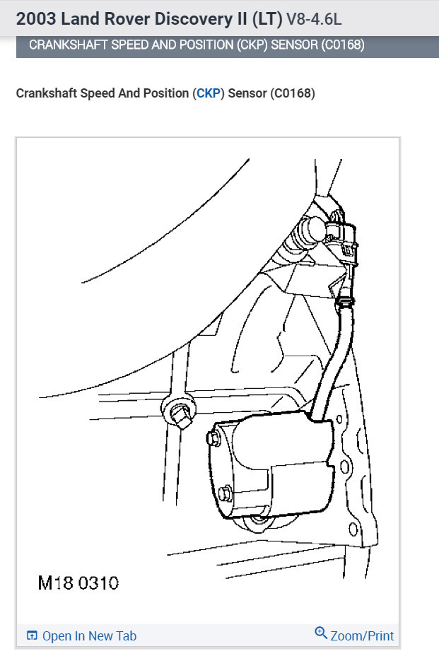

When you turn the key to the on position without cranking the engine over can you hear the fuel pump run in the tank for 5 seconds? If so it sounds like you have a crankshaft angle sensor that is not working correctly. Here is the location so you can check it out in the diagrams below. Check out the diagrams (Below). Please let us know what you find. We are interested to see what it is.
Jan 4, 2010 at 7:19 PM
TOMMY468
Yep, the crankshaft sensor connector was shot! I had to get a new pigtail and I get a new sensor since I was doing the job anyway.

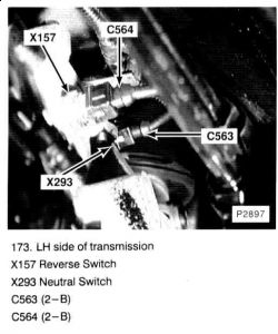

have by-passed the starter to manually start the car because it wouldnt turn over or start with the key. car turns over but wont start when by-passed and turned over manually. have changed the crank sensor and checked ignition which is working properly. ive tried to locate the diagnostic plug without any luck to see if i could get the diagnostic tool to tell me anything. it was having previous problems not starting but when put in neutral and back into park it seemed to fix the problem. now nothing, if there is any ideas you can give me on maybe solving this problem i would greatly appreciate it.
Mar 27, 2020 at 6:21 AM (Merged)
  • 75,988 POSTS
Check and test the neutral safety switch, also jumper the wiring connector and see if it cranks over
https://images.2carpros.com/forum/automotive_pictures/12900_nss_4.jpg

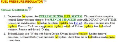

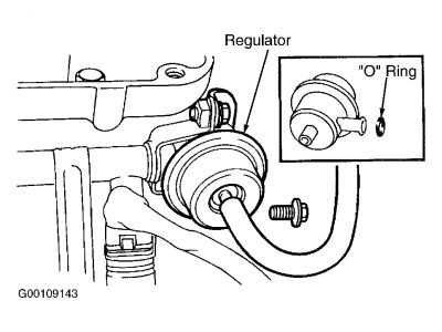

95 Discovery, no start condition, new spark plugs, wires, cap and rotor.
Cranks with sporadic combustion , typical for low fuel pressure. Fuel pump
pressure measured before filter ca.100 PSI. Fuel filter replaced. Fuel pressure
at the rail , low. I purchased fuel pressure regulator but I can not locate it.
I need info on its location and re and re procedure . Thanks Michael
MHPAUTOS
  • 31,937 POSTS
HI there, Fuel pressure regulator info. Mark (mhpautos)
https://images.2carpros.com/forum/automotive_pictures/61395_Graphic_67.jpg
https://images.2carpros.com/forum/automotive_pictures/61395_Noname_28.jpg
