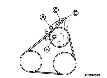

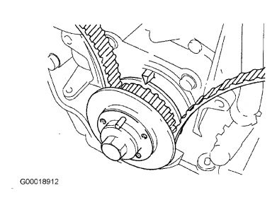

How to change the timing belt on a 2001 kia rio
Monday, October 29th, 2018 AT 6:56 PM (Merged)
  • 75,992 POSTS
Removal
Disconnect negative battery cable.
Loosen power steering lock bolts and nuts accordingly and remove tension from power steering (P/S) and/or air conditioning (A/C) compressor drive belt.
Remove P/S and/or A/C drive belt.
Loosen generator mounting bolts and adjusting bolt.
Remove generator bolts.
Remove water pump pulley.
Remove crankshaft pulley and timing belt guide plate.
Remove upper and lower timing belt covers.

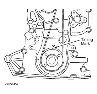

Turn crankshaft so that timing mark on timing belt pulley is aligned with timing mark on engine.
Check that "l" mark on intake camshaft pulley is aligned with mark on cylinder head cover and "E" mark on exhaust camshaft pulley is aligned with mark on cylinder head cover.
Notice : Do not move camshaft or crankshaft once timing marks have been correctly positioned.
Loosen tensioner pulley lock bolt.
Protect timing belt with a rag.
Remove tensioner pulley.
Remove timing belt.

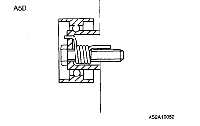

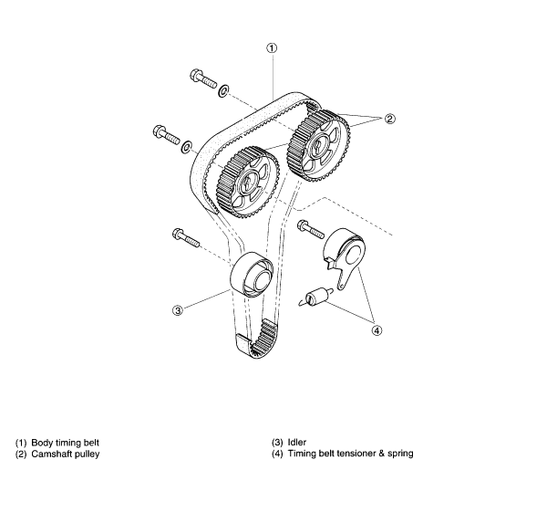

I am having a difficult time finding the timing marks for this vehicle. Please help.
Thanks,
Anne

I was told that the timing belt should be changed at 75,000 miles. In addition I was told that the water pump andtensiner should also be changed. What is the average cost of repair for the timing belt? And should these other additions be performed or are there more?
Monday, October 29th, 2018 AT 6:57 PM (Merged)
BLUELIGHTNIN6
  • 16,542 POSTS
Yes that is a good idea during timing belt replacement..
