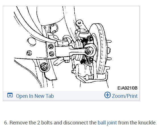

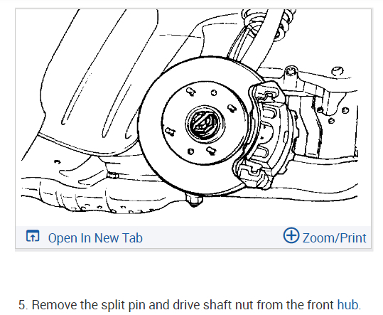

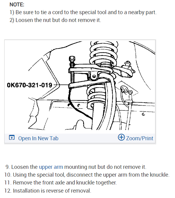

2002 Kia V6 Front Wheel Drive Automatic 94000 miles
sounds like a metal to metal sound, but i checked and pads are fine. how can i be sure what it is? front wheel bearings? if so, how do i remove and replace?

With the brakes cold, check to make sure the backing plate behind the rotor isnt touching the rotor!
Dec 1, 2007 at 5:40 AM
  • 55,616 POSTS

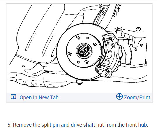

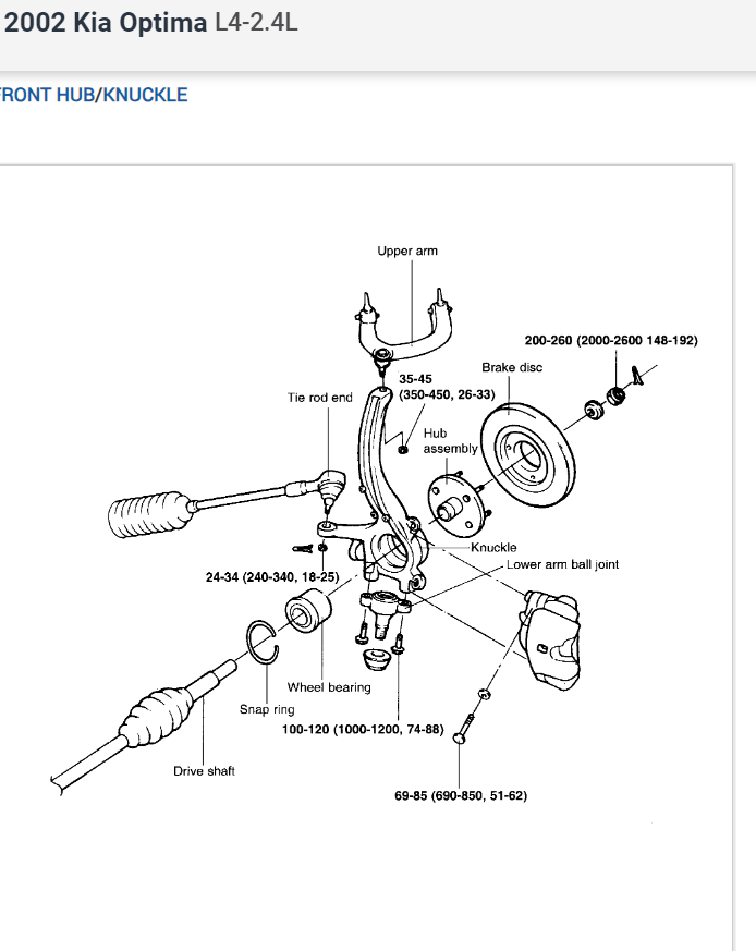

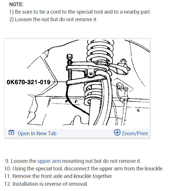

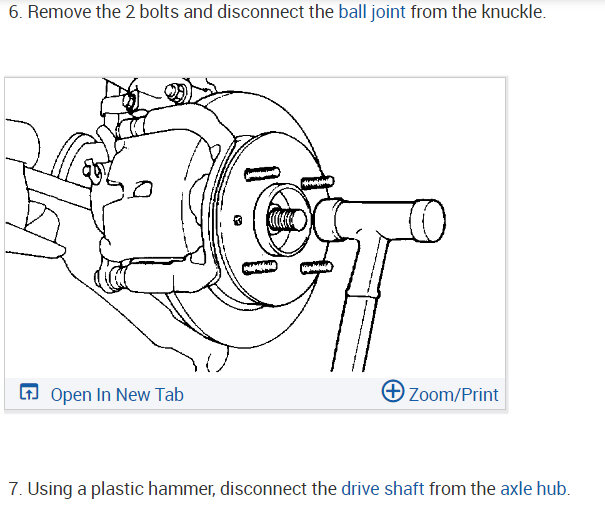

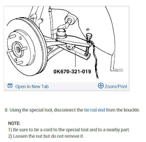

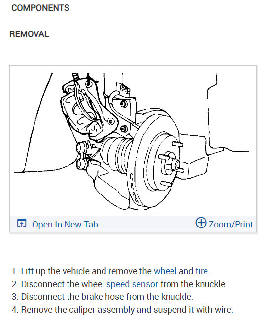

a bad wheel bearing hub can make this noise here is how to change the bearing hub out. This video shows the job being done on a similar car but the procedure is the same.
https://youtu.be/_FzmmBoa4Tg?si=g3BNE4vjaRWU8fjY
Check out the images (below). Let us know what you find.
