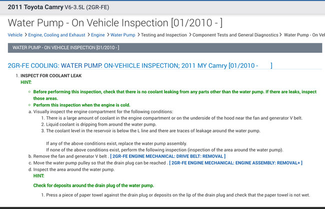

This could be a couple of different things. The first, and most obvious is the water pump is failing and needs to be replaced. The second, is that when your vehicle's thermostat was replaced, the coolant wasn't refilled properly and an air pocket is trapped in your vehicle's cooling system and is not allowing the coolant to circulate. In the diagrams down below I have included a guide from the vehicle manufacturer on how to inspect your vehicle's water pump to see if it is or has failed. Please go through this guide and get back to us with what you are able to find out.
https://www.2carpros.com/articles/engine-overheating-or-running-hot
and
https://www.2carpros.com/articles/symptoms-of-an-overheating-engine
Check out the diagrams (Below). Please let us know what you find. We are interested to see what it is.

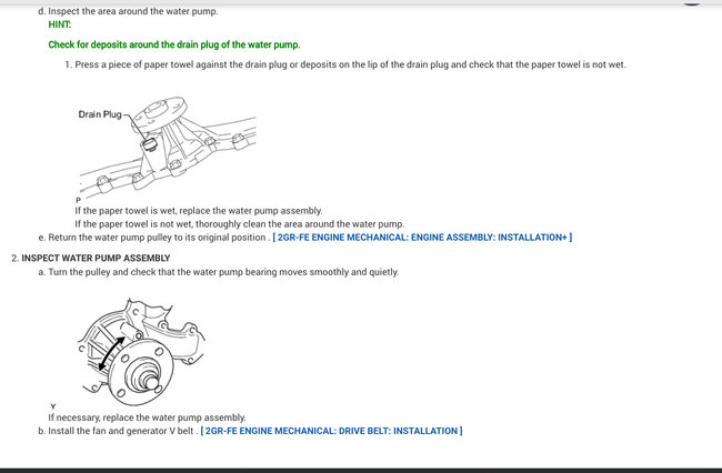

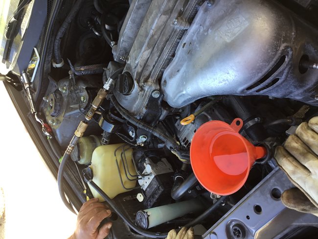

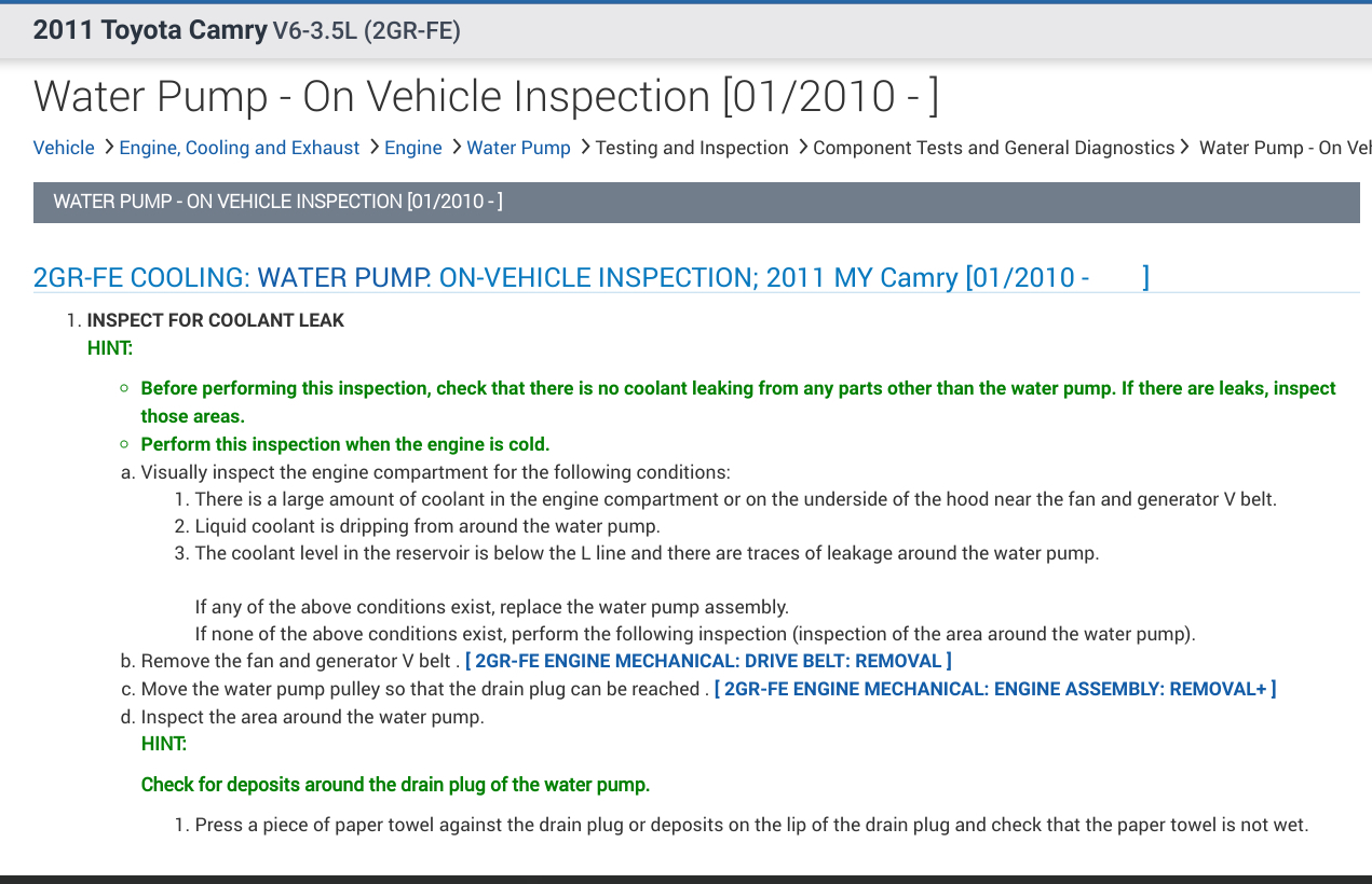

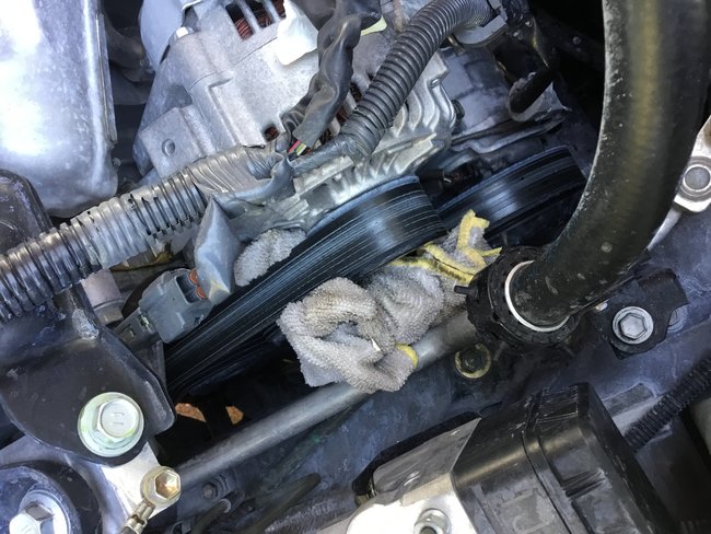

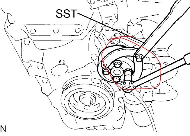

Based on your description, I really feel it is related to the water pump. They can make noise when the bearing inside goes bad and they can leak. The pump is above and to the right of the crankshaft pulley. See pic 1. I circled it in the pic. Check for leaks, see if there is any side to side play in the pulley, and make sure the belt is tight.
Also, I want you to take a look through this link. See if any of the symptoms mentioned mirror what you are experiencing.
Let me know so I can better direct you.

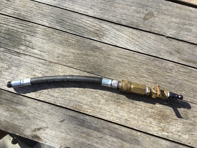

A cylinder leakage test is done with a leakdown kit. You can buy oneline prabaly amazon or where ever, but the idea is that you have the cylinder you're working on, on its compression stoke, therefore the both intake and exhaust valves are closed and sealed. That would make the cylinder at Top Dead Center. You then add compressed air to the cylinder and with the valves closed air will leak out wherever the problem is. Your compression readings are far too low for this car, by spec. The book was calling for 198psi and 142min. one thing though, are you removing all the sparkplugs when your run the compression test? and also another thing when testing, you must have the throttle plates open... so as much air as possible can get into the intake during your test. retest and see what you get. But there is definitely something going on with the cylinder head if your compression reading are that low on all cylinders. its all related. You have to have the valve's closed when doing a cylinder leakage test. or the air is just going to go out the open valve and not out the problem area. keep in touch I'm here to help you through this
