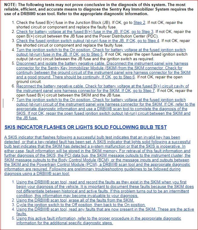

i just bought this vehicle and it won't crank with the key, but i can cross the starter out and crank it but it will only run for few seconds then cuts off. i checked all fuses and relays and connections all the gauges seem to be working. there's a flashing round light with a line through it with a key image that flashes on the dash. don't know if that might have anything to do with it or not. if someone could help me i sure appreciate it.
Jun 13, 2019 at 5:02 AM
Hi D Payne,

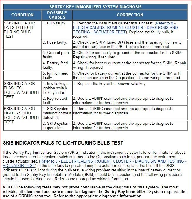

This sounds like the key is the issue or at least the SKIM system. I attached the description and diagram for this.
However, as you can see in the chart that when this light is flashing, it means the key is the issue. If you don't have a known good key then you will need a scan tool to program another key or have the system evaluated to see what is wrong with it.
This guide can help us fix it
Please run down this guide and report back. Please let me know if you have other questions. I will be happy to assist how I can.

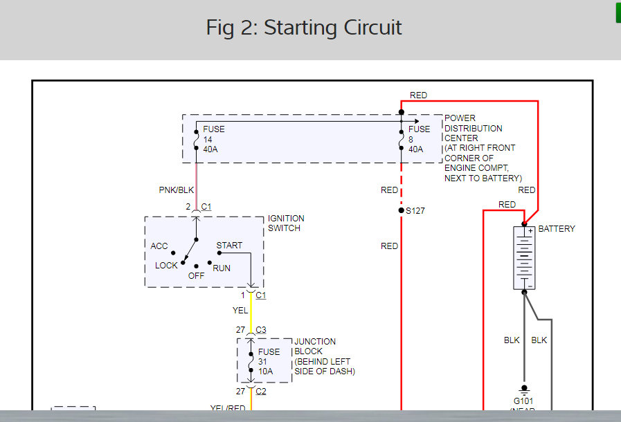

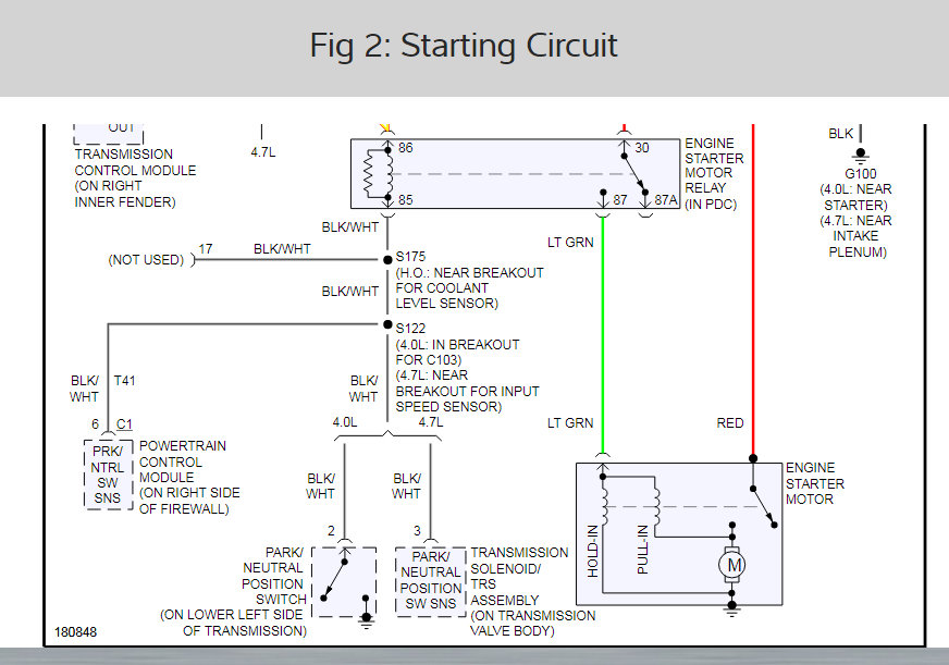

Can you try to crank the engine over with the car in neutral please? Here is a guide to help you see whats going on and the starter wiring diagrams so you can see how the system works:
Lets check the starter relay as well.

This could be a problem with your battery. Could you take a voltage reading across your battery terminals for us? You will need to use a multi-meter to do this. Here is a link for you to go to if you are unfamiliar with how to use one:
I have also included a wiring diagram of your vehicle's starting system in the diagrams down below. Please get back to us with what you are able to find out.

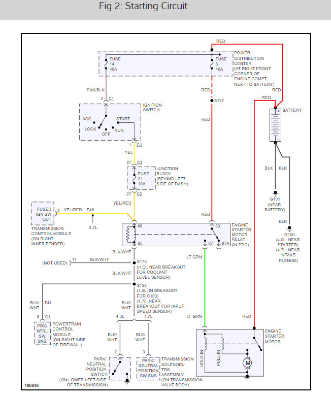

when I turn the ignition nothing happens I have no power going from ignition switch to solenoid but I can cross solenoid over and it will start right up-I changed fuse under hood and changed starter relay under the hood and still will not start by turning the key. I put a wire in park neutral switch to by pass it and still will not start by turning the key. can you help me out please when I turn the key on dash lights up and radio plays, windows work, it just will not turn over of the key.

like most Chrysler products the start system goes through the TPIM module which can be bad and a mechanic will have to scan for codes for that as auto parts cannot scan TPIM modules.

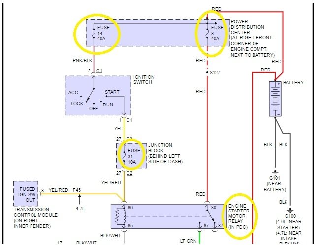

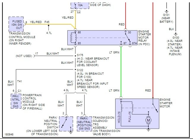

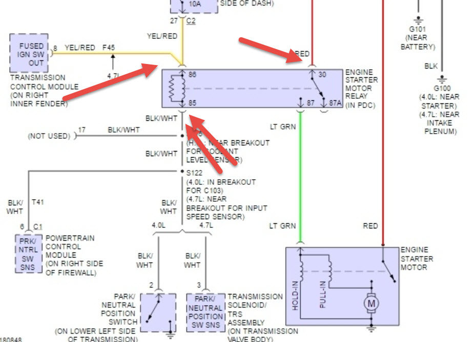

I screenshot your Starting System diagram in "Prodemand"
It took two shots, I insured they overlapped.
I circled, in yellow, some other things you might check out
Let us know how it is going.
Two diagrams below
The Medic

if you have no power going to solenoid and can jump it to start check neutral switch in CJ's drawing or the relay may be bad which you can quickly check by swapping another relay from PDC.

I swapped out relay did not help and put wire in park neutral switch to by pass it still did not crank over with the key. thanks for helping.
Aug 31, 2020 at 5:37 AM (Merged)
HMAC300
  • 48,601 POSTS
then check wire leading from ignition switch for power the switch may be the problem then.
FLYNN-T
  • 35 POSTS
this is what I am thinking; I put a test light on the small wire from ignition to solenoid and when I turn the key to crank I have no power. is there another way I can check my ignition switch without taking it all apart? and I hear a click coming from around the dash board by glove box when I turn the key to crank the engine, but still does not crank.
HMAC300
  • 48,601 POSTS

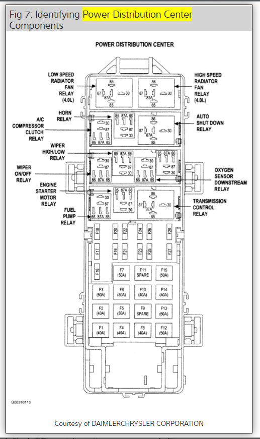

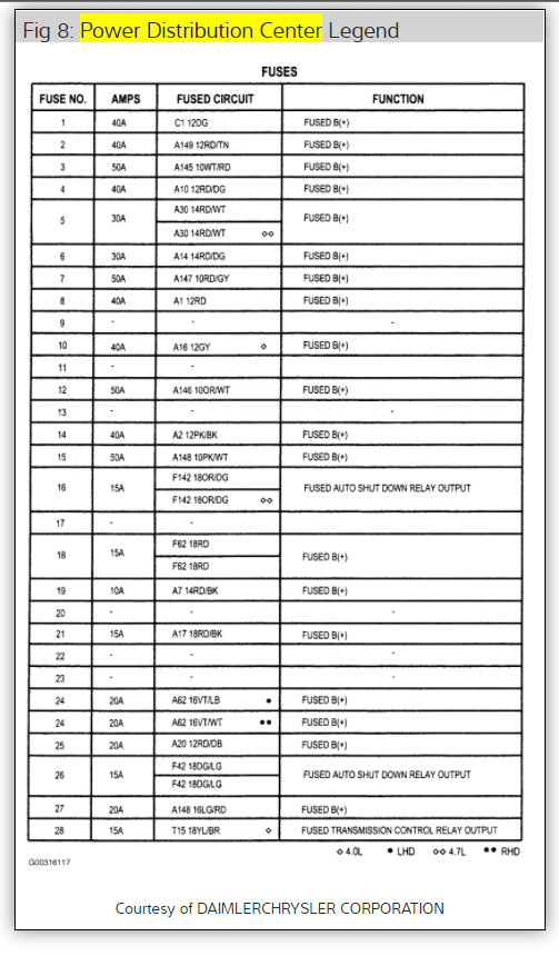

get your test light and where single arrows are see if you have power with key on in those sockets. then where double arrow is have someone turn the key to start and see if that has power. it may be corrosion on relay or a PDC problem. I think the click you hear in dash is from the power-train module telling truck to start. you will need the relay out to check this and you can correspond with the the numbers which should be on bottom of relay. if you get power on all positions except where I have not marked it. It may be a fuse box problem or corrosion and it is not making good contact with relay. You may correct this by tweaking that one prong just a tad and cleaning any or all corrosion off as well as using dielectric grease on prongs for better contact. If there still is no power at unmarked position then it is either the fuse box is bad or the wire leading to starter has broken someplace which you can check with an ohm meter. i am also sending on how to check a relay along in link.
MAXIMILIAM
  • 436 POSTS
It was my actuator pin in my ignition-thank you very much-now I see my fuel tank skid plate is in very bad shape will it pass safety inspection if I put a couple of adjusting straps under my gas tank secured to the frame on each end thanks
