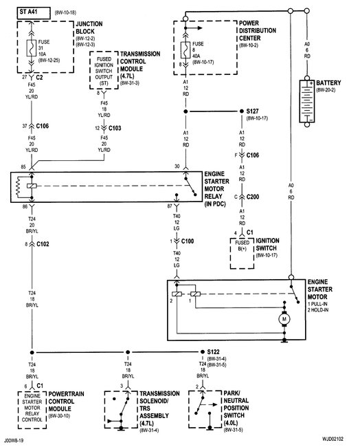

My vehicle will not start in the morning. It has a brand new battery and starter. When I turn the key the dash lights come on, but I cannot even here a click of the starter solenoid. So I bum a ride to and from work and when I get home the Jeep magically starts up like nothing is wrong. Has done this three times to me. Temperatures in the morning are about sixty four degrees and when I get home around seventy five degrees. Nothing that I believe should even affect it, but its just too weird how its depending on the time of day. I got under the Jeep (when working) to see if the large power wire is hot and it showed 12.45 volts which is the exact same reading I get at the positive battery terminal. The smaller signal wire going to the solenoid had 12.40 volts. Could this be an intermittent starter relay perhaps? Does this vehicle have a neutral safety switch? I have read online some people say yes some say no. Some say its inside the transmission and is not accessible. How can I find what the true problem is and regain my confidence to take this thing camping again?

Looks like you are on the right track. Check those same wires when it will not start. If it does not start and you get battery voltage at solenoid wire then your starter is defective. If no power then check your starter relay.

That relay that JIS001 referred to is in the "power distribution center". Swap it with an unimportant exact twin as a test.
