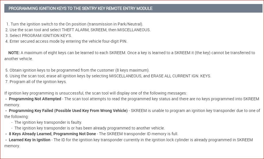

DAVRLAW
  • 5 POSTS
My battery went flat. I changed the battery and now the car won’t start. The red immobilizer dot is on when the car is locked. Then when I unlock it with the key it goes off then when I try to start it the red immobilizer dot comes back on.
I have taken it to two mechanics, one auto electrician and they haven’t been able to work it out.
Please help!!!
Thanks in advance!
Aug 31, 2020 at 5:35 AM (Merged)
You should have codes in the system. I am going to guess you have a code for "invalid key." If this is the case then you may need to program new keys or replace the SKREEM module.
I attached the process for programming keys but you will need a scan tool. Most likely you will need new keys because once a key is programmed it cannot be reprogrammed.
I am not sure what happened because if all that happened was you replaced the battery, it should save key information but the light staying on when you put the key in the ignition is telling you that the key you tried to start the vehicle with is not valid.
There could also be an issue with the actual module but the codes in the system will help with this. So let's start there before you replace keys. If you had someone look at it, hopefully they pulled the codes and provided them to you. If not, I am sure they recorded them somewhere so you can just call them and ask what they were. Once you have them, let me know what they are and we can get this figured out. Thanks

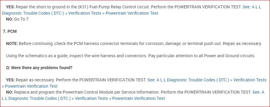

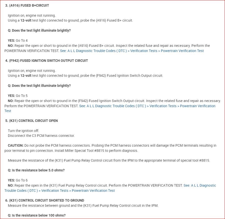

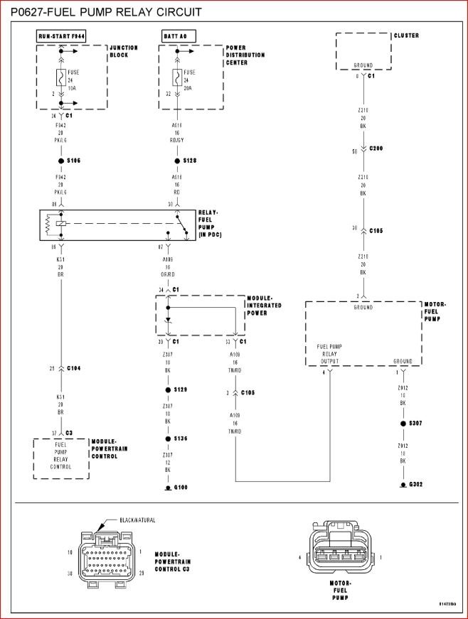

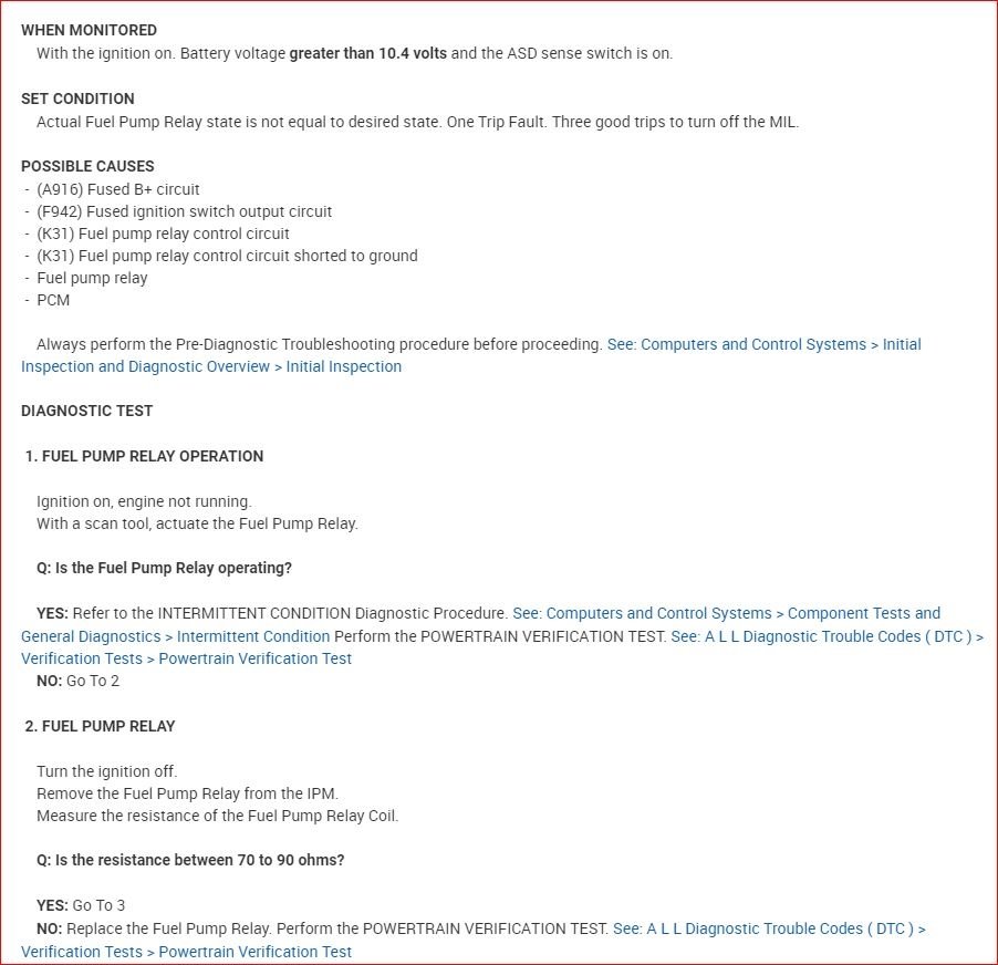

DAVRLAW
  • 5 POSTS
Also, I’d like to add that when it happened the engine wouldn’t even attempt to turn over (it made no sound when the key was turned) it went through two mechanics and that never changed. Then after the third mechanic returned the car to me it now attempts to turn over which i find odd.
Okay. This code is for a fuel pump circuit issue. This is pretty straight forward electrical diagnosis so I am not sure the level of mechanic you were taking this to but I find it odd that three different ones didn't know how to fix this.
Did they make any repairs or replace any parts?
I included the diagnosis for this code and I think I understand what happened. The first two mechanics had to disarm the security system after the battery was replaced and if they didn't then it would not turn over or do anything when you turn the key. The third guy appears to have done this. Now you have an issue with the fuel pump relay, wiring, ignition switch output, or possibly the PCM.
This test will take you through testing each of these circuits.
Here is a guide on how to check wiring like this:
If you do not want to diagnosis this yourself, I would suggest calling ahead to a shop and ask if they have someone that is confident in diagnosing electrical fuel pump issues. Unfortunately, as you have found, not all mechanics understand how these electrical systems work.
Let me know if you need more assistance or the results of each of these tests and I can help figure out the issue. Thanks

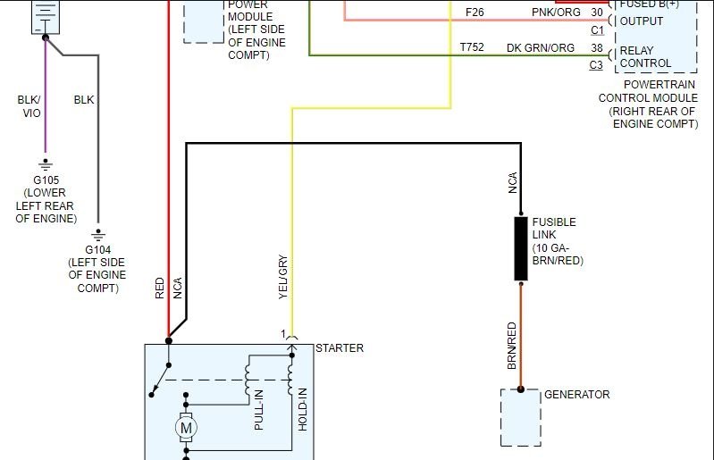

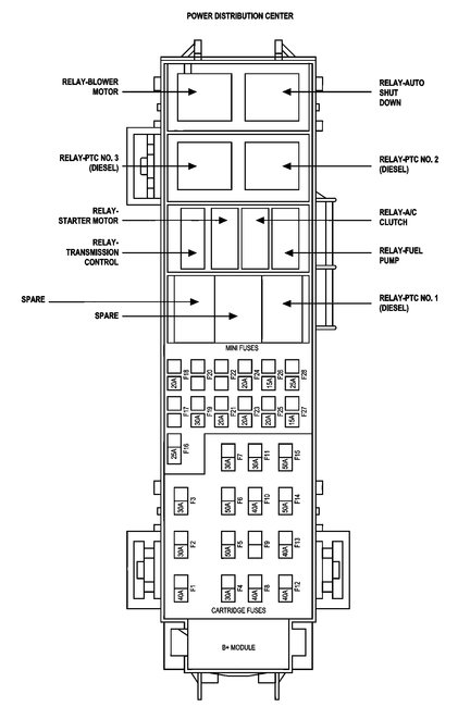

  • 110,244 POSTS
First, check the starter relay in the power distribution box under the hood. See picture 1 for relay location. You can simply switch it with a different relay with the same part number to see if that changed things or here is a link for testing a relay.
Here are a few links that may help you with checking wiring and electrical components:
If the relay checks good, confirm fuses 10 and 20 in the power distribution box to confirm one isn't bad. Here are links that show how to test them:

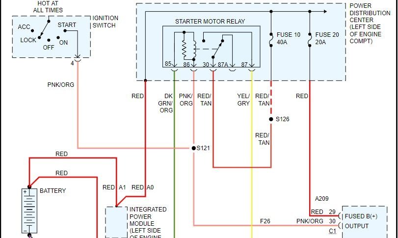

Next, if the fuse is good, I then need you to check for power to the smaller wire on the starter. You will need a helper. Follow the directions in this link:
Now, if you do have power to the smaller wire when the key is in the start position, and the larger wire (which should always have 12 volts) is making good contact and has power, then the starter is bad.
If there is no power, then we need to start checking where power is lost. I attached a wiring schematic of the starting system. I had to cut it in half to fit it. Pictures 2 and 3 are the schematic and I overlapped it so you could follow it.
Follow the yellow wire back from the starter. It goes to pin 87 of the relay. You will need to probe that wire to see if power is available. If there is, check that wire for a break or damage. If there is no power, check pin 30, a read wire for power. If there is, the relay is bad. If no power, follow it back to the totally integrated power module (a red wire on the left of the schematic) You need to check for power there. NOTE: the integrated power modules are know for the pins breaking on the connector. So pay attention for that.
I hope this helps and doesn't confuse things. Let me know if you have other questions or need help.
