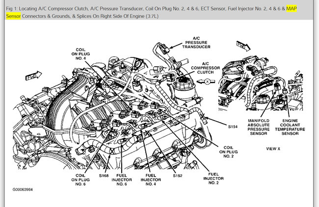

Where is the MAF sensor located? I checked from the filter box along the duct work right up to the throttle body, I can't see the sensor. I asked for the location of the maf sensor, 2003 Jeep Liberty 3.7 liter. I checked for the sensor and I still can't find it. Could you please send me a diagram of it's location

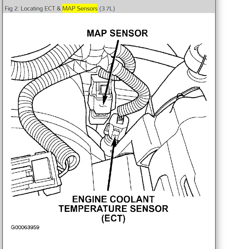

This car does not have a MAF sensor it uses a MAP sensor which is located in the intake manifold. Check out the diagrams (Below). Please let us know if you need anything else to get the problem fixed.

The 2003 Jeep Liberty 3.7 does not have a MAF sensor. Locate the MAP sensor on the intake manifold instead.
