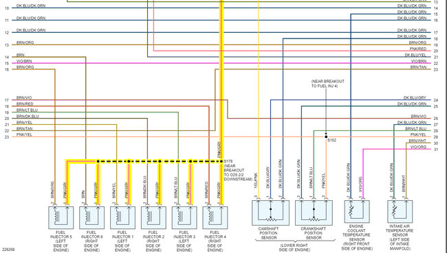

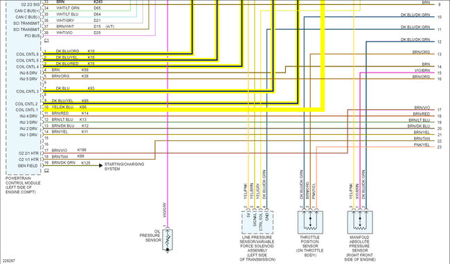

I need a wiring diagram for the fuel injectors from power source to ECM with pin number and location on the ECM for the vehicle listed above Special Edition.

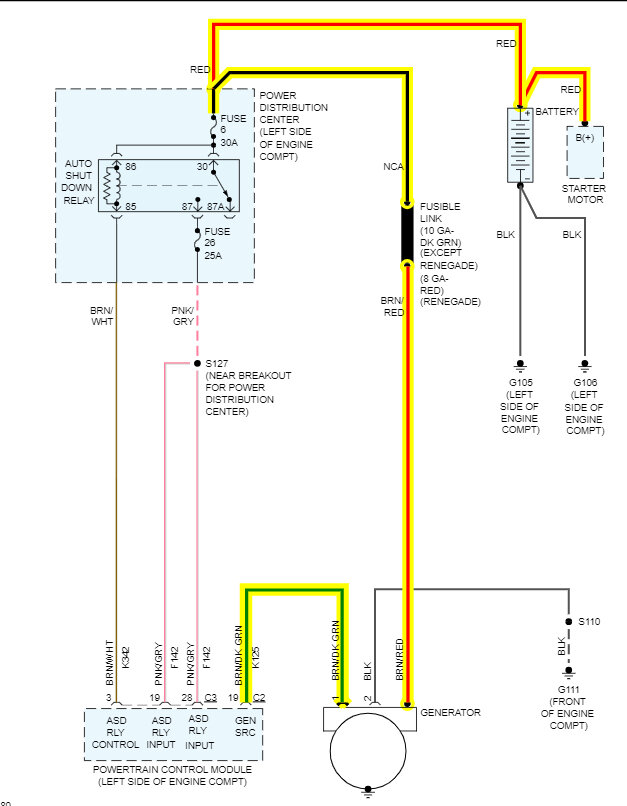

Also, I need the charging system wiring diagram from battery to alternator back to the ECM pin with ECM pin location.

Hello, I will get these diagrams together for you. What type of situation are you dealing with?

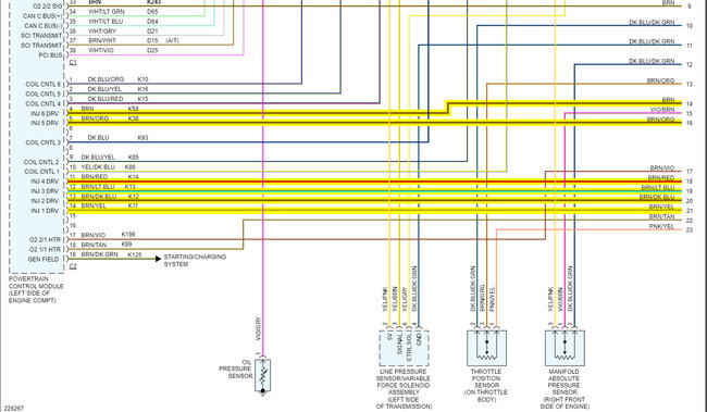

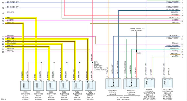

Diagram 1 is the power feed to the fuel injectors; Diagrams 2,3 are the Fuel injector control wires to the PCM.

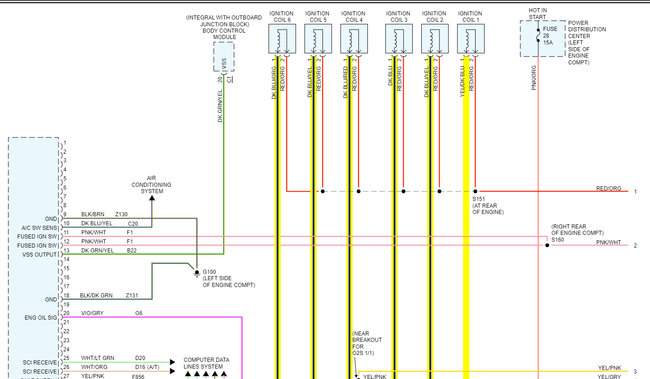

Diagrams 4,5 are the Ignition Coils control wires, just put them in case you need them.
The 6th diagram is the Charging system to the Battery and PCM.

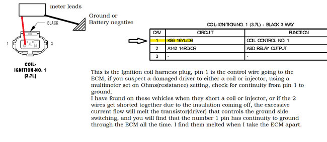

Okay, I just dealt with this same exact vehicle recently and I'll explain what happens with these, but first what codes are you getting? And did you find fuel injector wiring actually burned up or was it just old and falling apart? I can give you some multimeter tests that can help you verify if any ECM drivers have been damaged. These vehicles have just a 2-wire coil setup and when a coil shorts out or is over worked to the point it overheats, and only being 1 power wire and 1 wire to the ECM which controls the ground side, a shorted coil most of the time burns out the driver inside the ECM.
The flashing MIL light means that Catalytic converter misfires are occurring. There are different levels of cylinder misfires, but when the MIL is flashing it's time to turn the engine off. Give me a list of all the codes you have had so far.

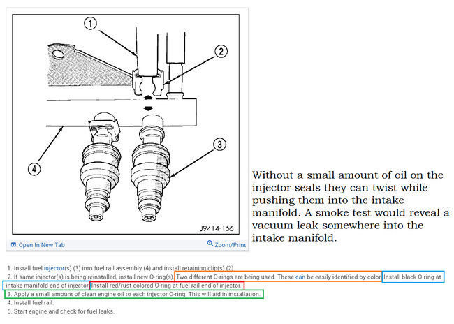

And did you have the high idle issue before you replaced the fuel injectors? If the injector seals did not seat properly, they can cause a vacuum leak into the intake manifold and hence a high idle like that.

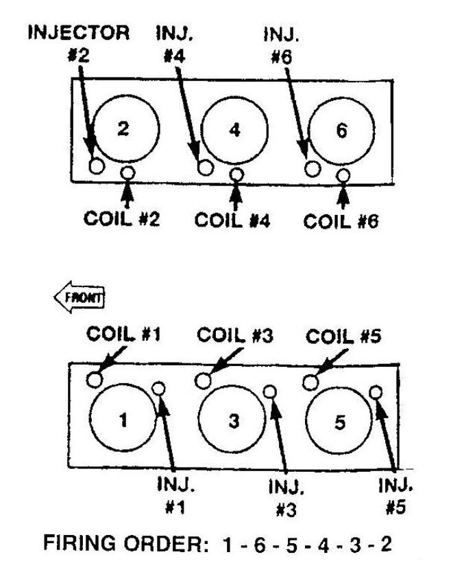

Here is the firing order so you can find the suspect cylinder and a continuity test to ground on the control wire of either an ignition coil or fuel injector control wire. Most of the time I find these have continuity to ground through the ECM because the transistor melts and shorts out.
This can happen to coils if the fuel injectors are not firing or are staying on too long over fueling the cylinder. A lack of fuel causes the coils to become overworked and overheated. Too much fuel causes cylinder misfires but also causes too much raw fuel down the exhaust and can melt the Catalytic converter restricting the exhaust, and it just gets worse from there on.
https://www.2carpros.com/articles/engine-idles-too-high
