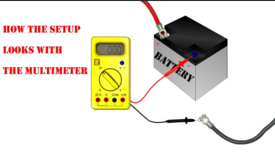

To check for this, we need to do what is called a parasitic drain test. You do this by disconnecting the negative battery cable and connect the red meter lead of your voltage meter to the battery post and the other to the negative cable.
Take a look at the diagram below for how to set this up.
Then set your meter to amps and it should read less than .035 amps (35 milliamps) with all the doors closed and the hood light/latch disconnected. If it is higher than we need to remove fuses until it drops and that will tell us what system is remaining on when the vehicle is off.
