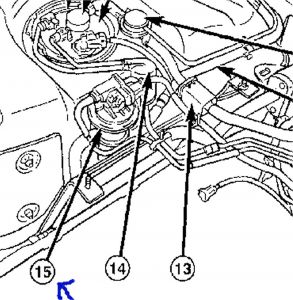

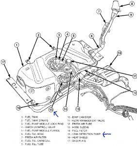

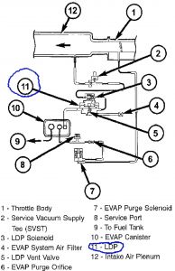

Hard to say what your hearing, but my first thought is the evaporative system that controls the fuel vapors. The The LDP (leak detection pump) does in fact pressurize the fuel tank. However if there is a leak, it should set the check engine light. This is the diagram of the system:
https://images.2carpros.com/forum/automotive_pictures/30961_ldp_1.jpg
The LDP is highlighted. This is the above view of the system:
https://images.2carpros.com/forum/automotive_pictures/30961_ldp2_1.jpg
And a close up:
https://images.2carpros.com/forum/automotive_pictures/30961_ldp3_1.jpg

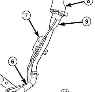

What we don't know is if this is sucking or blowing air? Maybe it is sucking from the fresh air filter up by the neck?
https://images.2carpros.com/forum/automotive_pictures/30961_ldp4_1.jpg
#7 is the filter.

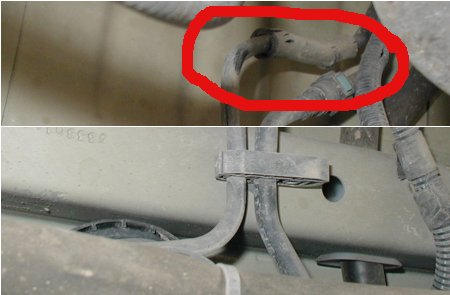

Hi everyone, I have the same problem, the hissing noise and found where it's coming from...but I don't know what it is to replace it. I've circled it here in red. It's a hose coming out of the LDP, and in between that hose and another, there's a black "connector" that is cracked on both ends. When I cover the cracks with my thumb, the hissing all but stops. If you look at the images uploaded by ServiceWriter, 3rd image, the hose coming out of the LDP on the left near the arrow for #15, follow that to the right and you'll see the "connector". Anyone know what that "connector" is called? Thanks! Tim
https://images.2carpros.com/forum/automotive_pictures/75348_P3260116crop_1.jpg
Mar 26, 2008 at 5:14 AM
SERVICE WRITER
  • 9,123 POSTS
I don't know the name of it, but half the time with things of this nature the description leaves much to be desired.
However, by stopping at the dealer and askeing to look at an exploded view at the parts department, they can work with you to point out the particular leaker. This will be a dealer part.
