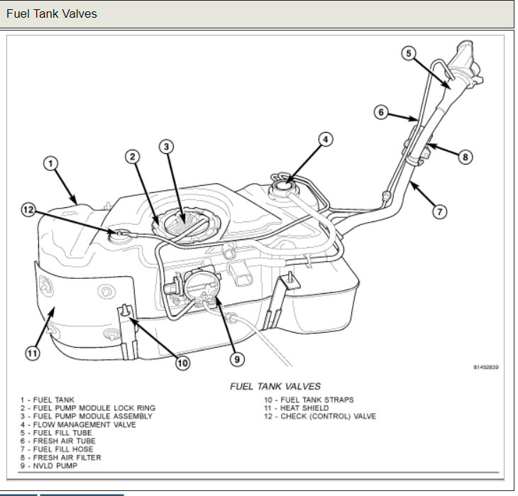

I'm having trouble getting fuel into the tank. Checked the flow valve and it works find. Could a venting problem cause this

This happens when the filler tube collapse which happens when the car is in heated weather and the EVAP system vacuums the tank. Here is a guide to help you see what you are in for when replacing the filler tube.

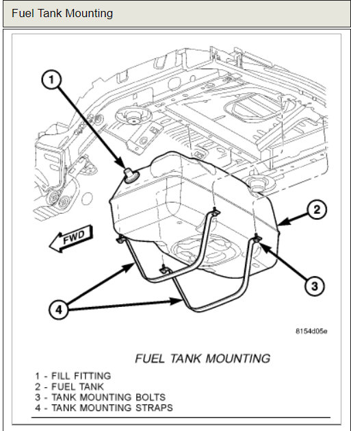

You may need to loosen the tank and let it down a little.

Yep that was the problem I had the job done for $160.00 and it works great thanks for the repair advice. I love this site.
