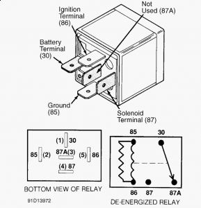

Then, it happened again, this time neutral didn't work. I played with the relays and it started.
Then it happened again, this time the relays made no difference. I just had to wait and try it periodically. Then it started.
Still thinking it was the relays, I replaced the fuel pump relay and the ASD relay. I also replaced the Throttle Positioning Sensor just for kicks.

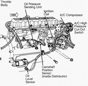

Is your check engine light on? If yes turn the key from off to on three times, on the fourth one leave it in the on position, count the flasshes...22 would flash as 2 blinks, then a short puase, then 2 more blinks...if several codes are stored, the pause is longer between codes, code 55 will be the last code...do this and post all codes found... Could be a fauly connection to the crank or cam sensor, or PCM. Or a fulty crank, cam, or PCM...Crank sensor is on the bell housing left side and cam sensor is inside the distributor.

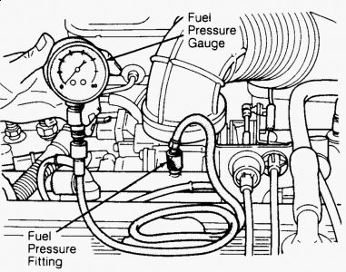

FUEL SYSTEM FUEL DELIVERY Fuel System Pressure Release Procedure 1. Disconnect negative battery cable. Slowly open fuel tank cap to release fuel tank pressure. Remove protective cap from pressure test port on fuel rail. 2. Using Fuel Pressure Gauge Tool Set (5069), obtain fuel pressure gauge and hose assembly. Remove gauge from hose. Place gauge end of hose in approved gasoline container. Place shop towel under test port. Screw other end of hose onto fuel pressure test port. Release fuel pressure. After pressure is released, remove hose from test port. Install protective cap on pressure test port. 3. If gauge tool set is not available, perform step 1). Using a small screwdriver, wrapped in shop towels, push test port valve in to relieve fuel pressure. Absorb spilled fuel with shop towels. Remove shop towels and dispose properly. Install protective cap on pressure test port. Fuel System Pressure Test 1. Remove cap from pressure fitting in fuel rail. See Fig. 1 . Using a shop towel to absorb any spilled fuel, connect a 0-60 psi (0-4.22 kg/cm 2 ) fuel pressure gauge to pressure fitting on fuel rail. Disconnect vacuum hose from fuel pressure regulator. Start engine. Fig. 1: Testing Fuel System Pressure Courtesy of CHRYSLER CORP. 2. Pressure should be approximately 39 psi (2.74 kg/cm 2 ) with vacuum hose disconnected and 31 psi (2.18 kg/cm 2 ) with vacuum hose connected to fuel pressure regulator. 3. If fuel pressure is not 8-10 psi (.56-.70 kg/cm 2 ) higher with vacuum hose disconnected from fuel pressure regulator, inspect vacuum hose for blockage, leaks, kinks or other damage. If vacuum hose is okay, replace fuel pressure regulator. 4. If fuel pressure exceeds 45 psi (3.1 kg/cm 2 ), check fuel return line for kinks or blockage. If fuel pressure is low, release fuel system pressure. See FUEL SYSTEM PRESSURE RELEASE PROCEDURE heading above. Disconnect fuel return line on fuel rail near fuel pressure regulator. Connect 5/16" fuel hose between disconnected fuel return line and fuel rail. NOTE: Always relieve fuel pressure before disconnecting any fuel injection- related component. Also see appropriate fuel delivery system or fuel injector control circuit tests in G - 2.5L & 4.0L TESTS W/ CODES article in this section. CAUTION: Fuel pressure will rise as high as 100 psi (6.9 kg/cm 2 ) when fuel return line is pinched off. Ensure connections are properly secured. DO NOT pinch off hose for longer than 5 5. Restart vehicle and let engine idle. Momentarily pinch off hose connected to fuel return line. Note fuel gauge pressure reading. Pressure should rise to approximately 75 psi (5.2 kg/cm 2 ) within 2 seconds. 6. If fuel pressure rises as specified, pressure is operating at maximum capacity and is correct. If fuel pressure does not rise as specified, turn engine off. Release fuel system pressure. See FUEL SYSTEM PRESSURE RELEASE PROCEDURE heading above. Raise and support vehicle. Disconnect fuel supply line at inlet (fuel tank side) of fuel filter. Connect 3/8" fuel hose between fuel filter and fuel supply line. 7. Restart vehicle and let engine idle. Momentarily pinch off hose connected to fuel supply line. Note fuel pressure gauge reading. Pressure should rise to approximately 75 psi (5.2 kg/cm 2 ) within 2 seconds. If fuel pressure rises as specified, but pressure is not same at fuel rail, check for plugged or restricted fuel filter. Also check fuel supply line between fuel filter and fuel rail for kinks or blockage. Fuel Pressure Leak-Down Test 1. Remove cap from pressure fitting on fuel rail. See Fig. 1 . Connect a 0-100 psi (0-6.9 kg/cm 2 ) fuel pressure gauge to pressure fitting on fuel rail. Start and run engine at idle. 2. Turn engine off and note fuel pressure gauge reading. Leave fuel pressure gauge connected. Allow 30 minutes to elapse and then compare fuel pressure gauge reading to reading taken when engine was turned off. 3. A pressure drop up to 20 psi (1.4 kg/cm 2 ) within 30 minutes is within specification. If pressure drop is not within specification, go to next step. If pressure drop is within specification, the fuel pump outlet check valve and fuel pressure regulator are operating correctly. 4. Release fuel system pressure. See FUEL SYSTEM PRESSURE RELEASE PROCEDURE heading above. Disconnect both fuel lines at fuel rail near fuel pressure regulator. Connect 3/8" fuel hose between disconnected fuel supply line and fuel rail. Connect 5/16" fuel hose between disconnected fuel return line and fuel rail. 5. Start engine and record fuel pressure gauge reading. Turn engine off. Pinch off hose connected to fuel return line. Allow 30 minutes to elapse. If pressure drop is within specification, go to next step. A pressure drop of more than 20 psi (1.4 kg/cm 2 ) within 30 minutes indicates pressure is bleeding past fuel pump outlet check valve. Replace fuel pump assembly, located in fuel tank. 6. Pinch off hose connected to fuel supply line. Allow 30 minutes to elapse. A pressure drop of more than 20 psi (1.4 kg/cm 2 ) within 30 minutes indicates pressure is bleeding past fuel pressure regulator. Replace fuel pressure regulator. Fuel Pump Capacity Test 1. Release fuel system pressure. See FUEL SYSTEM PRESSURE RELEASE PROCEDURE heading above. Disconnect fuel supply line at fuel rail near fuel pressure regulator. Connect 3/8" fuel hose to disconnected fuel supply line. Insert other end of hose into approved gasoline container. Start engine. Check fuel pump flow rate (capacity). 2. A good fuel pump will deliver at least 1.05 qts. (1.0L) of fuel per minute with return line hose seconds. pinched off. If fuel pump capacity is incorrect, inspect fuel supply system for a plugged filter or plugged fuel pump inlet filter. Fuel Pump Relay Some relays have battery voltage connected to terminal No. 30. Others have battery voltage connected to terminals No. 87 or 87A. See Fig. 3 . In de-energized position, relay should have continuity between terminals No. 87A and No. 30. Resistance value between terminals No. 85 and No. 86 should be 70-80 ohms for resistor type relays, or 81-91 ohms for diode type relays. FUEL CONTROL Fuel Injectors Disconnect injector from wiring harness. Connect ohmmeter on injector terminals. Resistance should be about 13.3-15.7 ohms at 68 °F (20 °C). 1/30/2010 ...

Cam sensor and ignition switch need testing too, cam sensor controls injector timing. Ignition supplies power!

11= No reference signal from Crank sensor
12= Battery power lost/disconnected within last 50 starts. Start with the crank sensor, mounted on the tranny bellhousing. Check Battery/ and cables, possibly the ignition switch.
