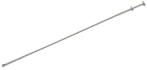

STEVE W.
  • 13,465 POSTS
I cheat a bit. Visit a place that sells office supplies. Buy a small pack of blu tack type temporary adhesive. It's the stuff they sell to stick up items on walls boards where you want to remove it easily. Sort of like a really sticky gum. Put some on the bracket and some on the bolt and stick them in place. Another handy item for these type jobs are those long handled metal fingered grippers.

BROTHER BUZZ
  • 31 POSTS
Last week I got the blu-tac, great stuff, I couldn't afford the tool, so I got a curtain rod/bent it a little / blue -tac together / went over the top back by the tranny cross member / over the linkages / got it over the hole / turned the rod to the right angle and dropped right / I didn't
