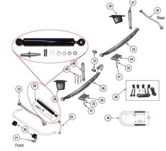

You need to jack up the front end and shake the wheels for play, if it doesn't make sense I'll walk you through it. Is this a grand Cherokee?.......They had problems with the steering dampners, It HAS to be replaced with a Heavy Duty one......Not standard.
