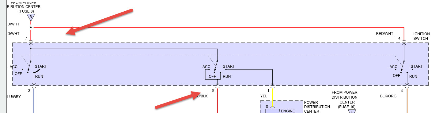

Our car keeps randomly shutting off. I very sure it is the ignition switch connector the wires coming out of the connector two of them I burnt up and really corroded. I think it is numbers 7 and 6 I am trying to figure out where the wires go so I can rewire them.
Thursday, June 18th, 2020 AT 10:38 AM (Merged)
HMAC300
  • 48,601 POSTS
Seven comes from PDC and six goes to junction block also check harness at rear of engine by stud on head it wears through there and causes multiple problems.
