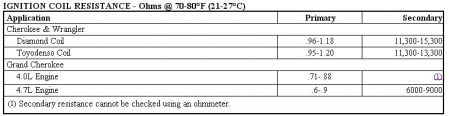

Check coil pack resistance.

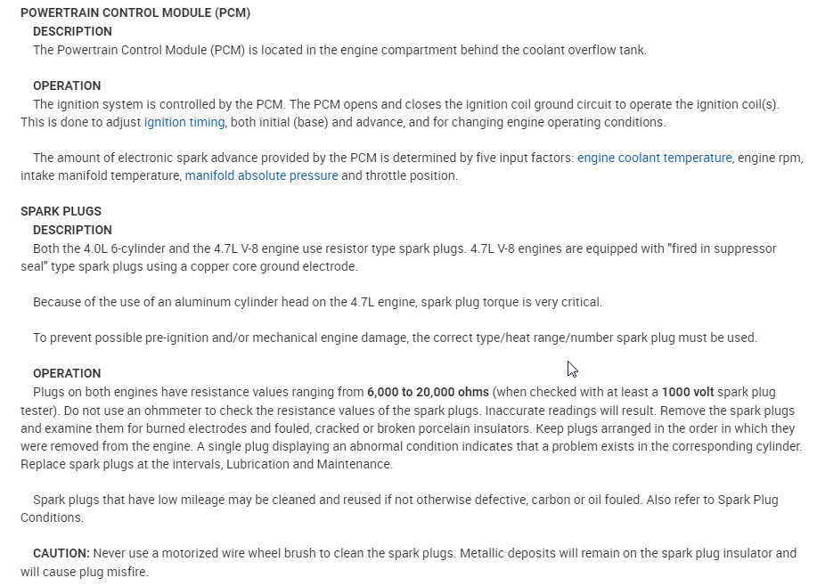

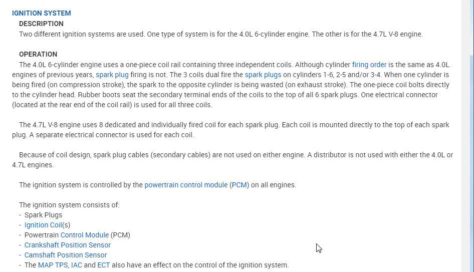

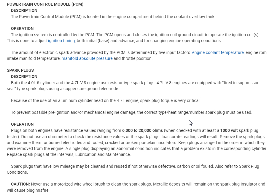

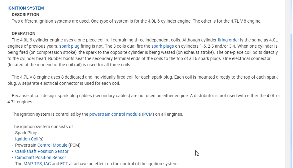

Hi Joan,
You said in the vehicle description that you have a Jeep Cherokee with a 4.7L. I am going to assume you meant you have a Grand Cherokee because the Cherokee did not have a 4.7L. This is normally not a big deal but in this case it could be the difference in what the issue is, so I just want to make sure that is correct.
The cam and crank sensor in the 4.7L are what are called Hall Effect sensors. These sensors are susceptible to heat and will actually start to fail when they get hot.
If you haven't changed your spark plugs since you past 100,000 miles, I would go ahead and replace them and the cam and crank sensor. Then retest the issue.
Let me know what you find and we can go from there. Thanks
