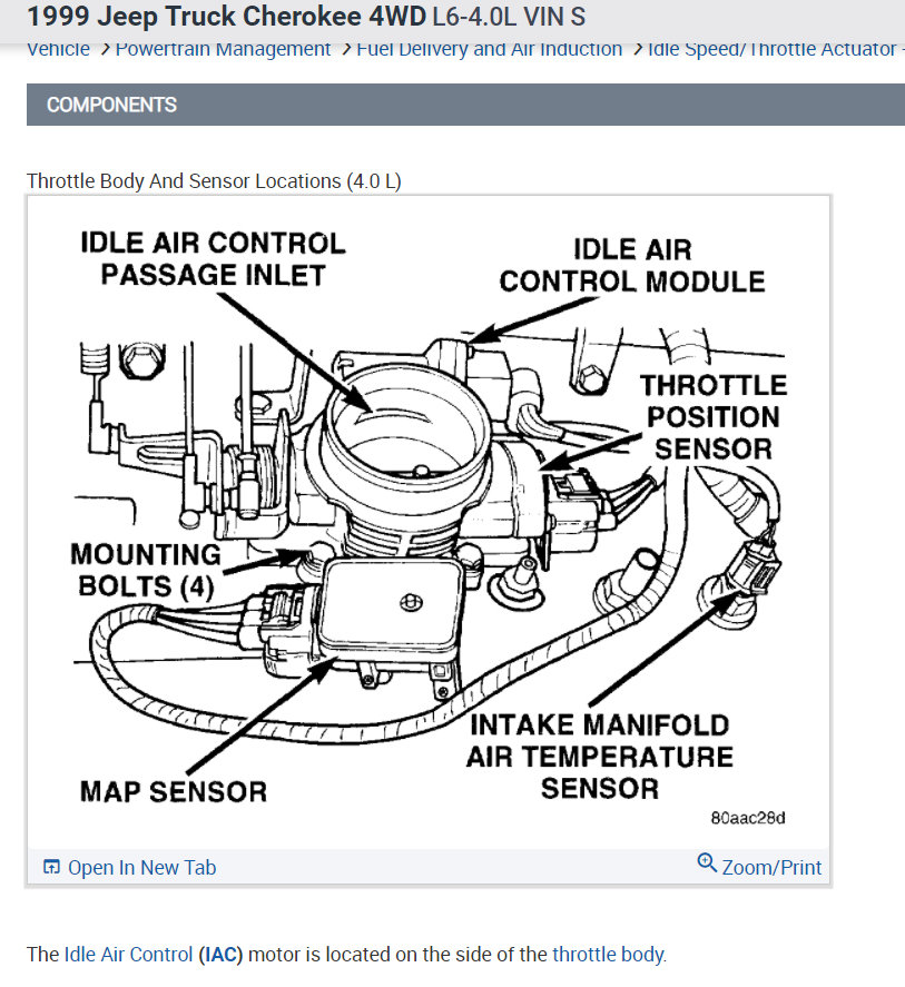

Clean out the Idle air control valve,and this guide can help us
https://www.2carpros.com/articles/idle-air-control-valve-service
Here is the valve location for your car.
Oct 15, 2020 at 11:14 AM (Merged)
HURLJ6731
thank you so much the IAC was so dirty! all clean now and running great! this site rocks I cant believe it is free.

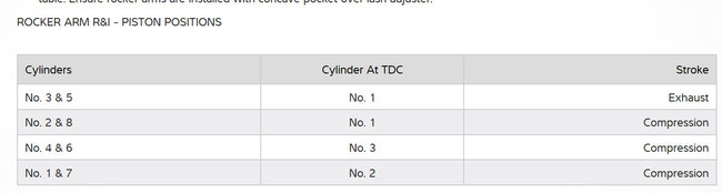

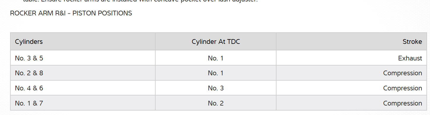

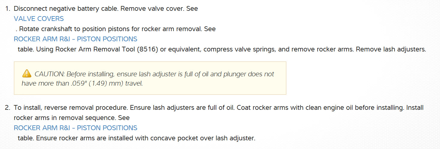

It is hard to start, you constantly have to keep giving it gas for it to stay running. The mechanic did a pressure test and cylinder six tested at 26, but rocker arm fell off and was laying inside. all the other cylinders tested between 125-130. I know I have to put this back on, but I think my problem may be a little more. The mechanic said he do not know much about working on valves, and just did the pressure test, but I do not know why he did not just put a rocker on it. So now I am stuck trying to find out the problem. I put in a new lash adjuster for that cylinder and bought a new rocker arm. Guess I should get rocker arm first. Any help or suggestions.
I watched tons of YouTube videos, but it is not as easy as they make it appear to be, I could not just pop it on like they did. It is an overhead cam also.
Thanks in advance!
Oct 15, 2020 at 11:15 AM (Merged)
HMAC300
  • CERTIFIED EXPERT
  • 48,601 POSTS
you need a special tool to compress spring so you can put the rocker back on and make sure hydraulic lifter is full of oil . also so you do not bend a valve you need to go to chart and make sure corresponding cylinder is put to top dead center before you install. we have no pictures of tool it is Chrysler 8516 so maybe auto parts may have similar to rent. See pictures.

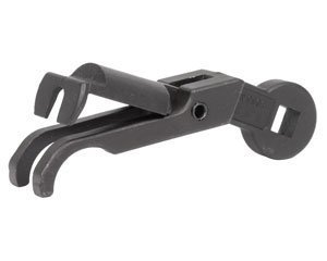

This is what the tool looks like, you don't just "pop" the rocker on as HMAC says you need to compress the valve spring.
