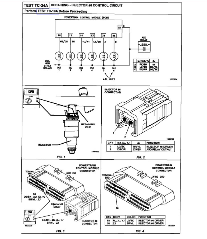

XJBASKETCASE13
  • 8 POSTS
  • 1993 JEEP CHEROKEE
  • 4.0L
  • 6 CYL
  • 4WD
  • MANUAL
  • 170,405 MILES

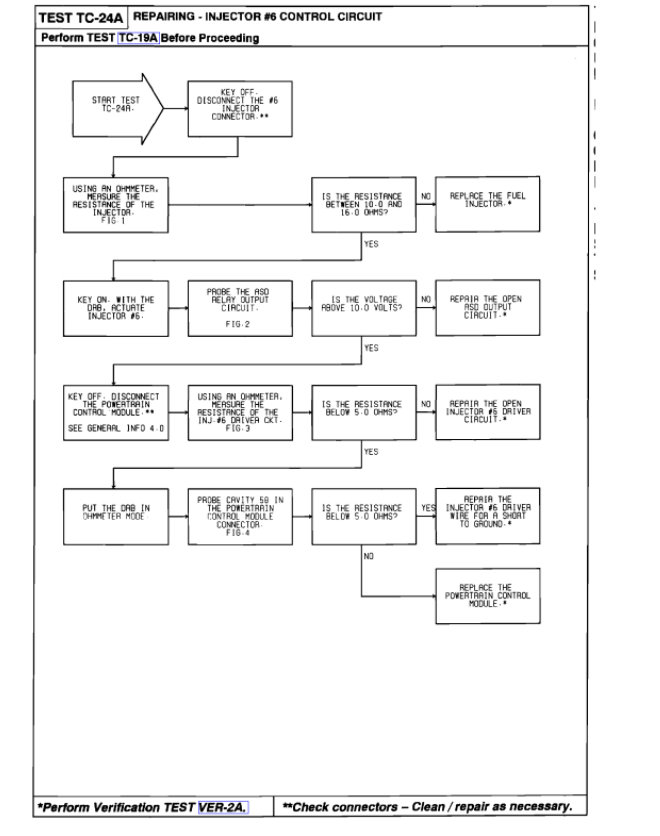

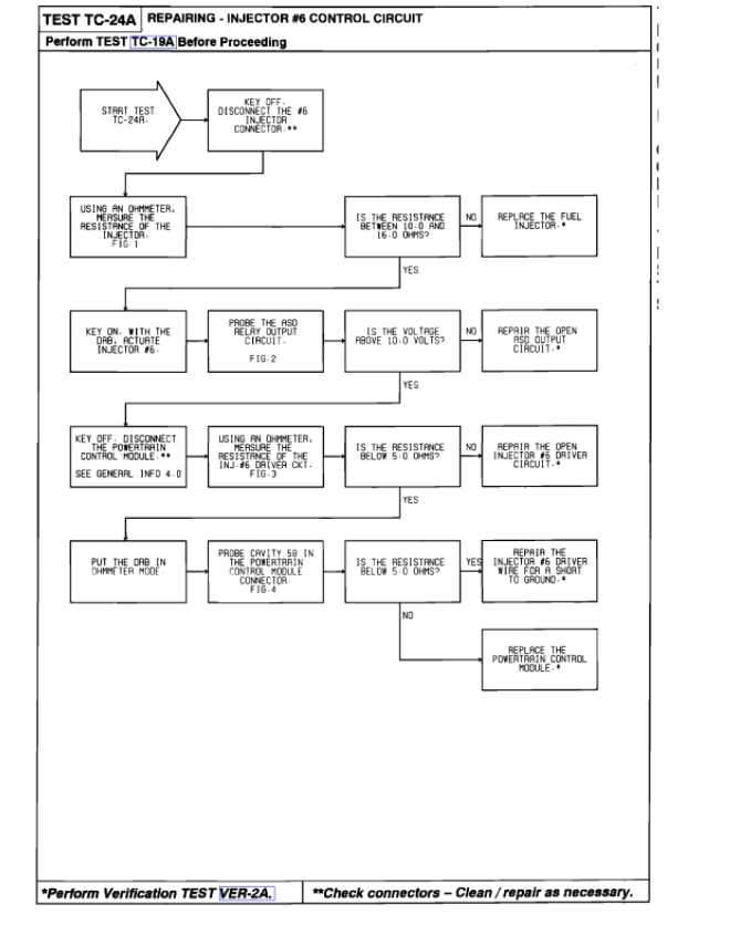

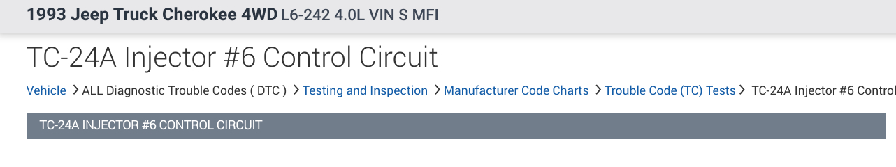

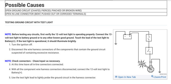

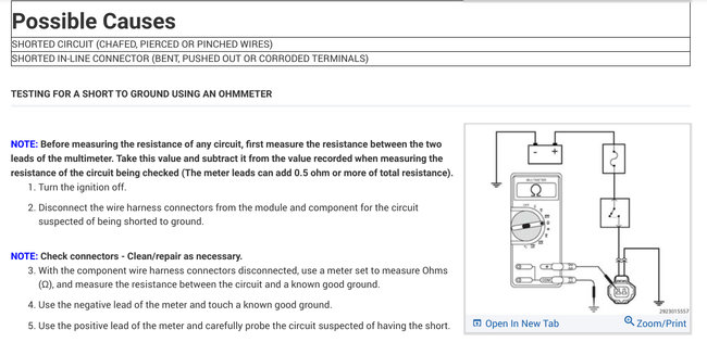

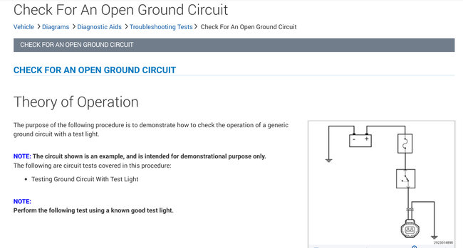

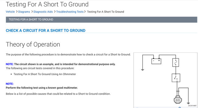

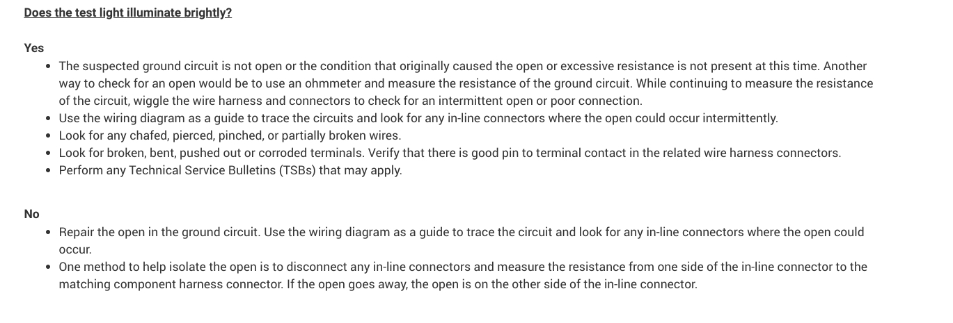

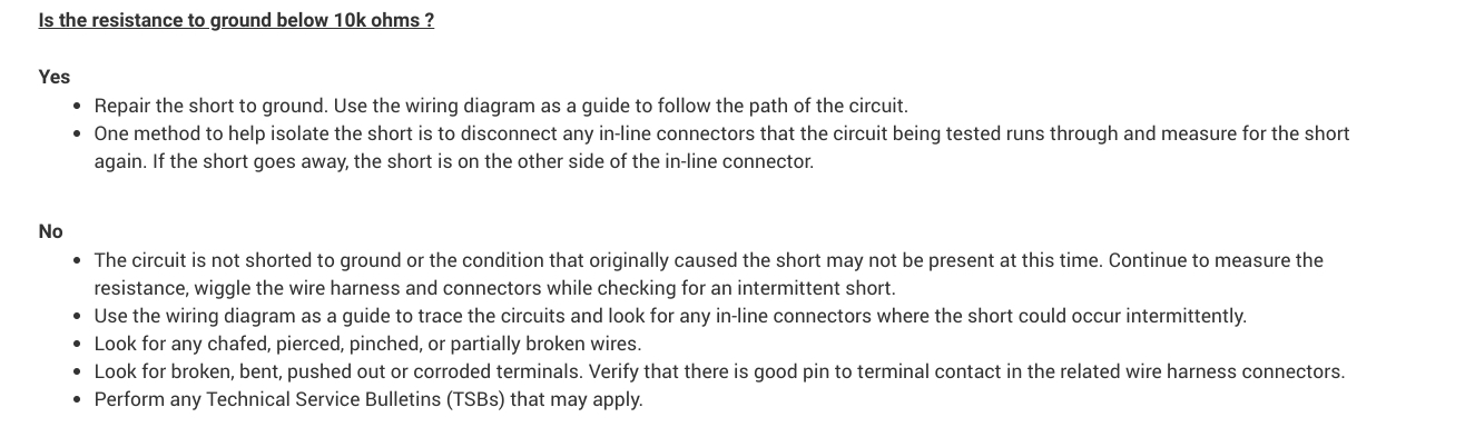

I have the vehicle listed above Sport 5sd. It bucks when I’m in gear or off the clutch. Filter is new. Will buck randomly. Check engine light is on throwing code 24. Which is the throttle position sensor code. I replaced with Mopar sensor but it still acts up and does same thing. Have put two different throttle position sensors on it. Have also replace crankshaft position sensor and MAP sensor. Still no change in symptoms.
Monday, December 7th, 2020 AT 12:11 PM (Merged)
SCGRANTURISMO
  • 4,897 POSTS

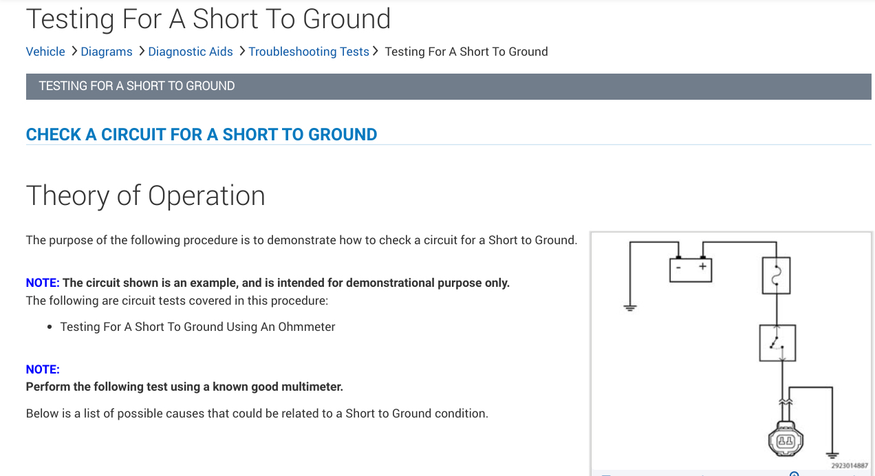

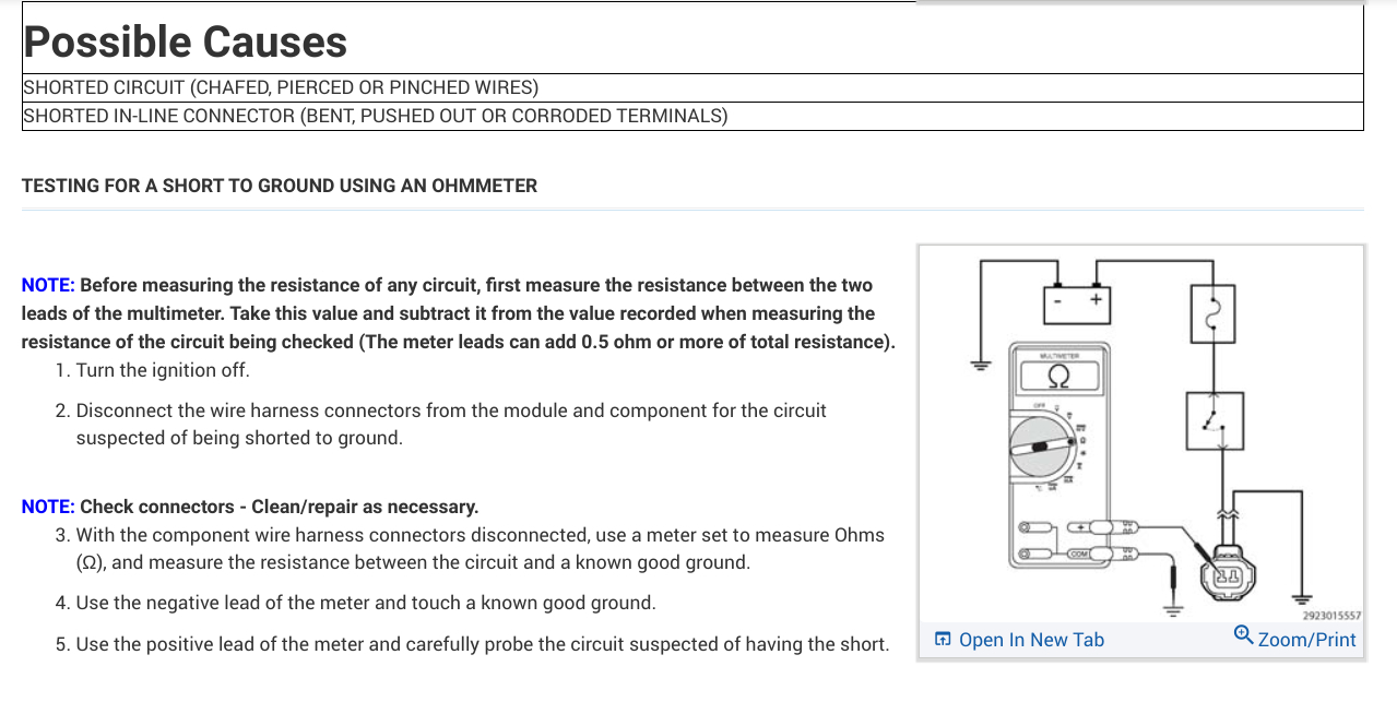

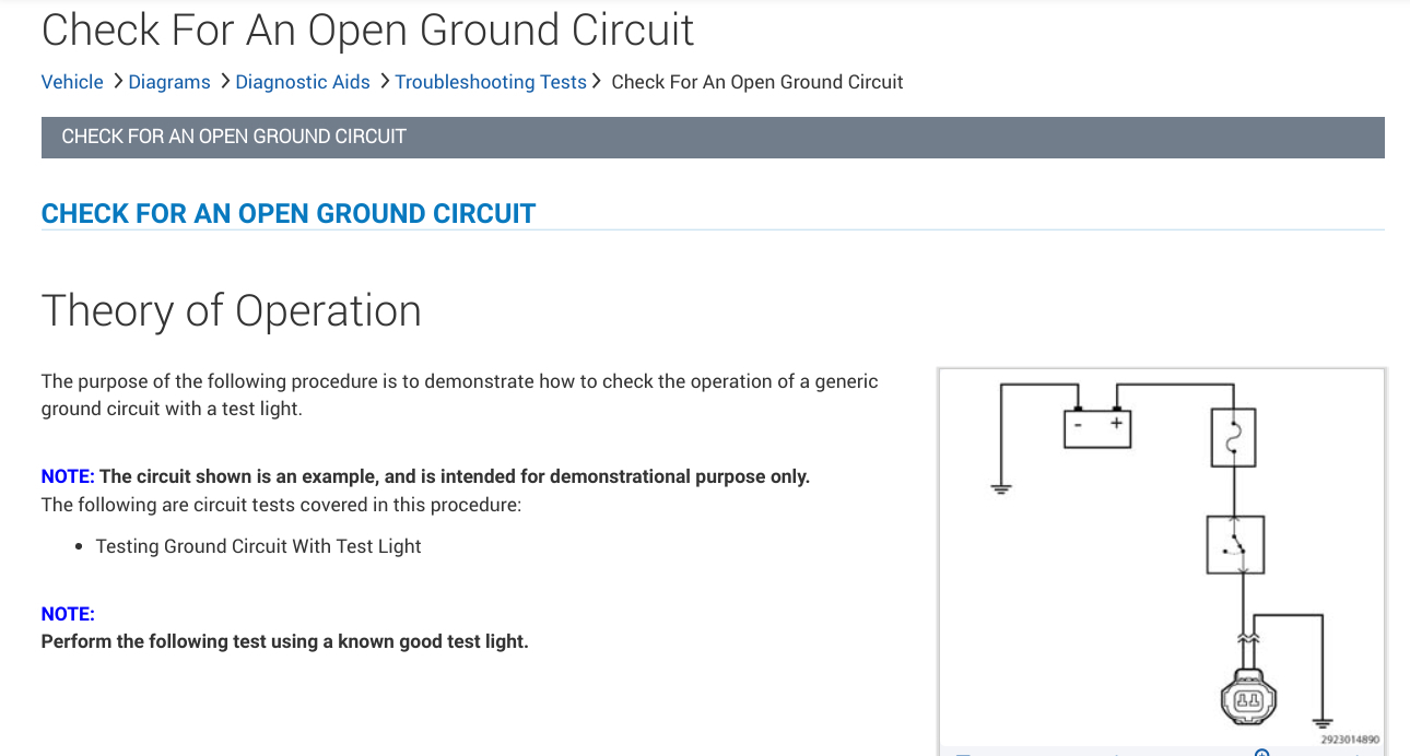

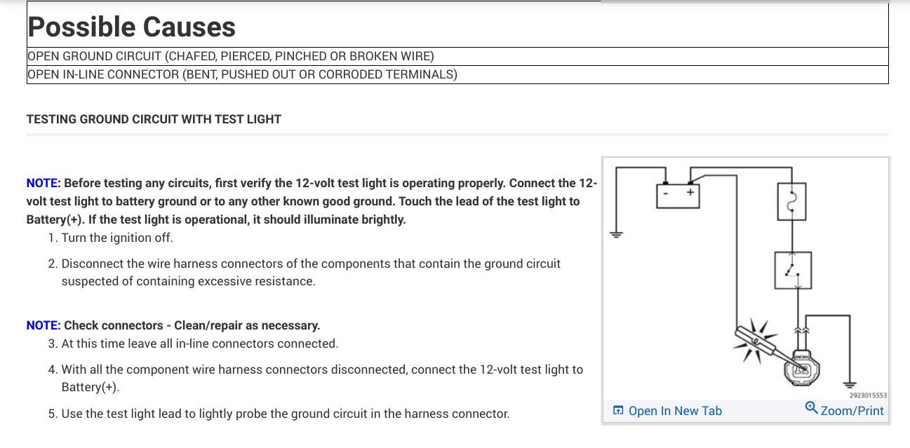

OBD1 Direct Trouble Code[DTC] 24 for your vehicle is not a code for the Throttle Position Sensor[TPS], which probably explains why switching two of them out hasn't remedied the situation. In the diagrams down below I have included the DTC list for your vehicle as well as the diagnostic troubleshooting guide for DTC 24 for your vehicle. I have also included guides on how to find opens and shorts to grounds in an automotive electrical circuit. You will need to use a Digital Multi-meter [DMM] to go through this guide, so here is a link below explaining how to use one, if needed:
Please go through this guide and report back with what you find out.
Thanks,
Alex
2CarPros
