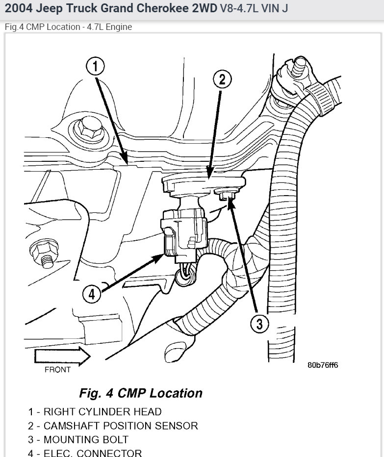

How to reinstall a cam sensor in a 2004 Jeep Grand Cherokee 4.0 engine?
Jan 1, 2009 at 2:44 PM
JNOVACK
  • 723 POSTS
Hello, Here is a guide to help you see what you are in for when doing the job with diagrams below of the camshaft sensor location for both engines. https://www.2carpros.com/articles/camshaft-angle-sensor-replacement
https://images.2carpros.com/forum/automotive_pictures/52960_0900c15280043258_2.jpg
Check out the diagrams (Below). Please let us know if you need anything else to get the problem fixed. Cheers

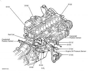

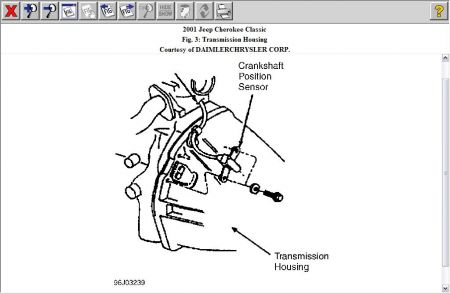

have a 2002 jeep grand cherokee 4.0L when starting it just cranks first 2 trys when starting then turns over 0n 3rd try-runs great after it starts, where is crankshaft sensor located on this eng. and is it difficult repair
Dec 7, 2020 at 1:13 AM (Merged)
BMRFIXIT
  • 19,053 POSTS
Check fuel pump and fuel pressure crank sensor by the rear at the bellhousing
https://images.2carpros.com/forum/automotive_pictures/99387_Graphic1_273.jpg

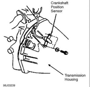

HEEEEETHIN
Other Category problem
2001 Jeep Cherokee Engine Size unknown Four Wheel Drive Automatic 60,000 miles
can not find where this litlle item is located if you could give me an exact location it would greatly be appreciated
Dec 7, 2020 at 1:14 AM (Merged)
MERLIN2021
  • 17,250 POSTS
It's on the transmission Bell housing, left side...
https://images.2carpros.com/forum/automotive_pictures/62217_CKP_3.jpg
  • 75,992 POSTS
Its on the left side of the transmission bellhousing see below.
https://images.2carpros.com/forum/automotive_pictures/12900_cps_5.jpg
Is there anything else I can help you with?

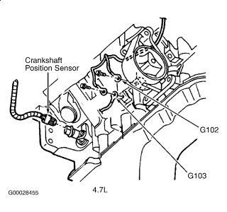

Engine Mechanical problem
2001 Jeep Cherokee V8 Four Wheel Drive Automatic 102.00 miles

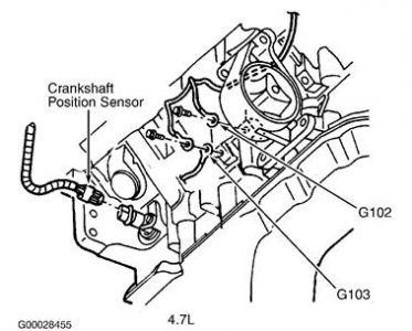

01 grand cherokee 4.7 v-8 where is it located
  • 75,992 POSTS
https://images.2carpros.com/forum/automotive_pictures/12900_crk_1.jpg
On right side of engine block,above starter motor.

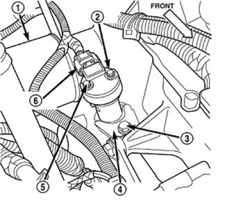

D12345ODGER
check engine light came on, diagnosed as crankshaft position sensor, where is it ?
DOCFIXIT
  • 18,828 POSTS
Right side engine block above starter
https://images.2carpros.com/forum/automotive_pictures/198357_Graphic_162.jpg

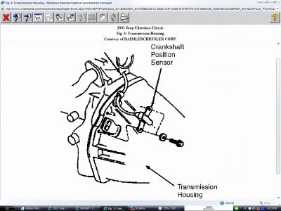

SAM WELLS
Where is the crankshaft positioning sensor on the 2000 cherokee 4.0 engine? Do you have to pull the starter to change it?
JDL
  • 16,098 POSTS
Welcome to the forum, my info shows this for crank sensor location.
https://images.2carpros.com/forum/automotive_pictures/170934_jeep_crank_sensor_1.jpg
