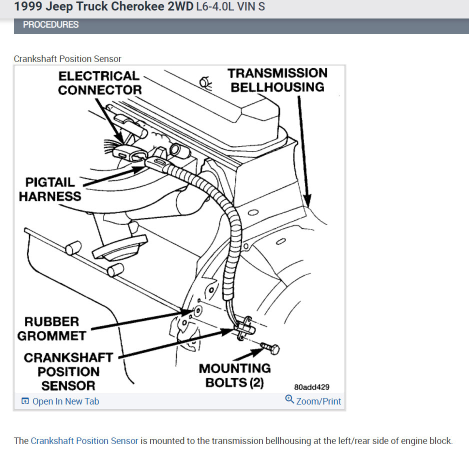

CRANKSHAFT POSITION SENSOR Fig. 33 Crankshaft Position Sensor
https://images.2carpros.com/forum/automotive_pictures/12900_cs_4.gif
The crankshaft position sensor is mounted in the transmission bellhousing at the left/rear side of the engine block (Fig. 33) . On most engines, the sensor is attached with two bolts. REMOVAL 1.Near the rear of the intake manifold, disconnect the pigtail harness (on the sensor) from the main electrical harness. 2.Remove the nut holding sensor wire clip to fuel rail mounting stud. 3.Depending upon application, remove either the sensor mounting bolt(s) or nuts. 4.Remove the sensor. 5.Remove clip from sensor wire harmess. INSTALLATION 1.Install the sensor flush against the opening in the transmission housing. 2.Install and torque the two sensor mounting bolts (or nuts) to 19 Nm (14 ft. lbs.) . CAUTION: On some models, two bolts are used to secure the sensor to the transmission. These bolts are specially machined to correctly space the unit to the flywheel. Do not attempt to install any other bolts. 3.Connect the electrical connector to the sensor. 4.Install clip on sensor wire harness. 5.Install clip over fuel rail mounting stud. Install clip mounting nut. https://www.2carpros.com/kpages/auto_repair_manuals_alldata.htm

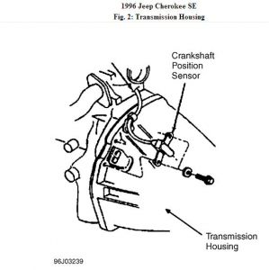

SERVICE WRITER
  • 9,123 POSTS
Left side of transmission housing. Check out the diagrams (Below). Please let us know if you need anything else to get the problem fixed.

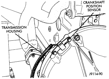

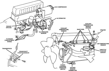

PAT SPOORES
picture of crank sensor
Dec 7, 2020 at 1:40 AM (Merged)
AIRSOFTSOLDRECN9
  • 348 POSTS
The topmost sensor should be the correct picture of it.
https://images.2carpros.com/forum/automotive_pictures/187088_wl2su368003_1.jpg
https://images.2carpros.com/forum/automotive_pictures/187088_0900c152800a9b5c_1.jpg

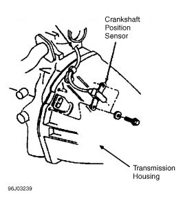

DOCFIXIT
  • 18,828 POSTS
on trans just unbolts see diagram
https://images.2carpros.com/forum/automotive_pictures/198357_Graphic_460.jpg
