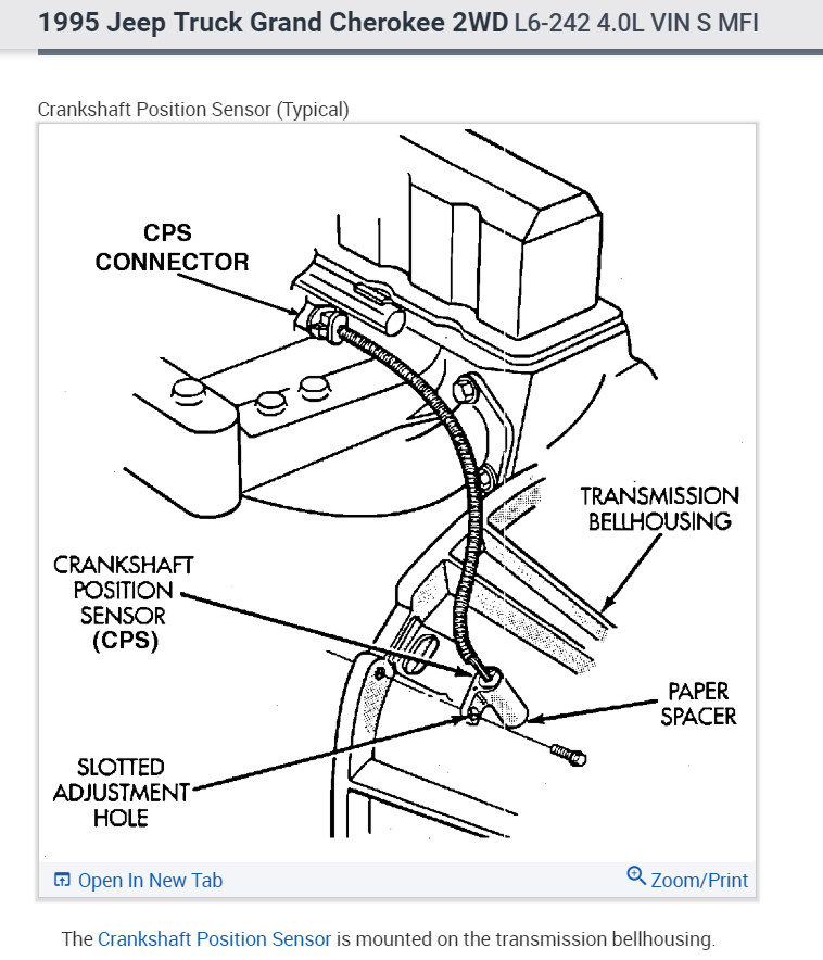

I have a 95 jeep GCL. I can get my hands on the crank sensor but I cannot get any tools on it. What do I need to do to get it out of there?

CAUTION: On some models, two bolts are used to secure sensor to transmission. These bolts are specially machined to correctly space the sensor to flywheel. Do not attempt to install any other bolts.
Crankshaft Position (CKP) Sensor 4.0L
https://www.2carpros.com/forum/automotive_pictures/12900_CKP_1.gif
REMOVAL
1.Disconnect negative battery cable.
2.Disconnect sensor electrical connector, located near rear of intake manifold
3.Remove nut holding sensor wiring clip to fuel rail.
4.Remove sensor mounting bolt(s) or nuts.
5.Remove the sensor from vehicle.
6.Remove clip from sensor wiring harness.
INSTALLATION
1.Position crankshaft position sensor flush against the opening in transmission housing.
2.Install sensor mounting bolts or nuts and torque to 19 Nm (14 ft-lbs) .
3.Connect the electrical connector to the sensor.
4.Install clip on sensor wire.
5.Install clip over fuel rail stud and tighten mounting nut.

Thanks but I know the procedure to take it out. I need to know how to get in there. The actual space is no where near as open as the illustration would lead you to believe. Cant get a wrench or a ratchet in there. The only thing I could think of was lowering the engine but im hoping for an easier way

Have you tried a universal socket?

Hey I used long extension on a ratchet also had a swivel on the socket think it was 10mm or 11mm 6 point hope this helps. Tim.

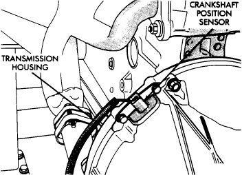

Is there a way to find out which bolt pattern I have on my jeep without removing it? Need to know which one to get a 1 bolt or a 2 bolt cranksensor

They made it both ways so you will need to look here is what the one bolt looks like. Use a flashlight and you should be able to see it.

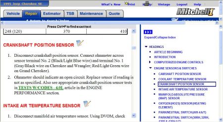

Any one know how to test a cranp position sensor on a 95 jeep 4.0

See below

You might test the wiring circuits to the cam and crank sensors. They share ref voltage and ground. For the cam sensor, the signal wire is tan with yellow stripe, the ref voltage is orange for both sensors, the ground circuit for both senors is black with lite blue tracer. To chek the signal wires, the vehicle needs to cranking, to watch for a pulse. Or you might turn on the key, turn the crank by hand, watch the voltage switch from high to low.
