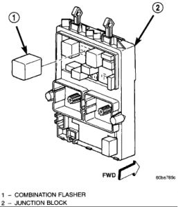

What is the location of and how do you access the turn signal flasher relay?

Hello - I have attached the information you requested. COMBINATION FLASHER
https://images.2carpros.com/forum/automotive_pictures/248015_81970024_1.jpg
The combination flasher is located in the Junction Block (JB) . The JB is located underneath the driver side of the instrument panel outboard of the steering column. The combination flasher is a smart relay that functions as both the turn signal system and the hazard warning system flasher. The combination flasher contains active electronic Integrated Circuitry (IC) elements. This flasher is designed to handle the current flow requirements of the factory-installed lighting. If supplemental lighting is added to the turn signal lamp circuits, such as when towing a trailer with lights, the combination flasher will automatically try to compensate to keep the flash rate the same.
