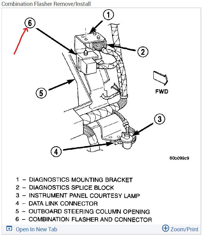

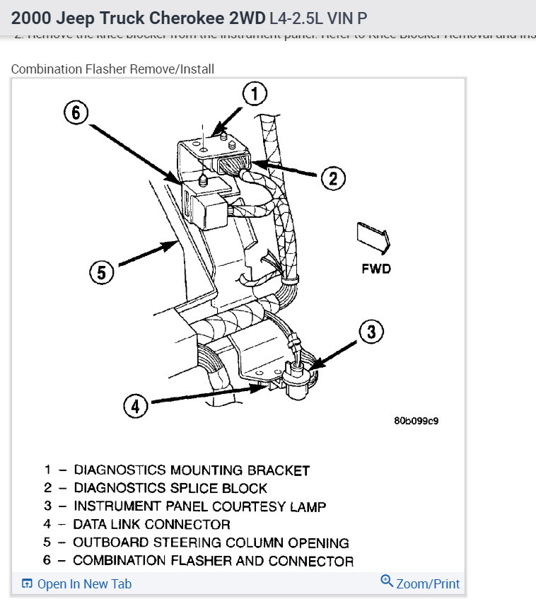

neither of my turn signals are working I have no owners manual and i am unsure of their location-can someone point me in the right direction--i believe it is a bad fuse or relay?
Nov 28, 2008 at 10:47 AM
  • 75,992 POSTS

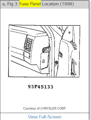

Remove the knee blocker from the instrument panel. Reach through the outboard side of the steering column opening to access and disengage the combination flasher wire harness connector retainer from the instrument panel diagnostics mounting bracket. Here is the location of the turn signal flasher which is a combination flasher. Check out the diagrams (Below). Please let us know if you need anything else to get the problem fixed.

Where is the turn signal flasher located on a 2000 Jeep Cherokee Sport?
Feb 9, 2019 at 8:20 PM (Merged)
JDL
  • 16,098 POSTS
My database showed this location. Behind the dash on the drivers side.

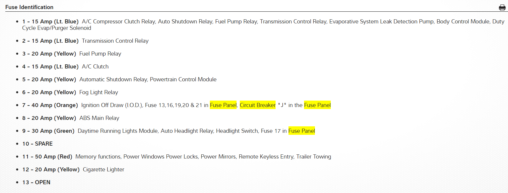

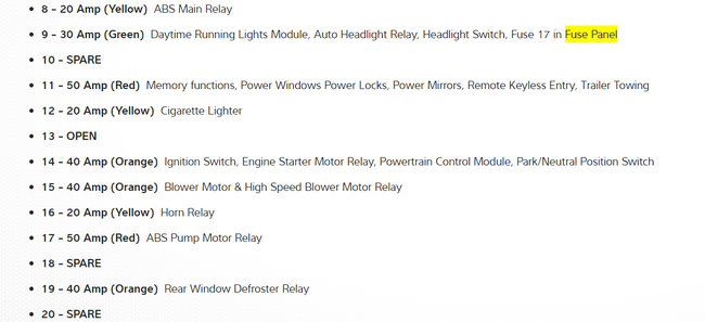

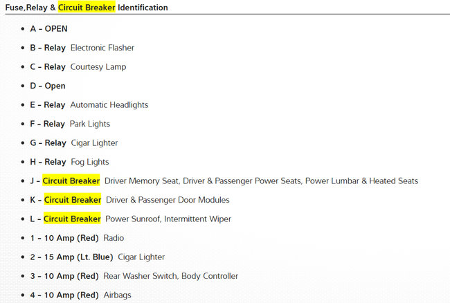

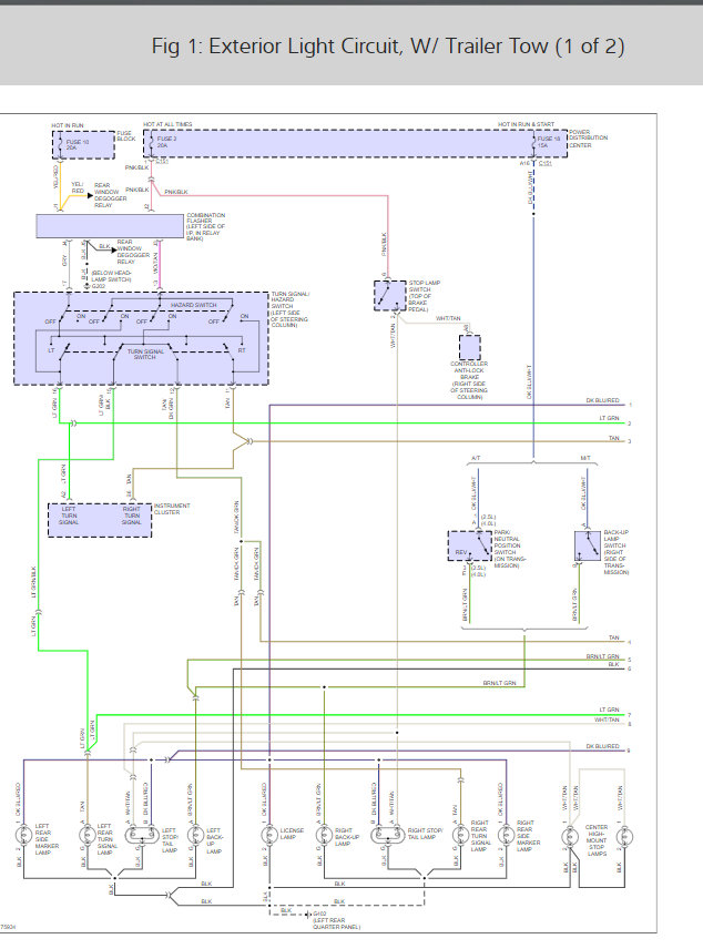

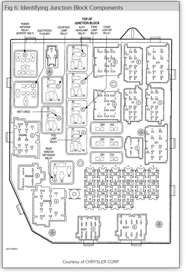

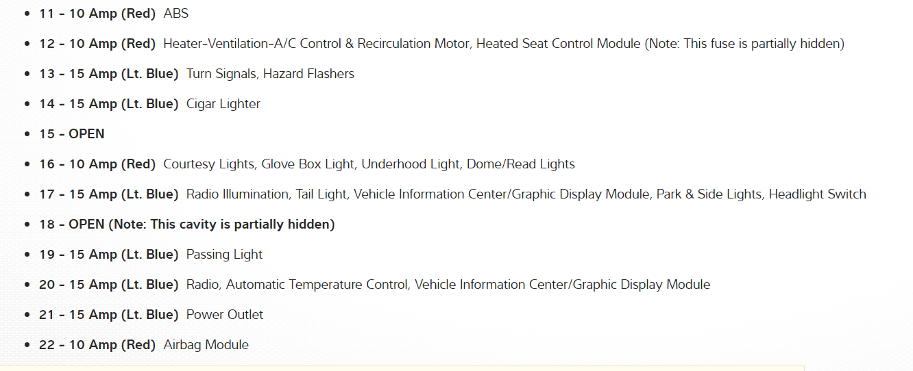

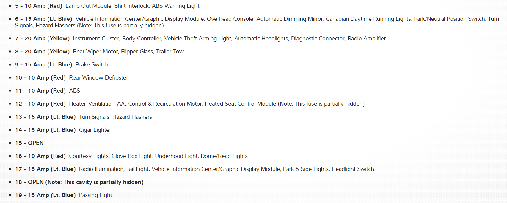

Here is the entire electrical relay and fuse system so you can see whats going on and where to find the turn signal relay. The call it an electronic flasher. Fifth diagram over.
Cheers

Okay let me get the wiring diagram so we can see whats going on. Yep just one flasher check it out (below)
Feb 9, 2019 at 8:21 PM (Merged)
JRMS93
Okay great I found the flasher unit and replaced it everything working great job for me thank you I cant believe this site is free god bless.

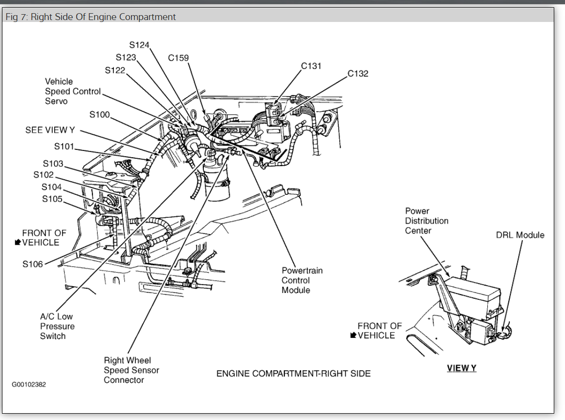

Headlights shut off completely after high beams are turned on 30 seconds. The lights will turn on again after the lights are turned off completely for a few seconds. This pattern repeats each time the high beams are turned on. There appears to be some sort of relay or circuit breaker involved here, but I do not know where to look.
CARADIODOC
  • 34,321 POSTS
What year is the vehicle? Older ones have a circuit breaker built into the headlight switch. That one and the dimmer switch should also be checked for overheated wires and connector pins. Burned terminals can be cut out of the plastic connector body and new terminals can be inserted individually. They should be soldered for a good connection even if you use the crimp-on style terminals.
caradiodoc
HMAC300
  • 48,601 POSTS

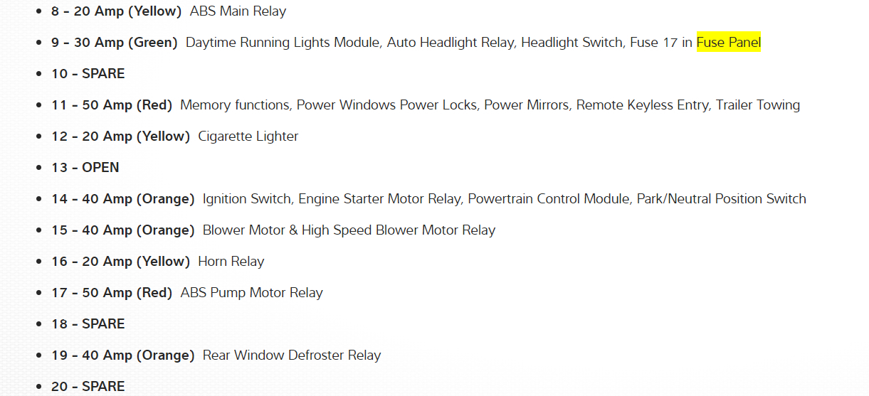

there are no circuit breakers in your system. Just fuses and relays. On the junction block on the left side of dash there is a relay for thehigh beam headlights, try replacing that as it may not be working.there is also a 10 amp fuse there, check that. There is also another fuse #3 at your underhood lelectrical center. check all of these for poorconnections. itcan also be your body control module which has relay controlers inside of it. I can't send a diagram as we can't upload on here yet. hope this helps.

The combination flasher is near headlamp switch

check your flasher there is one for the hazards and one for the turn signals. it's a combanation sensore and cold be bad for the one side.it's by the headlight switch

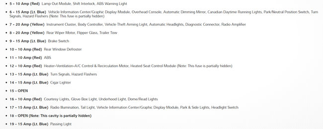

im having issues with my 200 jeep xj as well. but my hazards dont work at all either. You may want to try changing the flasher relay. Under the steering column there is an access panel thats about 2 feet wide. Pull that down. Pull out the metal guard right behind that and you'll have the whole elctrical area by the drivers feet opened up. Looking straight at it in the upper left corner you'll see the flasher relay. its just a plug in relay. I changed mine, didnt fix my issue, but it could fix yours

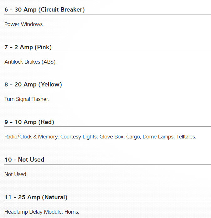

ROCKETTEER
  • 8 POSTS

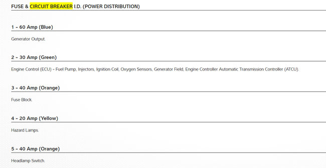

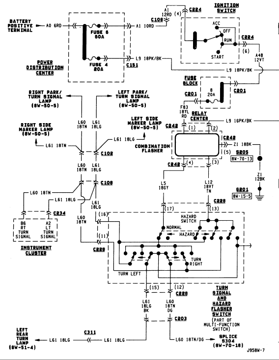

UPDATE: My dad and I spent several hours yesterday investigating the turn signal. We first unbolted the relay panel from under the dash and removed its back cover. There are five wires entering/exiting the combo flasher relay (Tridon EP-27). We found that by jumping across the yellow/red wire (presumably hot) to the purple wire in the center, the turn signal would function! Then we located the path of these terminals within the relay (i.e. on the circuit board) and soldered a jump wire across the two terminal connections. We found that the hazards and turn signals functioned correctly like this, and thought we had solved the problem... HOWEVER, we realized that this "solution" came with its own new problem: when the ignition is turned on, the relay would click constantly (without actually engaging the lamps). This noise is unacceptably annoying, so we had to remove our jump wire and are thus back to square one. I continue to stand by my argument with my dad that the relay is NOT the problem, since I already tried replacing it with a brand new one to no effect. So, I'm convinced that there is a continuity or power delivery issue between the turn signal switch and the relay. That is, we know the relay can actuate the turn signal lamps as it is supposed to, but something is not sending it the necessary power feed in order to do its job.
Two wiring diagrams are attached.
Thanks for further advice!
-Chris
ROCKETTEER
  • 8 POSTS

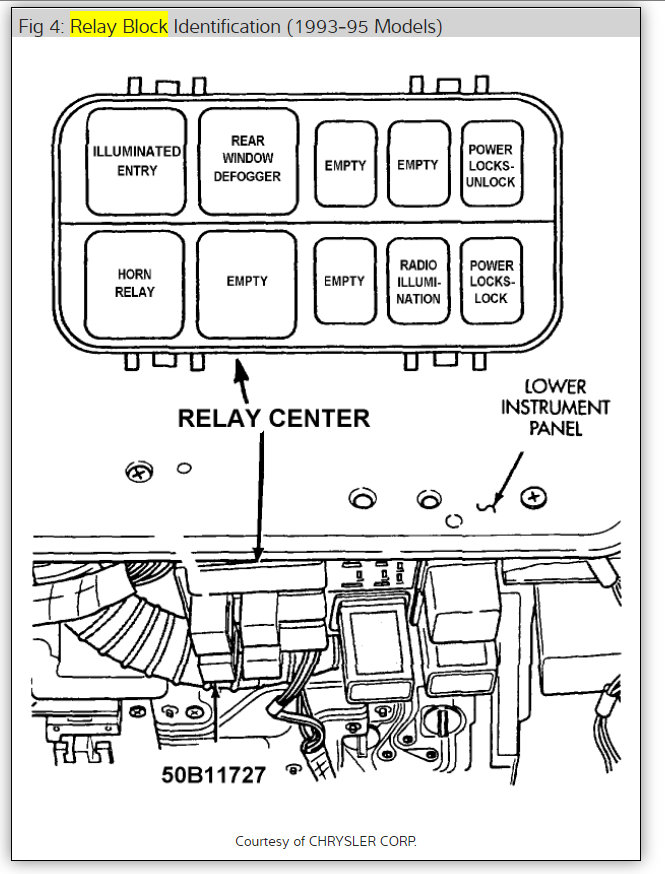

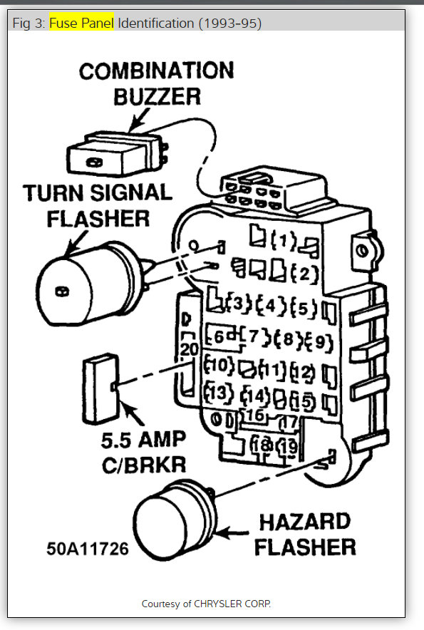

DOCFIXIT
  • 18,828 POSTS

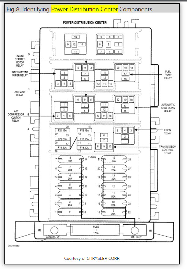

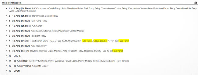

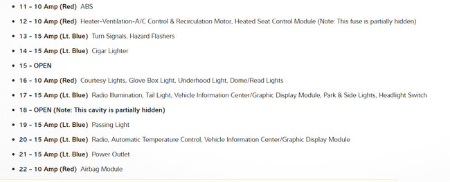

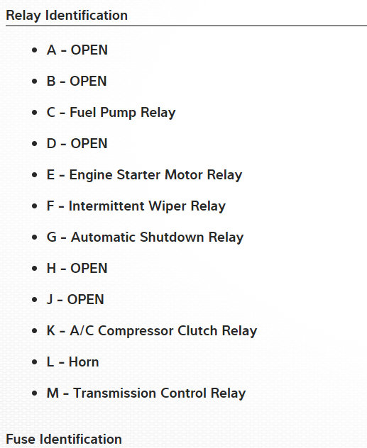

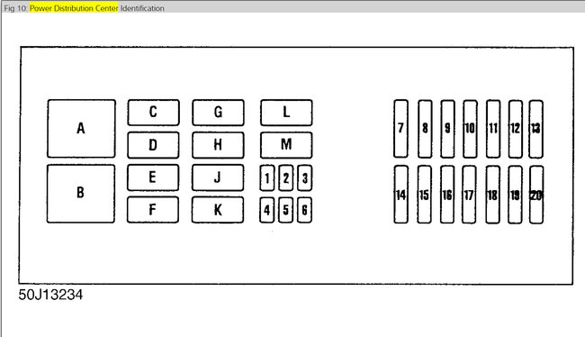

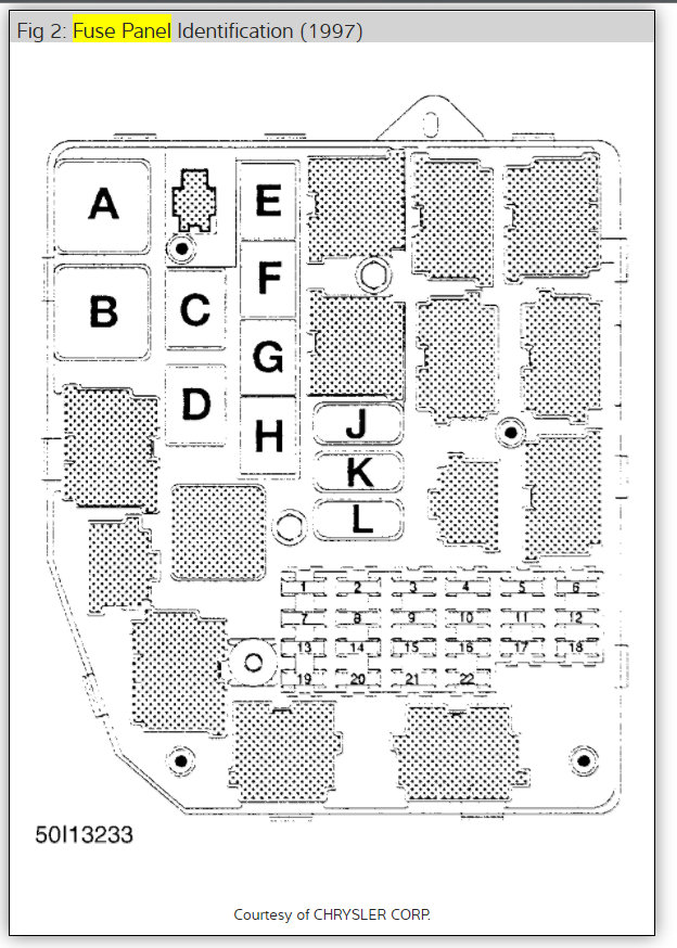

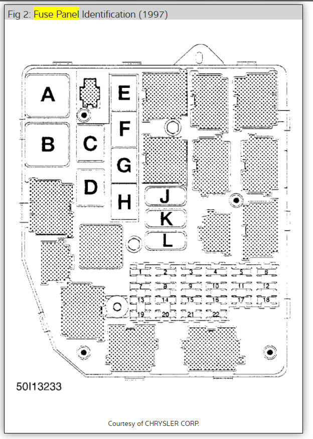

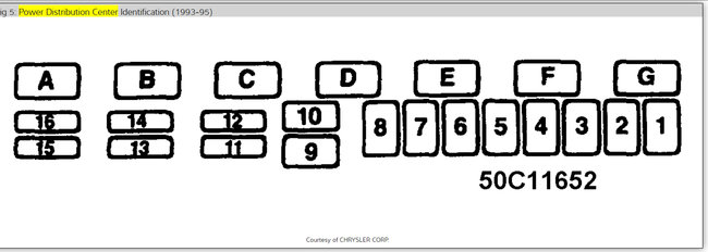

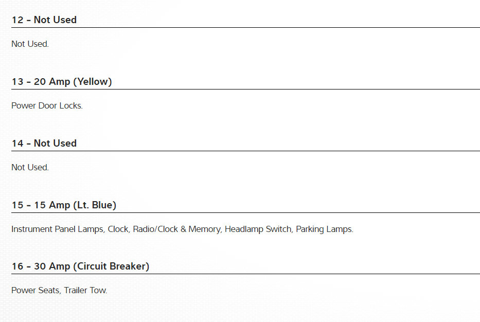

Would you provide production date and is there a trailer tow lighting on Jeep? see diagrams does fuse?relay look like this?
ROCKETTEER
  • 8 POSTS
Docfixit:
Yes, those fuse/relay panels match mine. The first is the fuse panel in driver's side footwell. The second is the fuse/relay panel that is under the hood of the car, near the battery. What is missing, however, is another relay block that is just below the steering column behind the dashboard. It is this latter relay block that contains the combined T.S./hazard flasher.
YES, the Jeep does have trailer tow lighting.
I cannot provide a production date, but the Jeep was purchased brand new in 1995.
DOCFIXIT
  • 18,828 POSTS
Not sure what you see at steering coluumn but flashers are in I/P/ box. Has all the Gerry rig wirirng been removed?
ROCKETTEER
  • 8 POSTS
The fuse panel diagram you included is found under the dash, but the slot for the turn signal flasher is empty, as is the hazard flasher. These two cylindrical relays are not present anywhere. The combined turn signal/flasher relay is just behind the dash, slightly to the right beneath the steering wheel. I know for a fact that this is the turn signal relay because we have made the turn signal work by playing with this relay. Please read a previous post from me with the exact same title as this one. In it I explained all of the troubleshooting that has gone on so far and I've tried to explain that the fuse/relay diagrams in the Jeep manual and in maintenance manuals are NOT what is seen in my Jeep. I can provide photos if necessary.
As for gerry-rigged wiring... Once upon a time there was an anti-theft ignition kill device installed. However, this has been completely removed along with all its associated wiring. There is trailer lighting, but it was professionally done and I would not be able to recognize any of its wiring unless you told me what to look for.
If you consider what we did while testing the relay (please refer to previous post), it's really pointing toward some power delivery to the flasher relay. We could jump two leads and cause the TS to work. I'm attaching two wiring diagrams. Please look over these and note the hot connection from the ignition switch. This is what we suspect is the problem - that the flasher relay is not getting its operational power from a hot lead.
DOCFIXIT
  • 18,828 POSTS
At multi-function flasher check for power on yellow/red and black/white wires? if power put test light on black wire operate turn signals What happens?
THERED95SPORTXJ

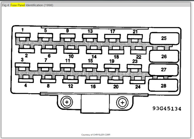

I have the same problem sorta but the pictures up above you showed the second one doesn't match mine but the 1st one does. I have a 1995 Jeep Cherokee sport. But it was made in July of 94 but the 3rd relay box isn't it either so I'm stuck because my turn signals and Hazards don't work
  • 54,840 POSTS
It sounds like the flasher is out or you have lost power somewhere. here is the wiring, flasher and fuse panels for you car. please follow this guide and see what you find.
Check out the diagrams (below)
