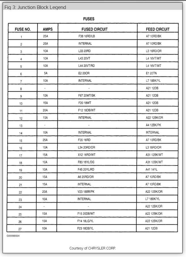

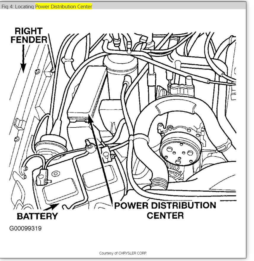

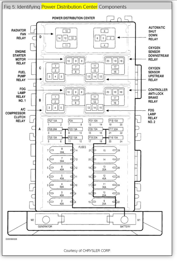

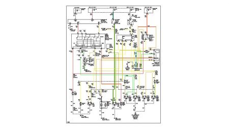

What type of Cherokee is this? You have a fuse in the power distribution box that powers the brake switch. It is number 23 15 amp. The wire colors at the brake switch is tan/white and pink/dark blue confirm this. You should have power at pink/dark blue at all times. When you depress the brake both should have power. This is the best I could do with EWD image you need to blow it up, need more help comeback.
https://images.2carpros.com/forum/automotive_pictures/12900_cherokee_EWD_1.jpg

It is a Jeep sport I believe. Not the Grand etc. When you say power distribution box you mean the fuse box, right? All the fuses in the fuse-box are good. I keep checking that continually as I go. I will look over the diagram you presented. This is frustrating. I appreciate your help.
The only power I have at the brake light switch is the pink/white and it reacts to the plunger. On a pin out of the harness-connector it is called the "brake light sense" what ever that means or does I am clueless. No power at the tan/white wire. I will confirm the colors when I get home.

unfortunately, there is no way for me to blow up the provided diagram and have it legible.

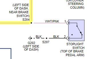

The pink/white wire should always have power-depressing the plunger should open the circuit and depressing it should transfer power to the white/tan wire.
Mar 11, 2008 at 8:47 AM
  • 75,992 POSTS
Thanks for all your help. under hood fuse 23 was the problem.

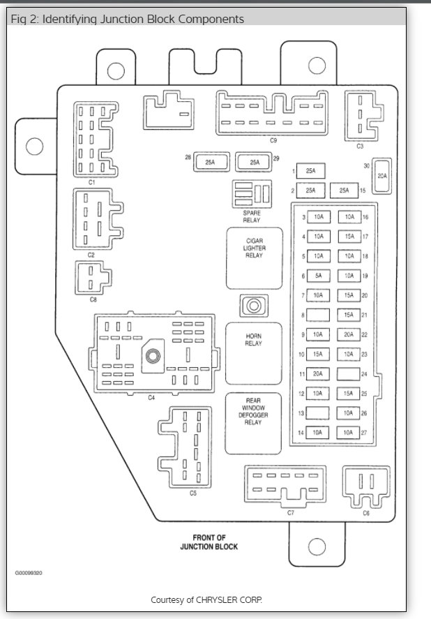

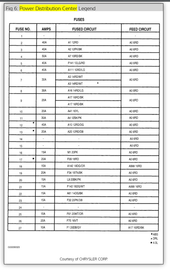

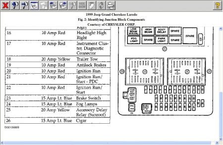

Fuse number 23 under the hood fixed Dave's 2000 Jeep Sport. I do not have a number 23 on my 1999 Grand Cherokee Laredo. (The slot is empty). Would you know which fuse/plug thing might help my brake light problem?
Apr 14, 2008 at 3:51 PM
  • 75,992 POSTS
I do not. what is going on? I came up for yours the same fuse at number 23 see below.
https://images.2carpros.com/forum/automotive_pictures/12900_brake_3.jpg
Apr 14, 2008 at 7:50 PM
PLGXX
Okay got it. That one is under the driver side dash. I thought maybe you were referring to the fuses in the black box under the hood.
Number 23 under the dash is my problem. It keeps blowing. I read about changing the the turn signal switch so I changed it and bam! all fixed.

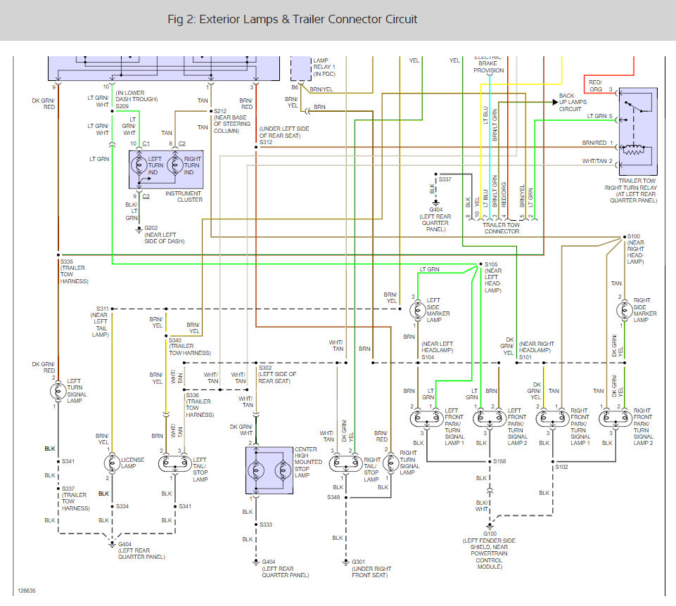

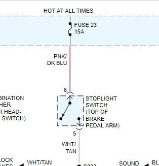

I have no brake lights at all on my vehicle listed above Sport. I have no power to the brake switch on the lower column (pink wire), but I have power to and through fuse 22, which by the wiring schematic I have is supposed to supply power to that switch.
Nov 12, 2020 at 4:23 AM (Merged)
  • 110,240 POSTS
Welcome to 2CarPros.
If there is power at the fuse, does it exit the fuse box? You could have power available that goes nowhere because of a bad fuse, pushed out pin in the box, or a bad connection. If the power does leave the fuse box to the switch, there has to be a break in the wiring at some point preventing the power from reaching the switch.
I cut a portion of my schematic for you to compare to what you have. See if it is the same. If it is and the power leaves the fuse box but is lost at some point between the box and the switch, the only thing you can do is start tracing that wire and determine where it is broken.

Well that is interesting. the schematic that I am using (Haynes manual, Cherokee 84-01 copyright date 2005) designates the fuse as #22 and I see that your schematic designates #23. although they (the schematics) are identical otherwise. Guess I'll be checking #23 in the morning. And yes the fuse in 22 is good and lights at both test posts.

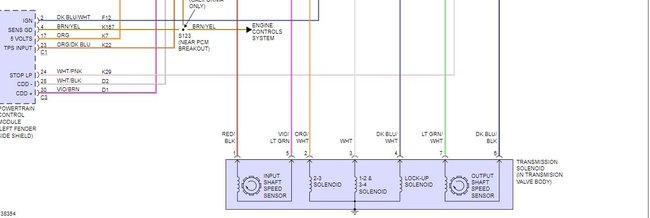

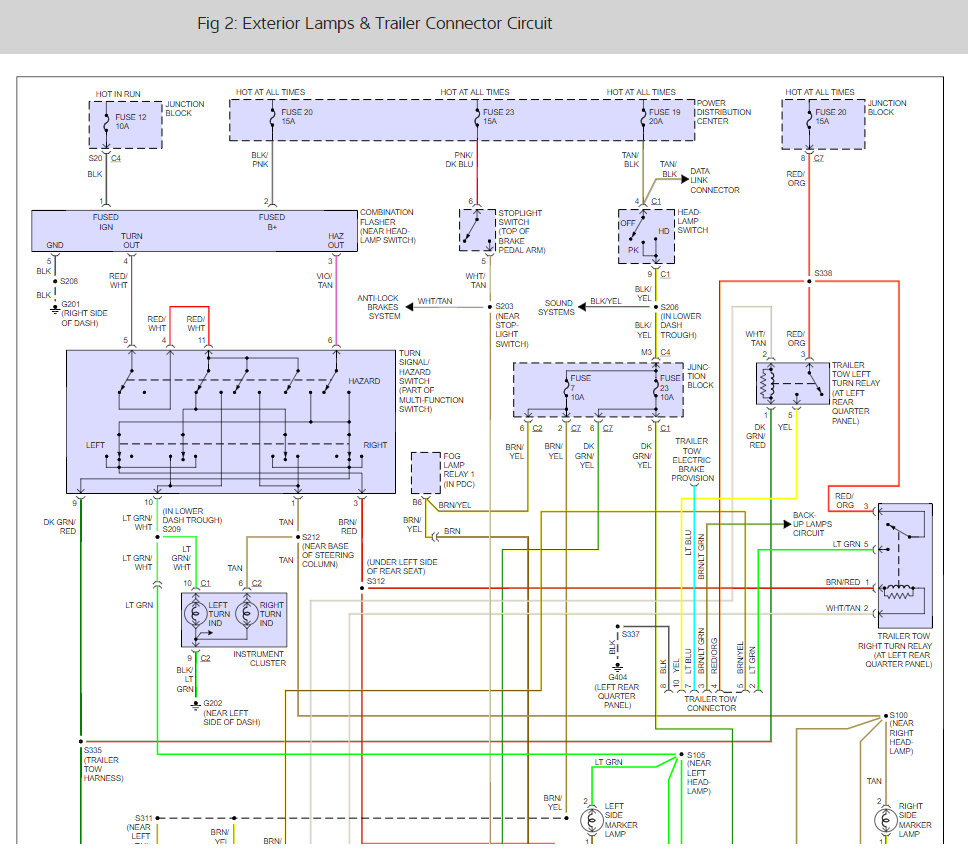

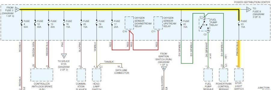

I just doubled checked on another schematic and the fuses are correct that I said, but I found one thing of interest. There is a splice to power the switch. Take a look at the schematic I added. I just cut out the section I am referring to. You may want to also check that splice to make sure it isn't corroded or damaged. That will cause the issue for sure.
BOB 1950
  • 7 POSTS

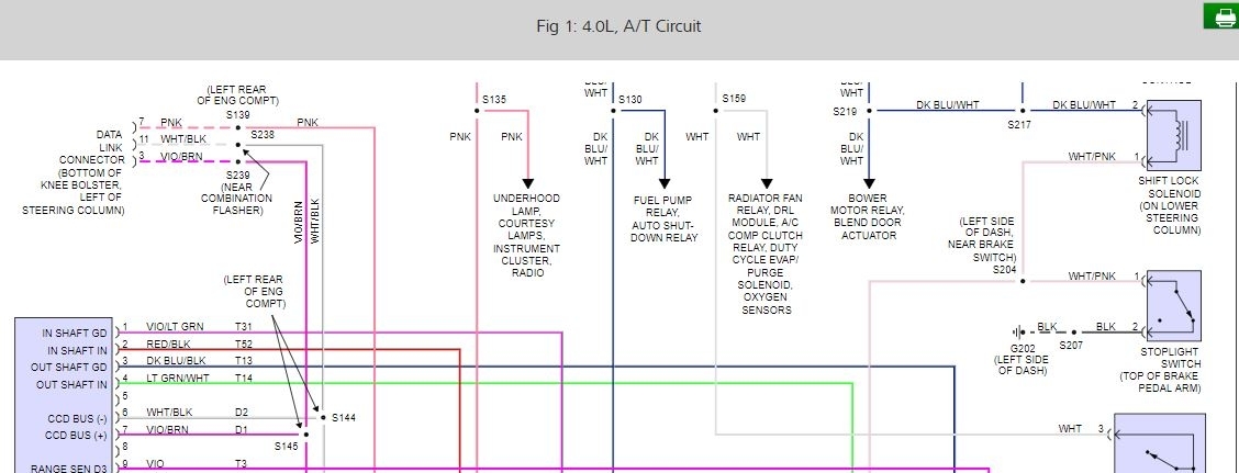

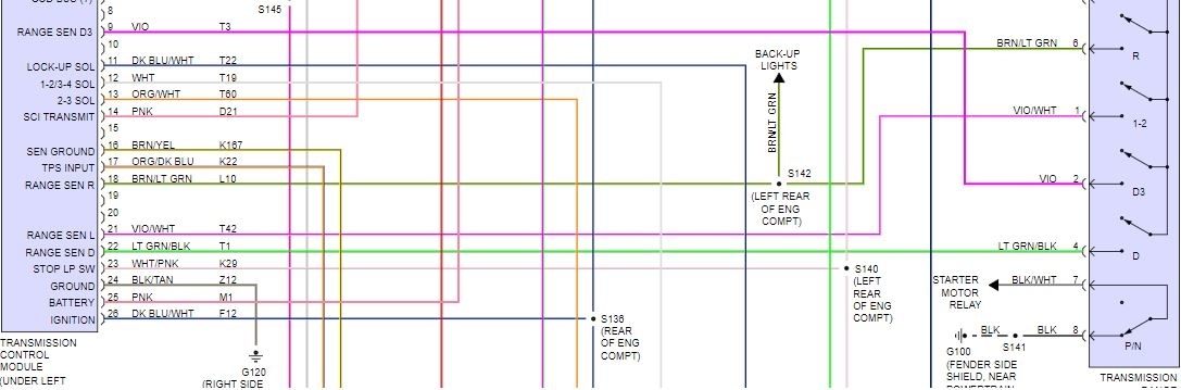

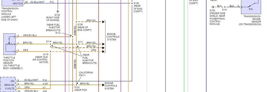

Hello. Hmm, okay, thanks. Any chance that I could get an expanded shot of that splice specifically? wondering what the yellow-outlined unit is. I have a white/pink line going to the brake switch, and there was power there. I'll be diving back in later today.
  • 110,240 POSTS
Welcome back:
I highlighted the white/pink wire so you could easily see what I was talking about. That's why it looks yellow.
I attached the entire schematic for you, I had to break it into a few pictures because of its size. The pictures are in order and I overlapped them so you could follow from one to the next.
Let me know if this helps.

Whew. dayum long week, lots of late nights working. I took a second and found that I had no power going to fuse location #23. and the Haynes wiring schematic is not good! I'm not discerning where the power comes from, and don't look forward to a major tear-apart to trace it back. Any knowledge? Thanks.
BOB 1950
  • 7 POSTS
P.S. But interestingly both tail lights are working,, and directionals..
  • 110,240 POSTS
Welcome back:
They are working? Did you do anything that may have led to them working? If they are working, you may want to leave well enough alone. LOL
Let me know,
BOB 1950
  • 7 POSTS
No. my taillights are both working, and the directional's, even though fuse #23 has no power to it. still no brake lights. I'm needing to know where is the source of power to 23 supposed to be.
  • 110,240 POSTS
According to the schematic, it comes from fuse 2 of the junction box. However, take a look at the picture. If there was not power from fuse 2 (40 amp) many other things would not work. I highlighted the supply. I have a feeling the box itself has failed or melted internally for fuse 23. Take a look at the pic and let me know your thoughts. You may have to disconnect the battery and remove this fuse box to inspect it from the underside.
