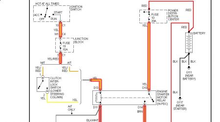

it will pre-start but when you turn the key to start it it wont crank. The starter and battery is good what else could it be?

Is it cranking over and refuses to start or won't crank at all/nothing.
If its cranking and will not start-d below
Disconnect a sparkplug wire or 2 and ground it to the engine -have helper crank engine over-do you have a snapping blue spark? If so-you have a fuel related problem, check the fuel pressure to rule out the fuel filter/fuel pump/pressure regulator and listen to the injector/s are they pulsing or hook up a noid light. No snapping blue spark continue to troubleshoot the ignition system-power input to the coil/coil packs,coil's resistances,cap and rotor /distributor pick-up coil, ignition control module, ECM,Ignitor cam and crank sensors- Note: If it doesn't apply disregard it

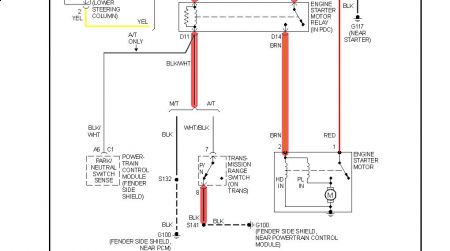

If its not cranking over at all/nothing l-could be fuse no. 10 20amp and fuse no.19 10amp, starter relay, transmission range switch and ignition switch.
https://www.2carpros.com/forum/automotive_pictures/12900_start1_3.jpg
https://www.2carpros.com/forum/automotive_pictures/12900_start2_3.jpg
