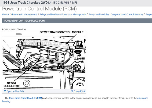

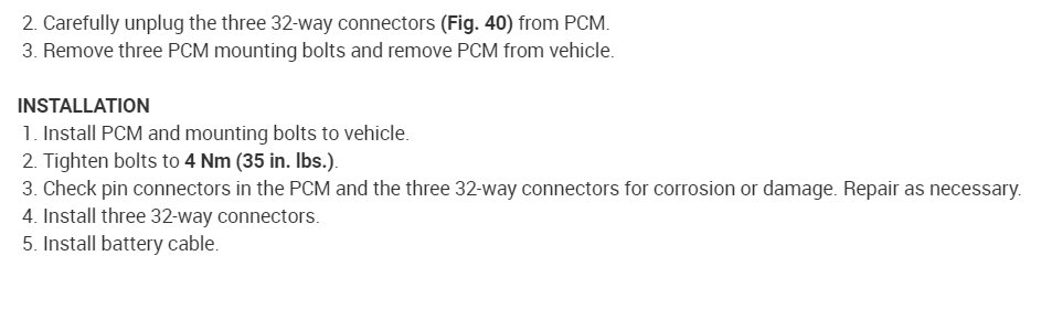

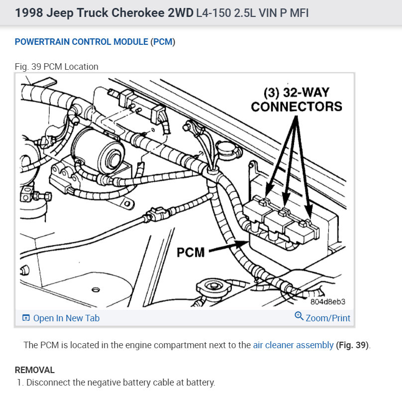

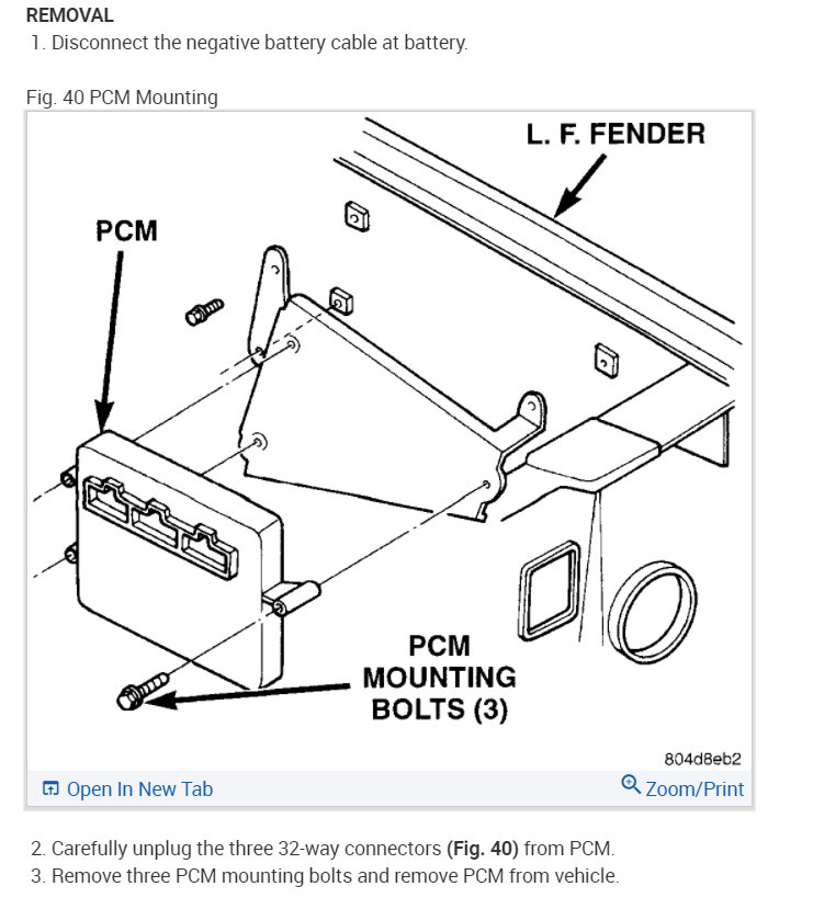

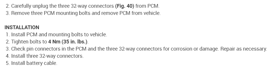

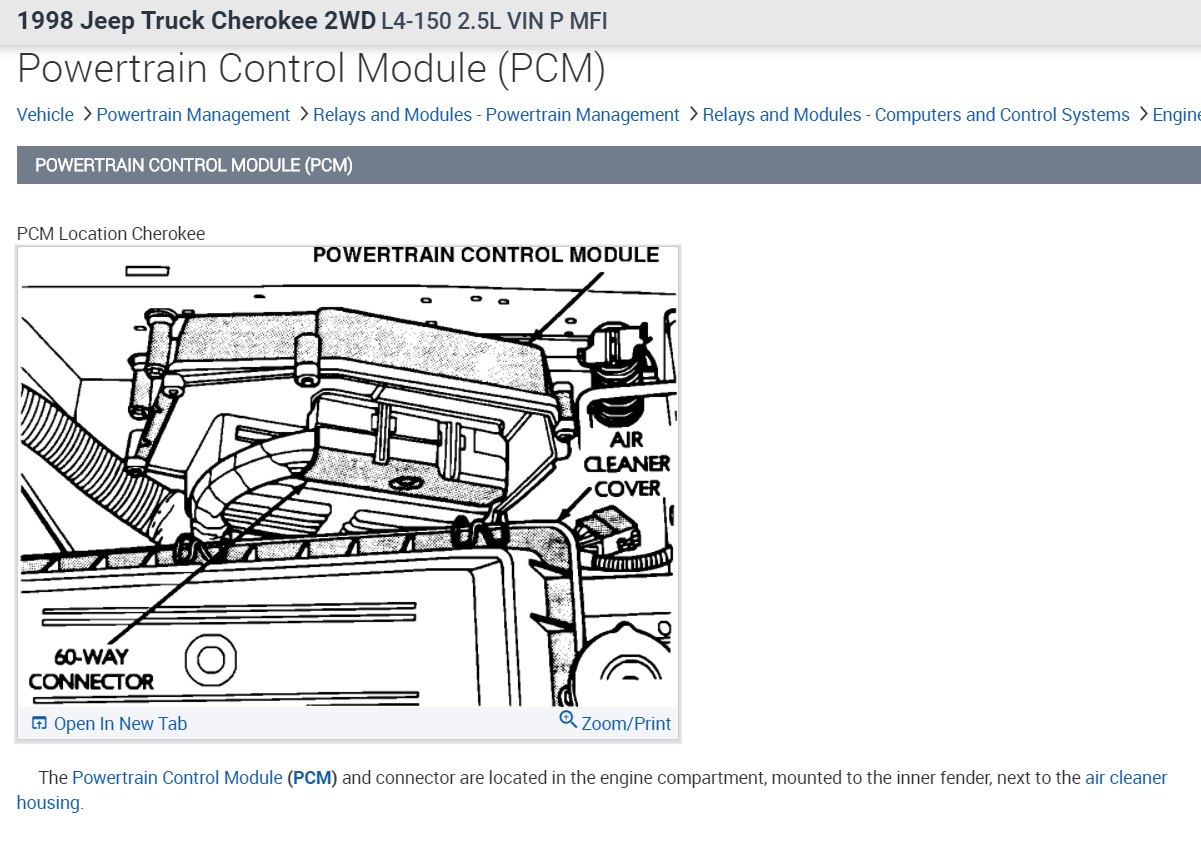

JIS001
  • 3,412 POSTS
Here is the location on the PCM engine control module in the diagrams below that also explain how to replace it. Check out the diagrams (Below). Please let us know if you need anything else to get the problem fixed.
