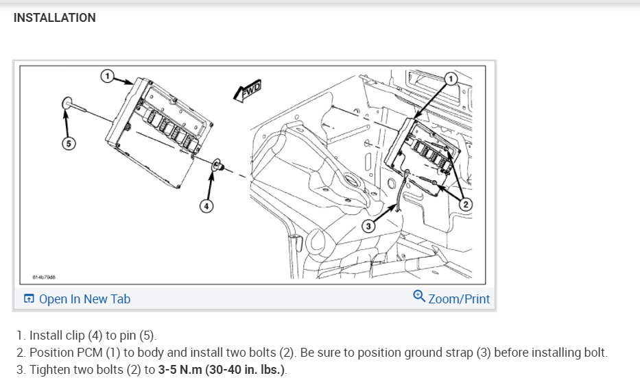

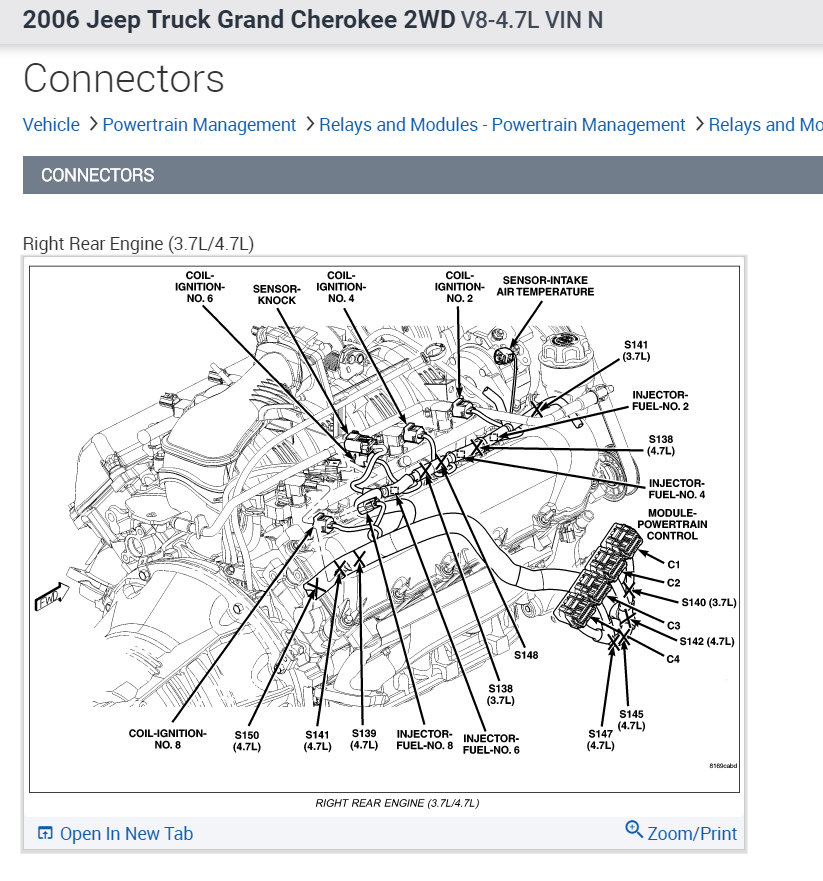

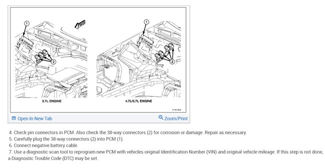

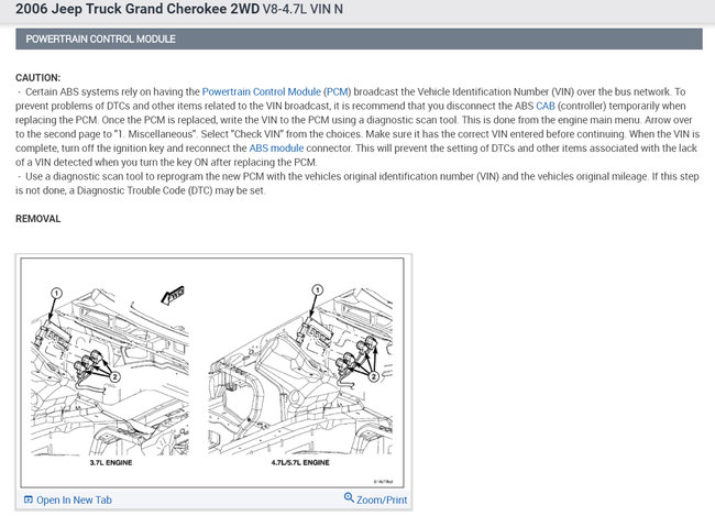

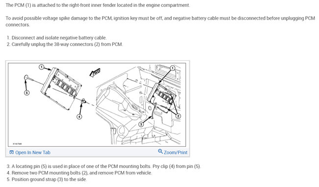

What is p1129 computer code. What causes it and how to you fix the problem? Where is the PCM and how do I replace it?
Jun 16, 2010 at 6:39 AM
  • 75,992 POSTS
You sure its not 1192? if rechecking and pops up with this code. Here is a how you replace the PCM and its location in the instructions below. Check out the diagrams (Below). Please let us know if you need anything else to get the problem fixed.

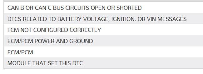

I'm sorry i gave you the the wrong trouble codes. I have a no communication problem on a Jeep Grand Cherokee Limited. On the enhanced side of my scan tool i have a U0100 and a U0101. Now what i want to know is how to resolve this issue?
Aug 11, 2020 at 11:16 AM (Merged)
HMAC300
  • 48,601 POSTS
those codes are can bus problems like maybe a broken or shorted wire and normally a pro should check those out. it means you have lost communication with the ecm and tcm. pic explains possibilities. Also make sure battery is in good shape including a load test and terminal ends are clean.

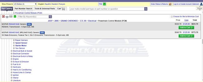

KINGAV
Is it possible for a car with such a low mileage to be experiencing engine control module issues? and can I trust replacement?
Good morning,
The 2005 is not even listed at that site. So the answer is no.
You have a car that is 15 years old and the electronics will wear out over time.
If you need one, get it from the dealer and have someone flash the module with the latest software for you.
Any shop can do this procedure. It does not have to be a dealer.
I attached a site for the module and it lists one from MOPAR.
