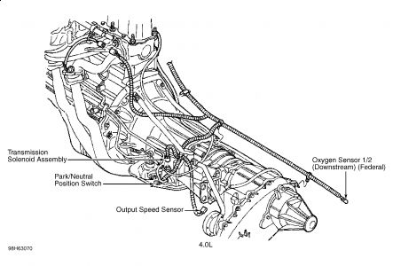

My Grand Cherokee Laredo gets a code of 720 and the transmission will not shift from 3rd to 4th. I have changed the transmission oil and filter changed about 12,000 miles ago. Can this be a speed sensor? Or, is it something else? I do not want to rebuild t he transmission, at this time. Can you help?

Output speed sensor keft rear trans

you did not say if it is a auto or stick trans! does the service light come on. when was the last time the tran fluid and filter was changed? if it is an auto trans it could be the output speed sensor. pull the trans dipstick and look at and smell the fluid. if the fluid is brown and stinky it could just need changed but could be worse. if it is kind of pink i would take it some where and have it scanned for codes!

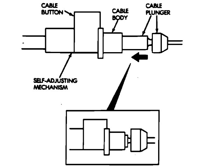

Good morning,
There is a cable on the throttle body that controls shift points.
It is attached to the throttle valve in the valve body. it is adjustable. I would check to be sure it is not disconnected first. if it is connected, try adjusting the cable back and forth to see if it shifts.

5. Install drain plug and fill transmission with fluid to appropriate level, then adjust cable as follows:
a. Turn ignition switch to Off position and fully retract cable plunger, then press cable button all the way down and cable plunger inward, Fig. 18.
b. Rotate primary throttle lever to wide open throttle position and hold while allowing cable plunger extend. Release lever when plunger is fully extended.
