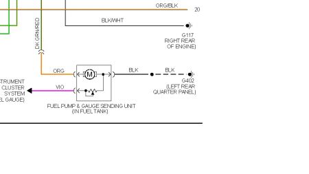

1995 Jeep Cherokee V8 Four Wheel Drive 167, 00 miles
replaced in tank feul sending unit but takes 10 to 15 minutes for pump to turn on, once it starts and is run for 10 or 15 minutes it works fine
Sunday, September 19th, 2010 AT 7:38 PM
JDL
  • 16,098 POSTS
Was the fuel pump replaced? Any applicable mil codes? The info I looked at was for 4.0L--six cylinder. You can check voltage and ground for the fuel pump motor. Orange wire is voltage, black wire is ground.
https://www.2carpros.com/forum/automotive_pictures/170934_cherokee_fuel_pump_circuit_1.jpg
