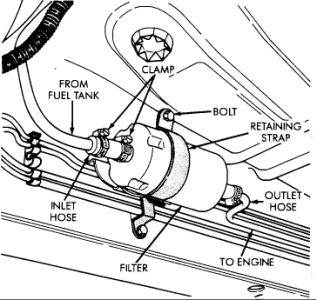

Does an 98 jeep grand cherokee have an in line fuel filter?

REMOVAL
NOTE: Fuel system pressure must be released before servicing the fuel filter, refer to MAINTENANCE PROCEDURES .
Disconnect the negative battery terminal, and remove the fuel tank cap.
Raise, and support the vehicle for access.
Remove fuel filter hoses and clamps from the inlet and outlet fuel lines. Remove the retaining strap bolt, and remove the filter.
INSTALLATION
Install the new filter in the retaining strap. Check the direction of flow by the markings on the filter, and ensure it is correct.
Install the retaining strap bolt, and torque to 12 Nm (8.8 lb-ft)
Install the inlet and outlet hoses, and clamps. Tighten the clamps securely. Lower the vehicle. Reconnect the negative battery terminal.
