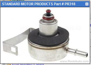

JDL
  • 16,098 POSTS
Hi, pressure regulator/filter combination. My parts book, showed this. As far as how to get it off, I guess I'd have to look at it. I can't remember every year-- make -- model I ever worked on. I'm getting old.lol
https://www.2carpros.com/forum/automotive_pictures/170934_jeep_pressure_regulator_1.jpg
Saturday, January 30th, 2010 AT 2:48 PM
BLAZER911
  • 5 POSTS
Does this go on top of the module that goes in the tank?
Saturday, January 30th, 2010 AT 5:10 PM

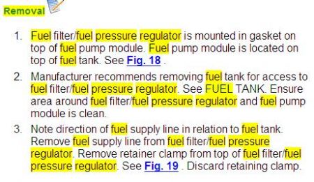

JDL
  • 16,098 POSTS
Yes.
