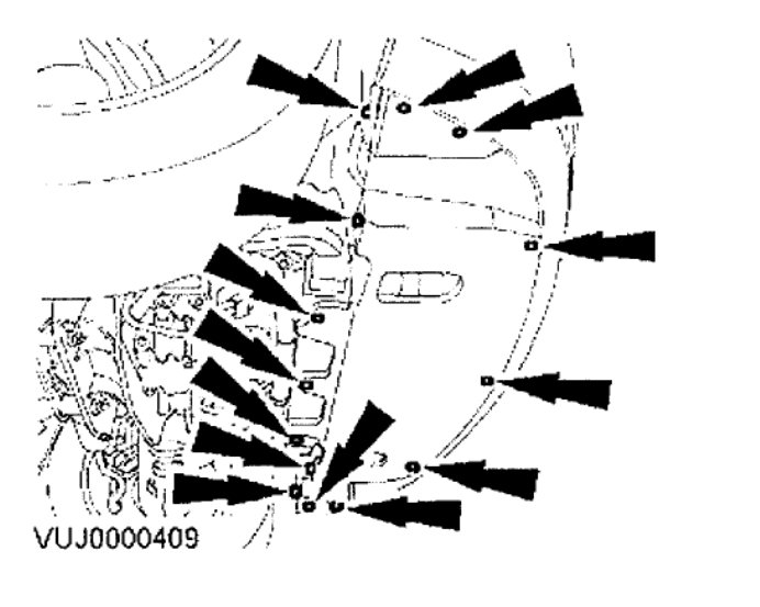

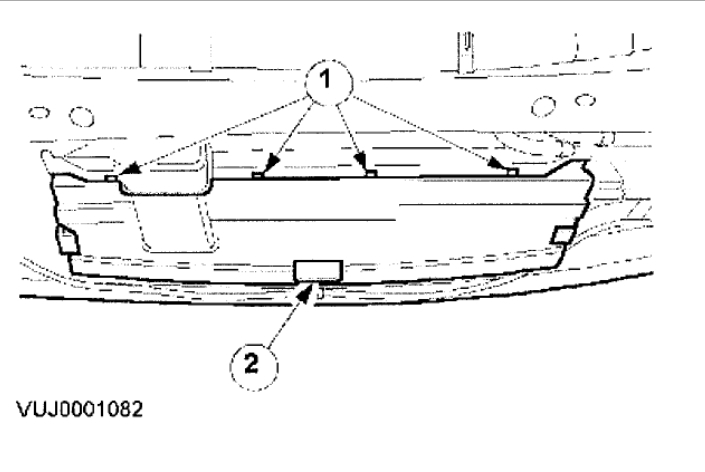

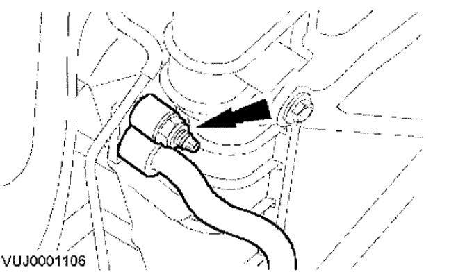

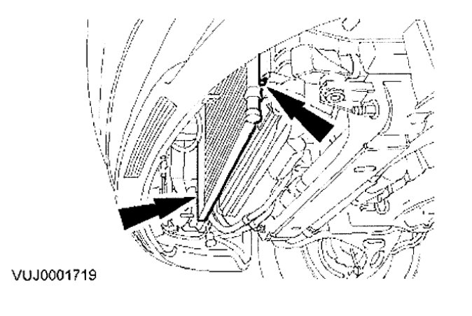

JPMAC

BLUELIGHTNIN6
  • 16,542 POSTS
You probably have a coolant leak in the radiator and it evaporates before it hits the ground or the leak is high enough that it looses pressure but not to much coolant.
Here are a couple of guides to help you see whats going on.
https://www.2carpros.com/articles/car-is-leaking-coolant
and if leaking this guide will give you an idea on what the job will be like
https://www.2carpros.com/articles/how-to-replace-a-car-radiator
Please let us know what happens and upload pictures or videos of the problem.
Cheers

Jun 8, 2020 at 5:57 AM (Merged)
BLUELIGHTNIN6
  • 16,542 POSTS

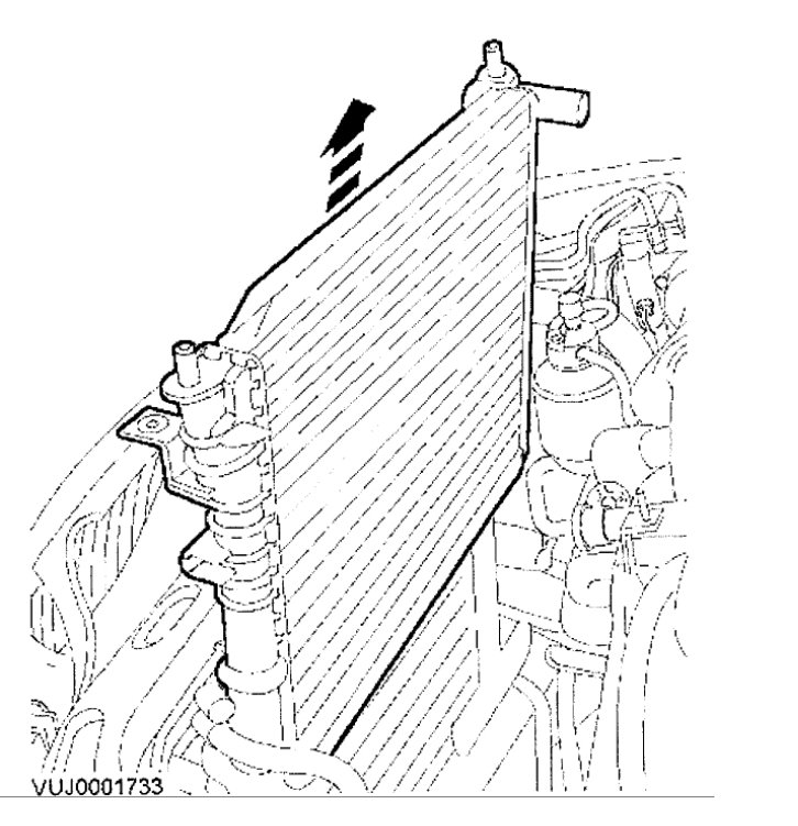

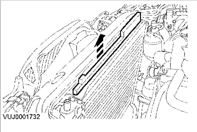

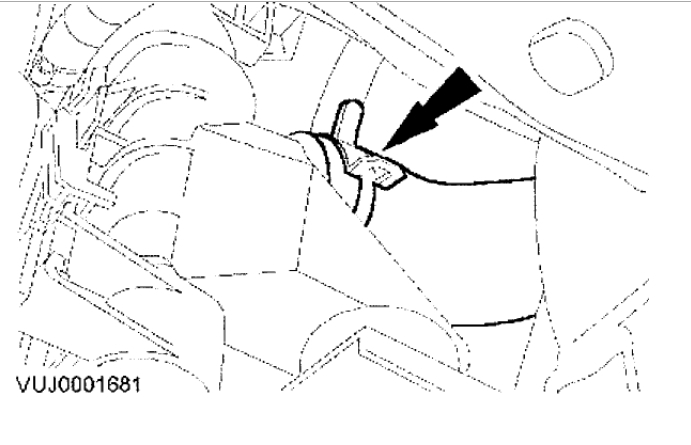

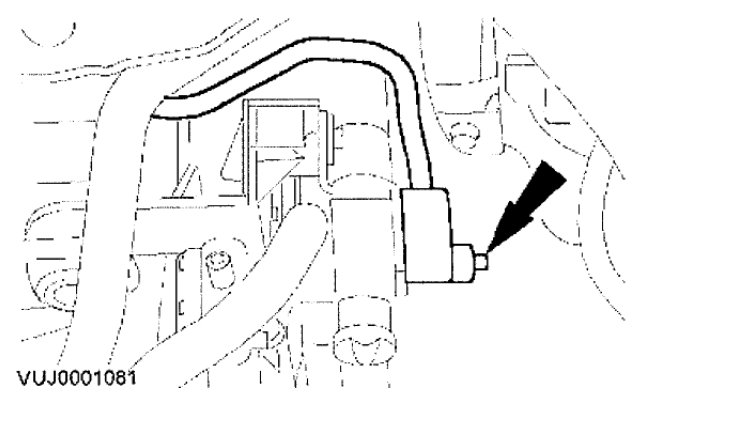

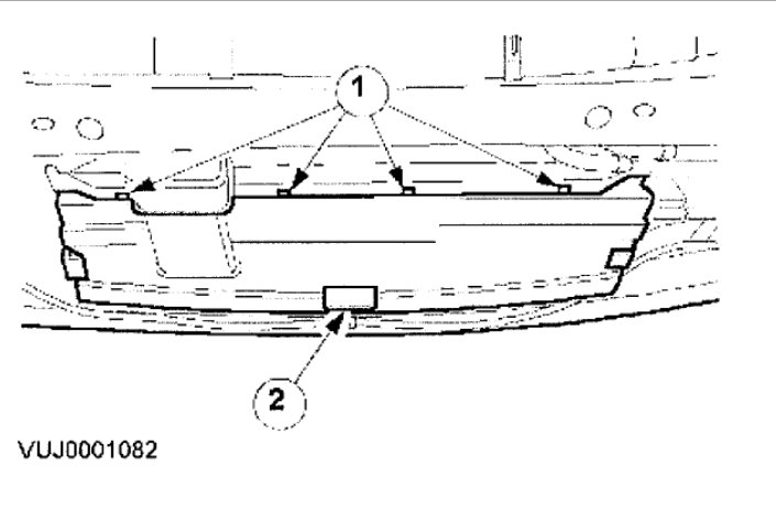

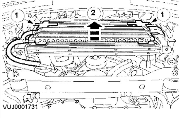

Yep it looks like you will need to drain the air conditioner and recharge it when completed. Here are some guides for that.
Coolant has a stronger smell when it is hotter, that is probably why you smell it.
Here are the diagrams you need to get going on the repair (below)
Let us know
JPMAC
Hey,
Thank you. I will do the work it and see if it is working properly. Thanks again for your time. I love this site!
