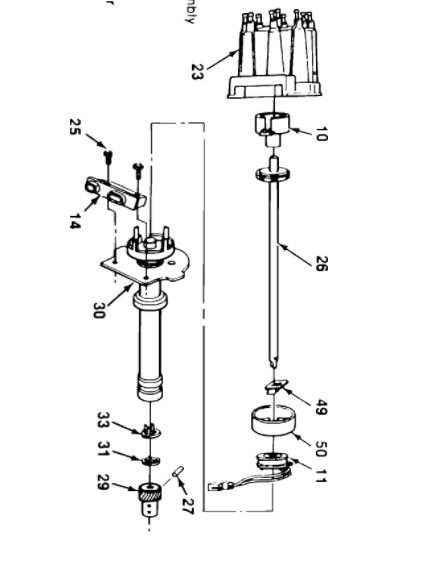

Okay, if you remove the distributor cap and rotor, the module is there that you replaced. One of the connectors goes to a pole piece in the distributor. Remove the wires from the module and use an ohm meter to test for resistance. It should read 800-1100 ohms.
Lets do that first. It sounds like that is your failure.

To replace the pickup coil, you will need to remove the distributor, remove the pin holding the gear on the bottom of the shaft and remove the gear. Once that is off, the shaft lifts off the distributor and you can remove the coil.
Most parts houses stock this piece,

I do not know how to pull the distributor or change the pickup coil.
Sunday, March 4th, 2018 AT 1:32 PM
  • 52,797 POSTS
Number 11 in the picture is the pick up coil.
Instructions below
REMOVAL:
1. Disconnect the negative battery terminal.
2. Disconnect the wiring connectors at the side of the distributor cap.
3. Remove the distributor cap and move it out of the way.
A. Scribe a mark on the engine in line with the rotor.
B. Note the position of the distributor housing in relation to the engine.
4. Remove the distributor hold-down nut and clamp.
5. Remove the distributor.
INSTALLATION:
NOTE:
a. To ensure correct timing of the distributor, the distributor must be installed with the rotor correctly positioned as noted. If the engine was accidentally cranked after the distributor was removed, the following procedure can be used for installing.
A. Remove the number 1 spark plug.
B. Place finger over the number 1 spark plug hole and crank engine slowly until compression is felt.
C. Align timing mark on pulley to "0" on engine timing indicator.
D. Turn rotor to point to the 1 spark plug tower on the distributor cap.
B. If the distributor shaft will not drop down flush with the engine, it may be necessary to rotate the oil pump drive shaft to align it with the slot on the bottom of the distributor drive gear. Insert a screwdriver into the distributor hole in the engine and turn the oil pump drive shaft slightly to allow alignment.
1. Install the distributor.
2. Install the distributor hold-down clamp and retaining nut.
3. Install the distributor cap.
4. Connect the wiring harness connector at the side of the distributor cap.
5. Connect the negative battery cable.
6. Set ignition timing to specification.
