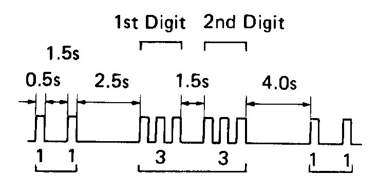

First, I need you to check for diagnostic trouble codes.
Here is a link that explains how to get them on a Toyota OBD1 system. No special tools are required other than a small jumper wire or even a paper clip.
https://www.2carpros.com/articles/toyota-trouble-code-definitions-and-code-gathering-method-1990-1995
____________________________
Once you do that, let me know what codes are found.

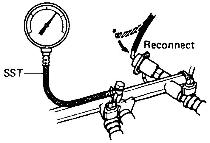

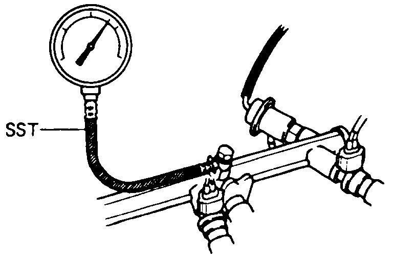

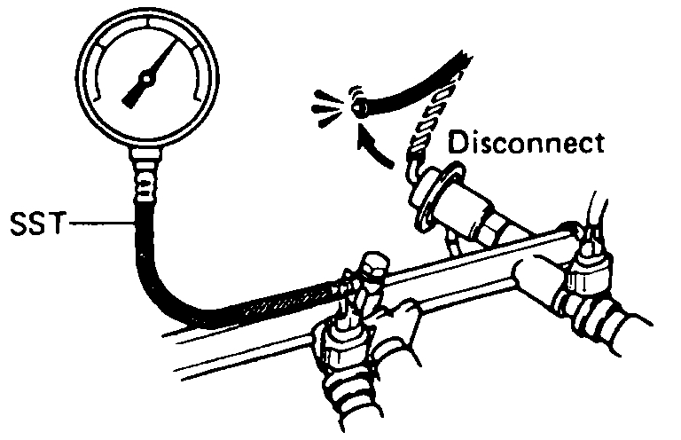

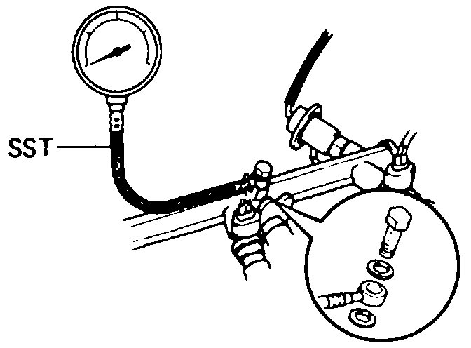

Here are the directions for testing fuel pressure specific to your vehicle. The attached pictures correlate with these directions.
FUEL PRESSURE TEST
SET-UP
1. Check that the battery voltage is above 12 volts.
2. Disconnect negative (-) terminal cable from of the battery.
pic 1

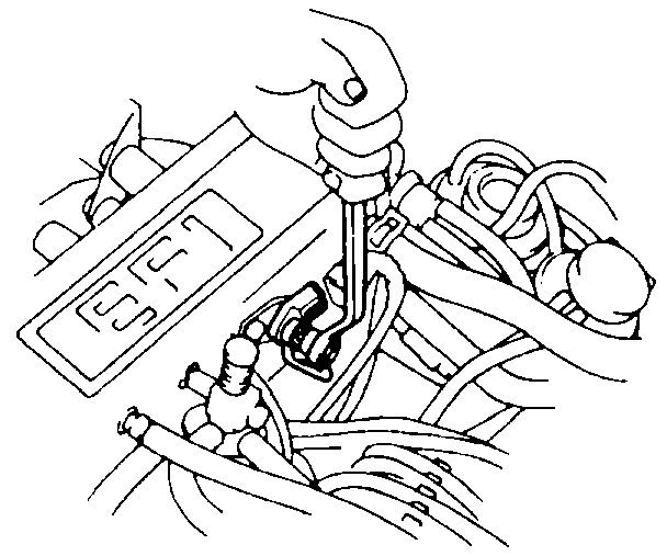

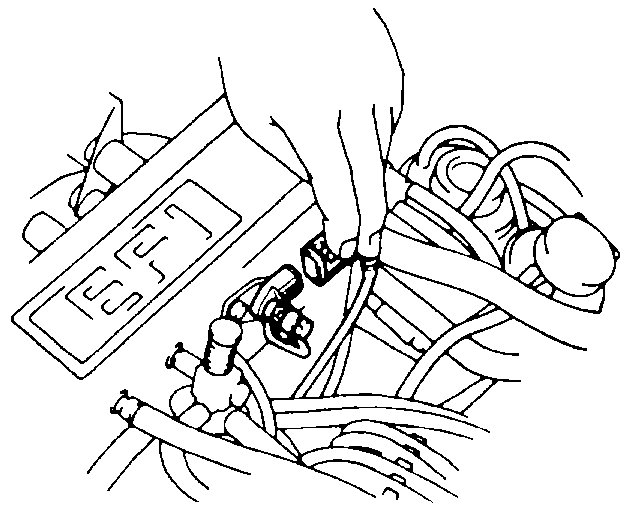

3. Disconnect the wiring connector from the cold start injector.
4. Put a suitable container or shop towel under the cold start injector pipe.
pic 2
5. Slowly loosen the union bolts of the cold start injector pipe and remove the bolts, cold start injector pipe and 4 gaskets.
6. Drain the fuel from the delivery pipe.
pic 3
7. Install a gasket, fuel pressure gauge, another gasket and union bolt to the delivery pipe (fuel rail) as shown in the illustration. (SST 09268-45012)
8. Wipe off any splattered gasoline.
9. Reconnect the negative (-) terminal cable to the battery.

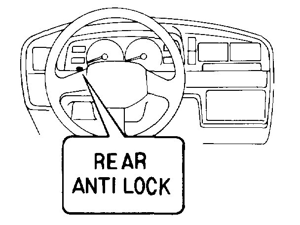

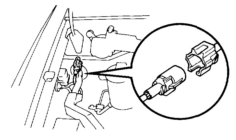

CHECK FUEL PRESSURE
pic 4

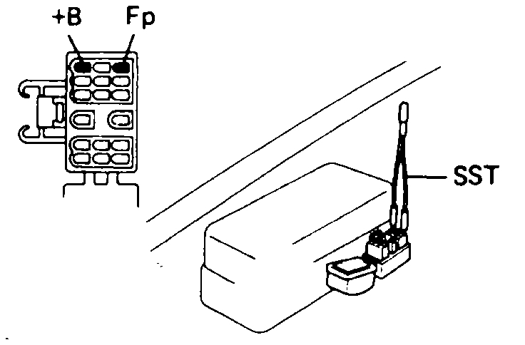

1. Using jumper, connect terminals FP and +B of the DLC1. (SST 09843-18020)
2. Turn the ignition switch ON.
pic 5
3. Measure the fuel pressure.
Fuel pressure: 265 - 304 kPa (38 - 44 psi)
If high. replace the pressure regulator.
If low, check the following parts:
^ Fuel hoses and connections
^ Fuel pump
^ Fuel filter
^ Pressure regulator

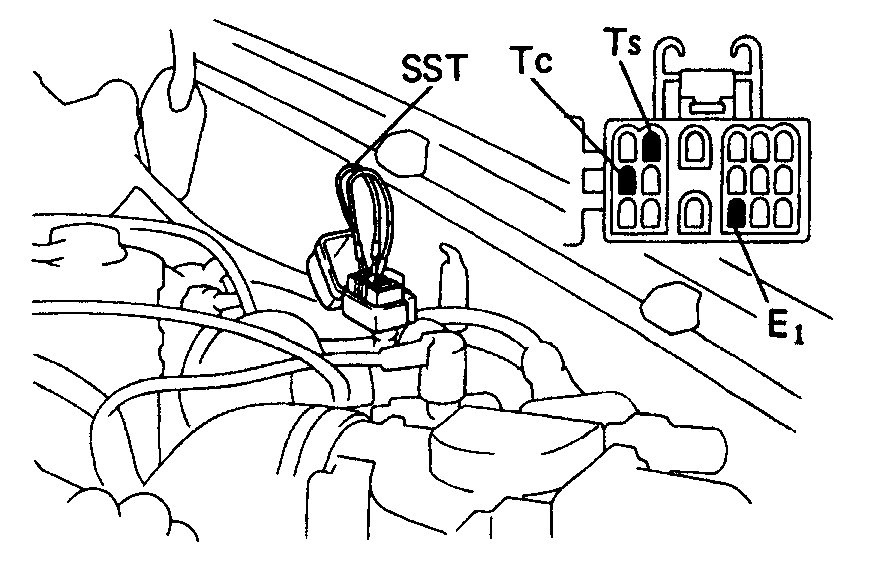

4. Remove SST from the DLC1.
5. Start the engine.
pic 6

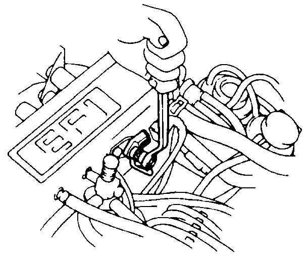

6. Disconnect the vacuum hose from the pressure regulator and plug it closed.
7. Measure the fuel pressure at idling.
pic 7

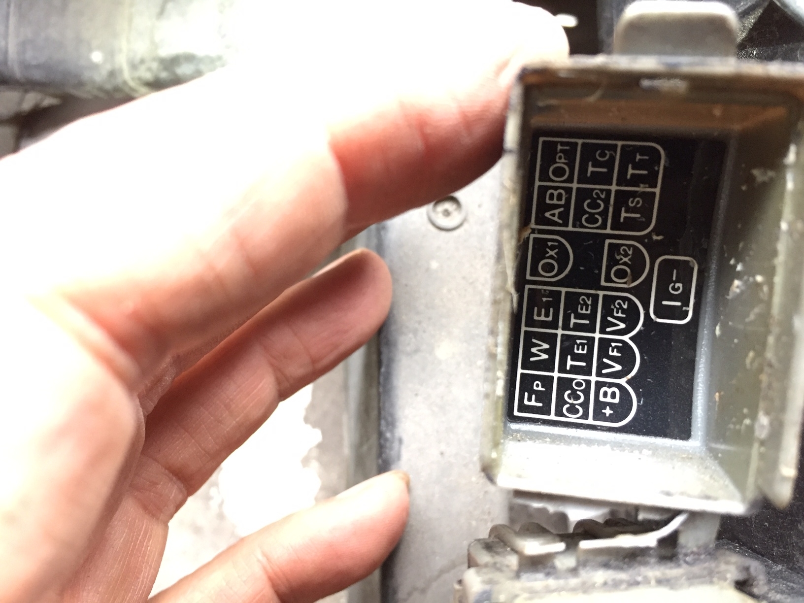

Hi Joe, started finding diagnostic codes. However, my diagnostic connector box is different from the linked website picture. The instruction asks to look fro the "Toyota OBD1" by "Using a jumper wire to connect the TE1 and T1 terminals" for my pickup. Please see the picture of my pickup's box attached. It has TE1, but not T1. It has instead, Tc, Ts and Tt. Which one or any other one shall I use? Thanks.
My pickup runs smoothly after I jam the gas petal for a few minutes, when the pickup starts warm and starts to choke. It will sputter a little. But once it pushes the fuel through, it runs smoothly for as long as I've been driving, as long as the pickup is not turned off and starts again. Does not choke any more while the pickup keeps running. Does that mean the gas pump and the fuel delivery system can be okay?
I remember I had the similar problem about two years ago. Sent to a local mechanic, who diagnosed it as an oxygen sensor on the exhaust was faulty. Replaced it. I noticed he cranked up the idle speed quite a lot. The pickup ran well since then and until about three weeks ago.
Do you think it is possible another sensor was the problem?
Thanks again.

I read online for the 1993 pickup or 4runner, which I vin number says it is, the jump wire should connect +B to fP. Is this right? Is it risky if I connect them wrong? Thanks.
May 18, 2019 at 5:40 PM
JINGYUGU
  • 5 POSTS
I jumper wire connected my diagnostic box's +B and fP, the engine check light stays on steadily, no blinking. It gives constant steady blinking, never stops, when I jumper wire connected TE1 with E1.
I cannot find description on this kind of reading. What do you think:?
Thanks.
May 18, 2019 at 6:44 PM
  • 110,194 POSTS
Welcome back:
TE1 and E1 are correct. If there aren't any codes, the light will continue to flash two times in a series off and constantly continue.
